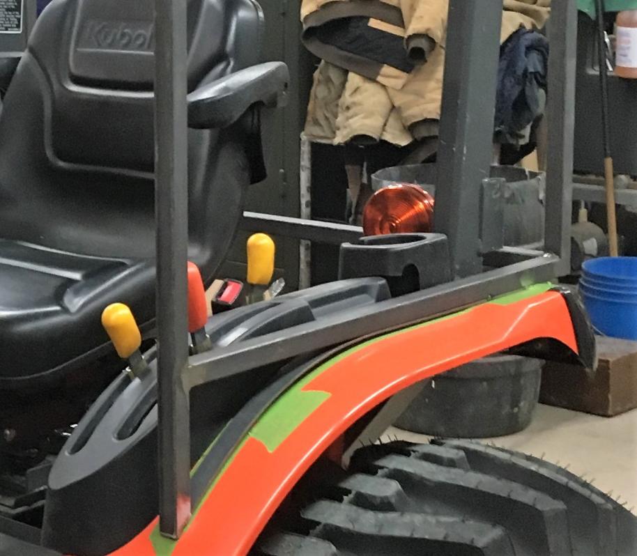

As usual, the hardest and more time consuming part is figuring out what to do. Once the front mounting points were established the rest started to fall into place quickly. In wanting to meet the goal of “easy on” & “easy off” I decided to build the cab in three separate pieces: rear half, front half, and roof. An acceptable “door width” and practical division point was picked as the separation point of the two halves. This point was near the front of the fender mounted control levers.
I wanted the cab to follow the lines of the tractor on its lower edge and be sealed to it as much as was practically possible. I don’t have a picture of this but it was accomplished by hand forming a piece of 1” flat bar to rest on and follow the curve of the fenders. It was cut to length and started just forward of the rear “plastic” light fixture and extended along the fender to the “separation” point. This piece was then later welded to the bottom edge of the cab framework. Same goes for the lower portion of the door and the front half of the right hand cab frame. You can see 0ne of the pieces (identical on both sides) welded in place already in this pic. IMG_1652 (2).jpg
I calculated my framework dimensions to allow for the tiniest gap between the final framework and the tractor’s fenders which would be made up by the seal material. (I found that the seal used in mounting pickup toppers to the box worked perfectly when trimmed to fit.) Here’s a pic of the framework being welded together:

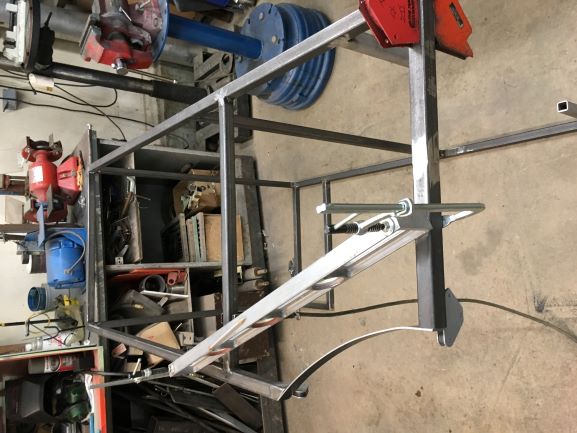

I welded a few pieces of flat stock to each half’s framework so that the two halves could be bolted together when installed on the tractor. Additionally, a couple of “tabs” were welded to the inside of the top rear half to index it in place when it rested on the alternate roll bar top. Some flat stock tabs welded to the lower front framework provided the means to bolt the front down to the loader post brackets mentioned earlier. Here’s pics of those tabs and the two halves bolted together:
Since the front half would sit just forward of the dashboard console and actually just over the rear edge of the hood, the window frame had to allow a little space for the hood to open without hitting said framework. Filling in this gap between the hood and cab framework was done with a custom cut piece of dense upholstery foam. It seals the gap perfectly and goes in and out in seconds when the hood needs to be opened up.

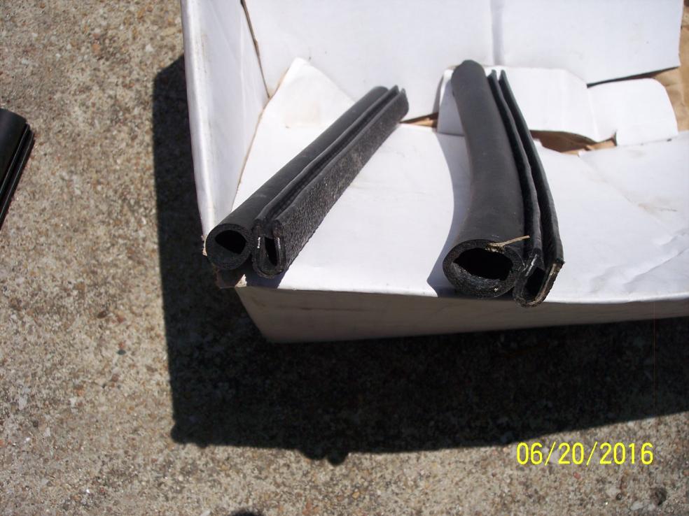

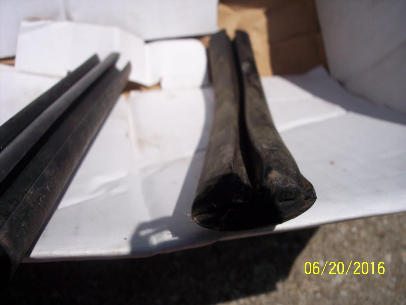

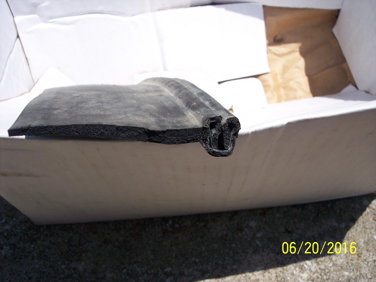

For you guys building cabs, I have an assortment of weatherstripping that may help seal your projects. Here's some pictures.

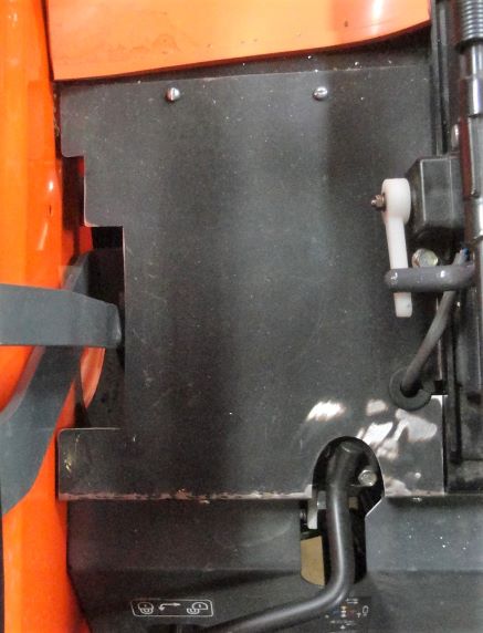

The lower areas of the framework were enclosed with some light gauge metal I scrounged from some old metal cabinet door skins. In order to lift the cab halves on and off some handles were made and welded to the corners as seen in some of these pics.

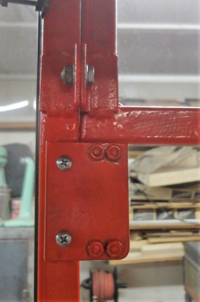

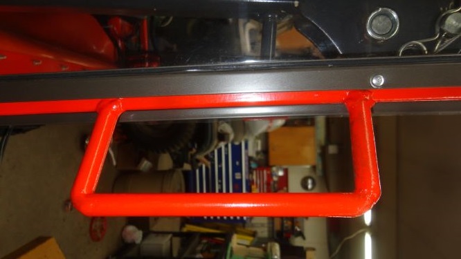

I found out a door “bumper” was needed when the first time I parked the tractor outside a little breath of wind opened the door against the front lifting handle and put a small dent in the door window frame. Darn…Its first dent. Oh, well. It happens.

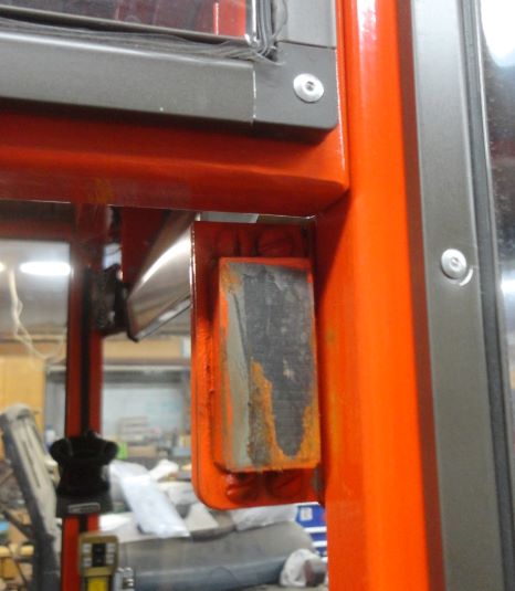

For a door latch, a magnet was installed in the top corner of the framework and also a little door hasp was bolted on to the inside of the door itself to prevent accidental opening when the operator is inside.

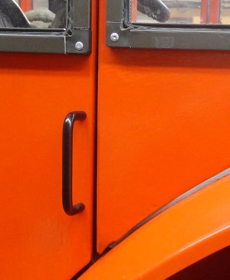

A couple of handles added inside and out make the door easy to grab also.
That's a nice assortment of weatherstripping to keep in mind for future projects. Thanks for looking and commenting!

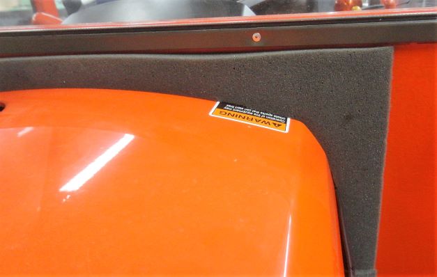

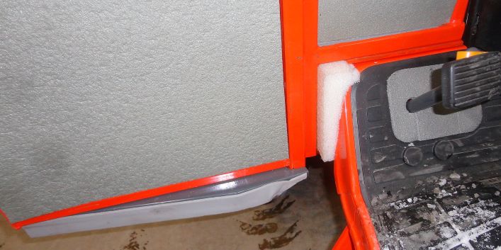

Filling in the gaps in the framework. I found a piece of a rubber insulating blanket that just happened to be orange. After cutting it to fit it was bolted into and under the rear window ledge and it has satisfactorily sealed off the back of the tractor while allowing the three point lift arms to function as needed. The orange color was an unintended bonus. Any thin sheet of rubber neoprene or similar material would work just as well. On my old cab I used a piece of carpet.....a little crude....but worked just as well. A couple of light gauge custom cut metal plates bolted under the seat area helped seal off more of the area around the control levers on each side.

. By the floor boards (on the door bottom and right side bottom) a little metal plate cut to fit was added and the same sealing material was applied to the parts. Two last pieces of foam cut to fit sealed off the openings where the floorboard curved inward and upward at the front on each side. Here’s some pics of those areas.

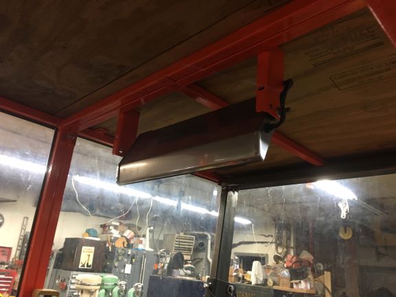

An outside truck mirror mounted horizontally and allowed to tilt at the inside roof of the cab allows me to see the whole back end of the three point snowblower so that I can blow snow traveling in reverse without turning around or putting any strain on the neck. Its also great for watching for anyone approaching from the rear when you’re moving forward. Great for keeping an eye on traffic if you’re out at the end of your driveway. The cool part is when you’re backing up and blowing snow in reverse and watching the blower in the mirror…..if you need the blower to move to the left or right to follow your path….you turn the steering wheel in the same direction as you want the blower to move. Works perfect and is just as natural as driving forward looking out the front window!

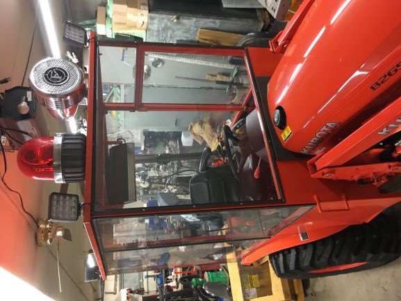

Since the tractor as is uses a dynamo for charging I changed out all the original light bulbs for led bulbs. Adding the additional led lights to the top of the cab and using the electric chute controls have been no problems for the dynamo to keep up. Two little muffin fans circulate the air inside the cab and its just enough to keep the windows from fogging up on all but the coldest days. (and at this location…..cold means a temperature of -20 degrees F. or colder). I think a cab heater might be a necessity in the near future! The controls for the added lights, fans and dome light are fed off the rear cigarette lighter charging port. The power for the snowblower chute controls are fed from the rear power leads. All hookups properly fused, of course. Cheap cell phone holder from Menards.

I was going to add this Federal Signal deer whistle and tiny rotating beacon but thought it might be too much bling! Plus, it would've been extra hard to run the current carrying welding cable necessary for operation within the square tubingand it wouldn't have fit under the door header.
