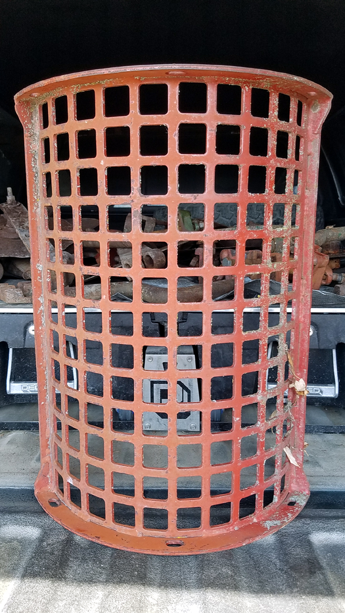

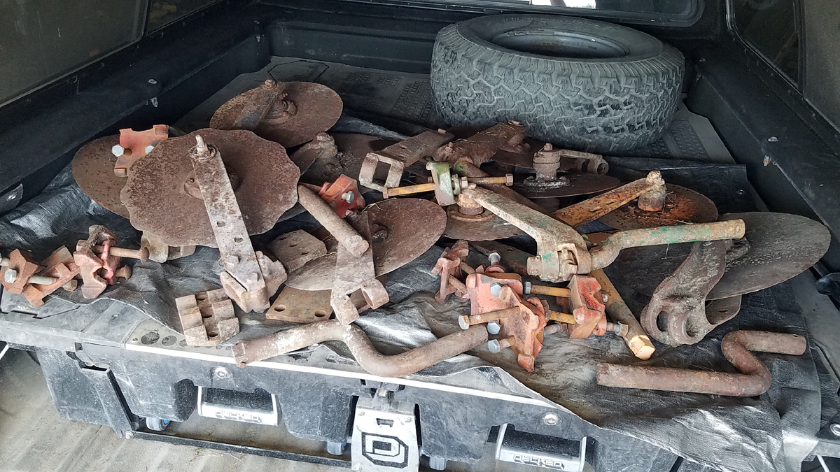

I went back to the tractor "graveyard" this morning, the place where I bought the John Deere 825A plow, and spent a couple of hours looking around for coulters and brackets. I ended buying all of the parts shown below which includes 11 coulters and 9 brackets and a cool steel guard of some sort that might end up on one of the tractors after some work.
I paid $320 for everything shown, and once again got to stare into the most chocolate brown eyes I've ever seen. The woman that runs the place is a Montana grown honey bunny! I need to spend a day there at least. They have so much stuff strewn about the place, a real gold mine!

I bet you will have to go back to pick up what you did not have room for…😉

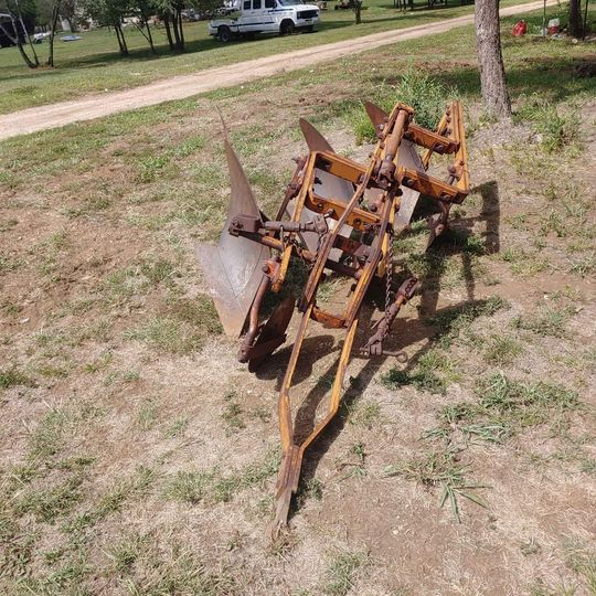

Here's a simpler plow and a simpler price!
Plow
$350
Listed 11 hours ago in La Cygne, KS
Details
  • Condition
    Used - Good
Old 3 row plow in good condition. 350 obo.

Every market is different, and if that plow were available up here I would look at it for parts only since I wanted a 3-point turnover plow. Given the size, quality and features of the JD F835 I'm very much ok with the $2k I had to pay. Just think about that Kuhn that's $28k. Is it going to do a 14x times better job?

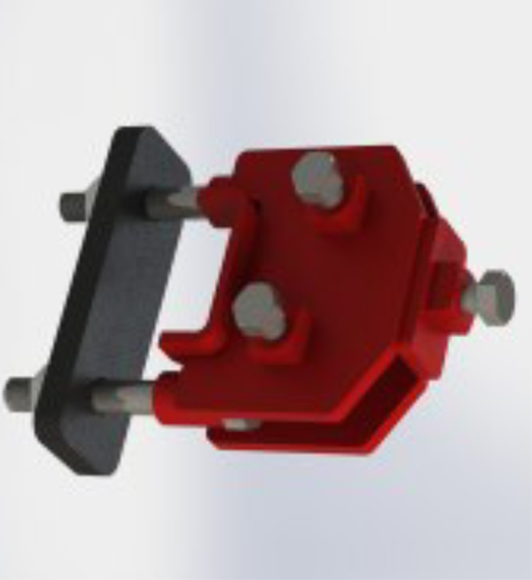

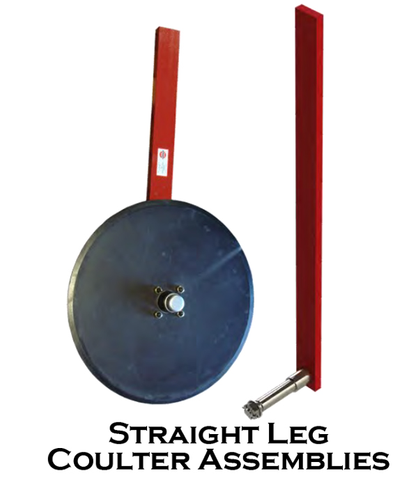

I've got a plan now. I'm going to modernize the JD F835 by adding six new coulters and brackets of the type found on modern tillage equipment. I'm going to use the coulters and brackets currently on the F835 in combination with the coulters that I bought from the salvage yard to "restore" the JD 825A to its original glory. Once restored I'll either use or sell the 825A, but I'll certainly be keeping the F835 indefinitely and will be using it this Fall to plow a friend's 10+ acre field.
I've ordered the six coulter assemblies with mounting brackets shown below (should be here in a couple of weeks or less) and will fabricate plates to adapt the new brackets to the F835. I settled on 16" smooth coulters with 3"x1" straight legs. I like these assemblies since they use commonly available coulter blades, spindles and bearings, so servicing or replacing damaged parts isn't a challenge.
In addition, I've become a distributor for the manufacturer of the parts shown below given the piss poor "service" I received from a local tractor supply company listed as a dealer for this manufacturer. If you want something done right, do it yourself!!

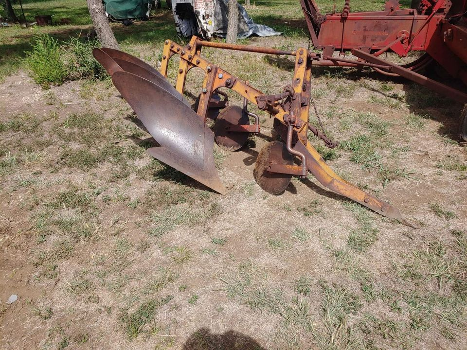

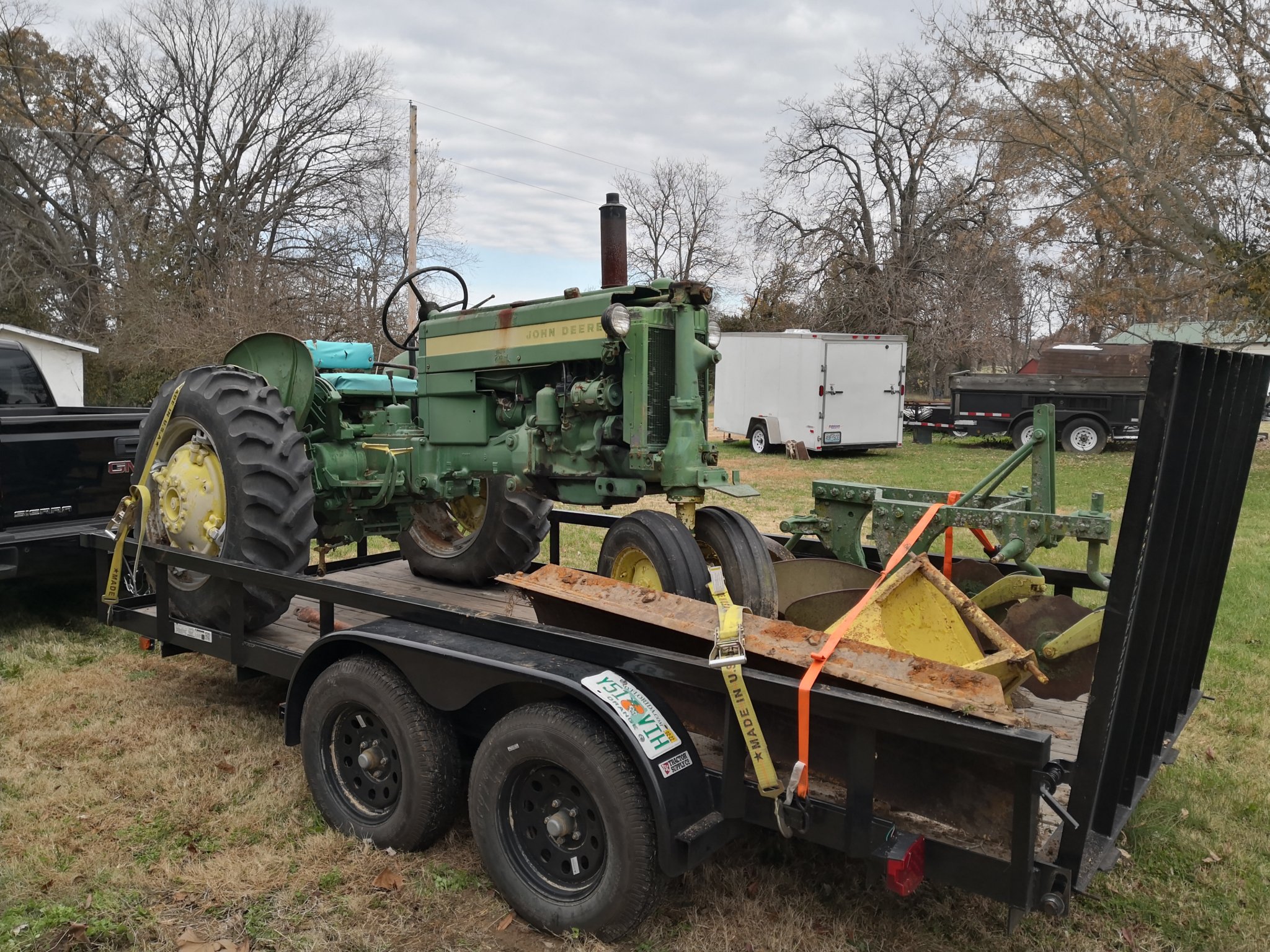

Thought I'd share my 2 bottom plow. Its a JD and was bought with this tractor new in 1959 by my grandfather.
Plow
$350
Details
  • Condition
    Used - Good
Plow in your photo would be simpler if you have access to the brand/model tractor that it was designed to fit. If you don't have access to correct tractor then this same plow gets very complicated to attach/operate to a tractor
Those look like they will bend easily in use. Either when you hit a rock or root, or when not plowing perfectly straight. They look cheap knockoffs compared to what is used on most plows.
Tx Jim
M7040 HDC & JD 4255
Apr 30, 2013
1,254
161
Coyote Flats,Texas
Ditto I'd choose the factory swivel mounted coulters over the aftermarket rigid mounted coulters
6,771
9,144
I've seen plenty of coulter shanks used on "most" plows that have been welded and rewelded, and many that are severely bent. I have both welded and bent shanks on the the F835 so I'm ok with trying these modern variants. The ones I ordered have 3"x1" flat bar legs/shanks oriented in the direction with the larger I value, but if they bend or break I'll repair them. I'm not afraid of trying new things and fixing problems when they show up. I like learning so I'll invest in that and deal with the aftermath.

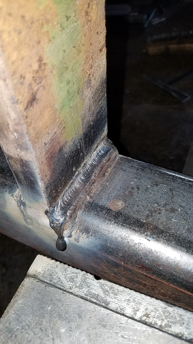

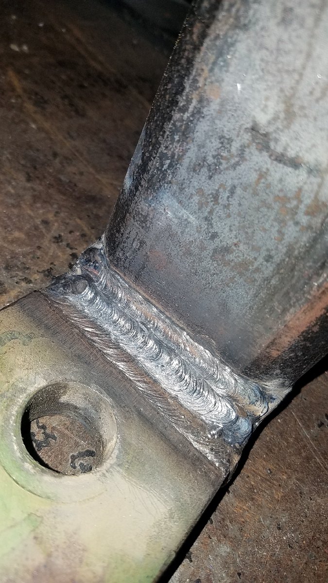

I've started to upgrade the JD F835 to accept modern coulters. I bought a stick of 3"x3"x3/8" tubing and modified some of the existing 3/4" flat bar to add sections of square tubing to the plow that bolt on just like the original supports. The company I bought the coulters from does sell much more expensive variants that are spring loaded so I've decided to modify the ones I have so that they'll be spring loaded too. If I can figure out a way to make them pivot I will, but for now I'm just going with springs.
Here are some photos of the process using a Hougen magnetic drill, DeWalt chop saw with steel blade, and a Lincoln Square Wave TIG 200 welder with 1/8" 7018 rods.
