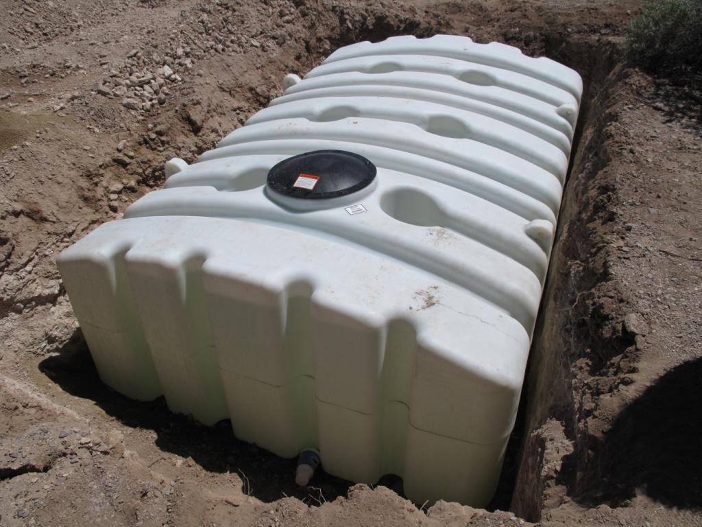

This is the tank. 1500 or 2500 gal, I forget.
Our grade tanks sit about two feet under ground.

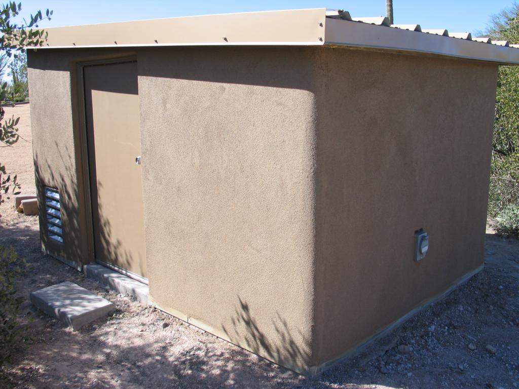

I built a shack to protect the equipment. The boss ordered that it "shall not be visible from the street" so I hid it in bushes and made it shorter than 6' tall. Rather than spend big bucks ordering a custom door, I made one out of a solid core blank and made my own frame and hung it. The roof is from a metal place here in town. I vented it and it stays pretty cool in all but the hottest of summer. Never gets above 105F and it keeps the equipment out of the pesky UV rays and direct solar heating. Most people around here leave everything out in the open and wonder why the bits go bad.

That's interesting. Very similar to a spring system here.
While some are pumped, most are gravity-fed to a tank inside (cellar), and are then pumped into the house/barn system. Same net-effect.
