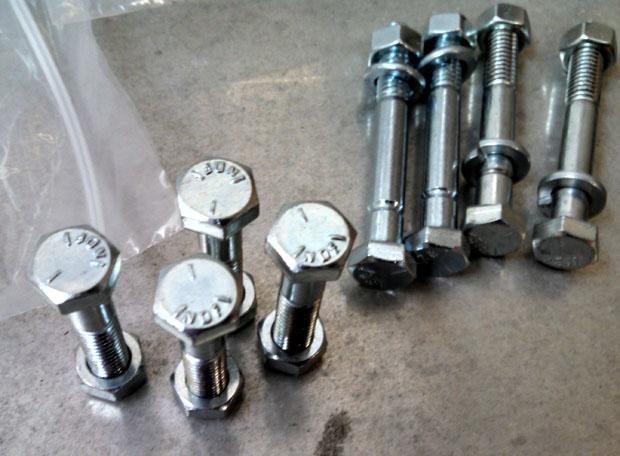

The cuts you see in the bolts are not "to weaken them" it's to provide a clean break that prevents a portion from getting bent out of shape and wedged in the slot.
Yes and no. You are correct that the purpose is to provide a shear line where they will break. The reason they will break there is because that is the weakest point. A grooved bolt is no stronger than a bolt of the groove's diameter, but an ungrooved bolt is stronger than a grooved bolt of the same diameter.
So, for example, if the manufacturer determined that a 1/4" Gr.5 bolt was required, the manufacturer could safely utilize 5/16" Gr. 5 bolts grooved to 1/4" to control the shear line location. However, if someone was to subsequently replace those with ungrooved 5/16" Gr.5 bolts then the force required to shear the bolt would be higher and could lead to damage elsewhere.
This is true, but only to the extent if the shear force is applied over the groove. For example if a bolt is placed in double-shear (imagine placing a bolt across the end of two boards, spaced one inch apart, and then trying to force a 3rd board through the bolt, down between the other two). If the groove is outside of where the shear force is being applied, it will not weaken the bolt.

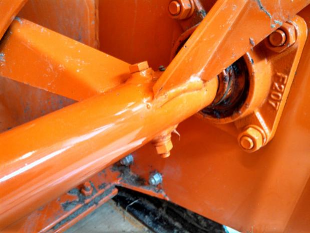

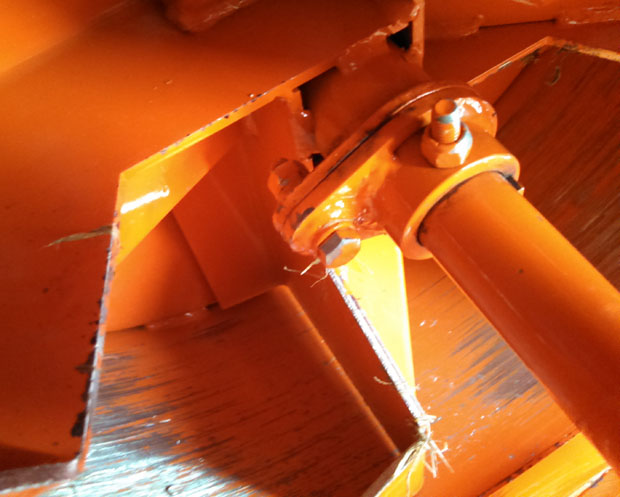

Would you mind posting a picture of the fan shear bolt area on your machine which has been trouble free. If we assemble a number of images of trouble free designs, those owners with problems will know where they need to alter their machines to start having your experience.
Dave M7040
I have the Kubota B2782B 63" snowblower, manual for serial no. 21503940 and up. It is different from the one in your picture. It calls for the fan shear bolt to be grade 5, part no. 70060-00726, 5/16 NC X 1 1/2 gr. 5 and lock and nut. The long shear bolt s for the augers are also grade 5. The ones in the blower are covered with orange paint but I think they also have the 3 lines on the head to designate grade 5. All of the dealer supplied fan shear bolts are grade 5.
As far as mine being a good example of trouble free, it is, but we have only had 3 snowstorms of 6-10 inches, that were worth getting it out to snow blow, and I was pretty careful with it because replacing a shear bolt would be difficult for me.
I'll add photos shortly.
True, we have been assuming the grooves are aligned with the shaft/collar interface. If the grooves are in the wrong spot then it won't adequately limit the forces just as if there were no grooves.
It's tough to tell and way to cold to sit out there with caliper but I backed off the nut and it appears that the slot sits just inside the inner shaft. That makes sense because you want to maintain the bolt strength while insuring the inner section has a clean break point at the intersection of the two parts.
If it was aligned in the middle of the two assemblies then the worst that would happen is it would break at a lower force. Not great but it sure beats the alternative!

Just looking at the spare bolts and the auger shear bolts in place, it looks like the groove is as you say, at the junction. See pics added above.
The fan shear bolt has an ungrooved unthreaded section and a threaded section and it is less clear where that junction lies, but close to where those flanges would slide. Am slowly catching on to this discussion. :)
You are correct. The other thing to remember is that these grooves are located exactly where the shear occurs, between the two planes of shear. That is, they are located at the point where the two rotating metal rods/shafts intersect.
Both my GR8 and GR5 shear bolts for my BX2750D are grooved down to approximately 0.26" and 0.23" respectively (close to 1/4") on 5/16" bolts. The shear strength is approximately 60% of the tensile strength of the cross section of the bolt where it shears.
And, like others have said, the shearing itself deforms some of the metal sideways, and having the grooves allows the deformation room to happen without exceeding the actual hole width. That is, the 5/16" bolt with a 1/4" area at the grove will shear sideways and still keep the sheared material within the 5/16" area so one can punch out the bolt without too much effort. It's all engineered this way on purpose.
I've measured the GR8 bolts in my BX2750D fan, and the thread itself is located at a shear point, but "just" for a 2-1/4" bolt. That is another reason they use 2-1/4" bolts. The inside diameter (narrowest point) of the thread is close to the same as the groove near the head, about 0.26". Thus, the thread itself provides the same effect as a necked down bolt for shearing purposes. The GR5 bolts are still machined down because the groove is about 0.23", and the thread narrowest point is probably closer to 1/4" or even 0.26" like the GR8 bolts. Seems the design of the GR5 auger bolts requires a bit less cross section area, hence they are grooved at the thread end as well to match.
Other shear bolts may rely on the threaded portion to provide the proper shear point thickness.
PS: All measurements are approximately what I remember, give or take a bit. The issue is, the narrowed down areas are different between the Gr8 and Gr5 bolts, and I'm sure are different for other shear bolts for other equipment. One can make their own shear bolts if you narrow down the same size and grade bolts at the same locations and at the same depth. The groove can be a bit wider, but should not be too narrow...
