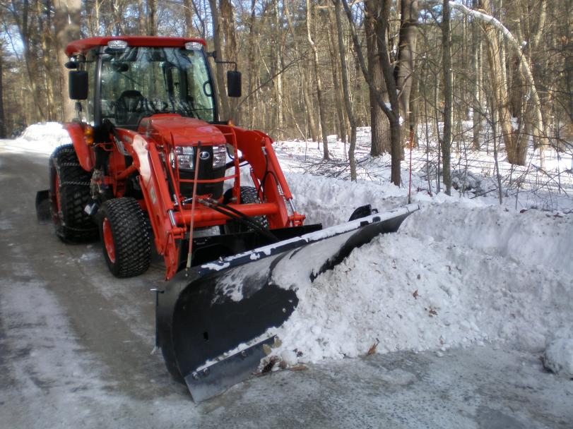

I took the plunge and installed the kit. It was an all day project but with the PDF installation document the job went fairly well. I did have a real time getting the crossover tube fittings under the seat loosened. With the seat tilted up, standing in the cab with one foot on one wrench and pulling with all my strength, the fittings finally popped loose. The good thing... no busted knuckles!
I had to go to the local dealer for some reducer fittings to connect the quick disconnect couplers for my 8' QuickAttach plow. I had a 50/50 chance at guessing which fitting, male or female, went where... and I missed my guess. The articulation side to side is opposite what I expected, but I left the fitting as initially assembled. Perhaps I will swap them in the future, but for now it all works, so I am happy.

Allmoto, I got my L3560HSTC with the 3rd function factory installed as I knew I was going to get either a plow or snowblower. I'm glad I did, and I have the quick attach plow like you have and it has worked great for the last 3 yrs.
