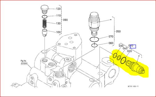

This model as well as other new models have a dial up / down pressure regulator no shims needed.
It's on top of the three point under the seat.
I think you turn the adjustment on the end in to up the pressure and out to lower the pressure.
I assume what u adjust is what's highlighted in yellow ?
Tx Jim
M7040 HDC & JD 4255
Apr 30, 2013
1,236
150
Coyote Flats,Texas
just shimming or adjusting the relief to solve the issue is the wrong way to do it, IMO. Need to find out why the psi is low.
lugbolt
May I ask what other issue you're referring to that could correct low hyd pressure other than low relief valve setting? I was taught to perform the easiest repairs 1st & checking/adjusting relief should be a simple task.
Thank you,Jim
78-79fordman
2013 m7040hd 2013 L3800HST 1969 MF135
May 21, 2013
255
Gillham Ar.
You need to read post #9 in this thread.
There are two relief valves and the one you highlighted only deals with the 3 pt and rear remotes.
The FEL has its own relief.
Dave
I read that and I figured it looks similar to the 3 pt . And I am going to check and adjust if needed both . As soon as I get a gauge .
