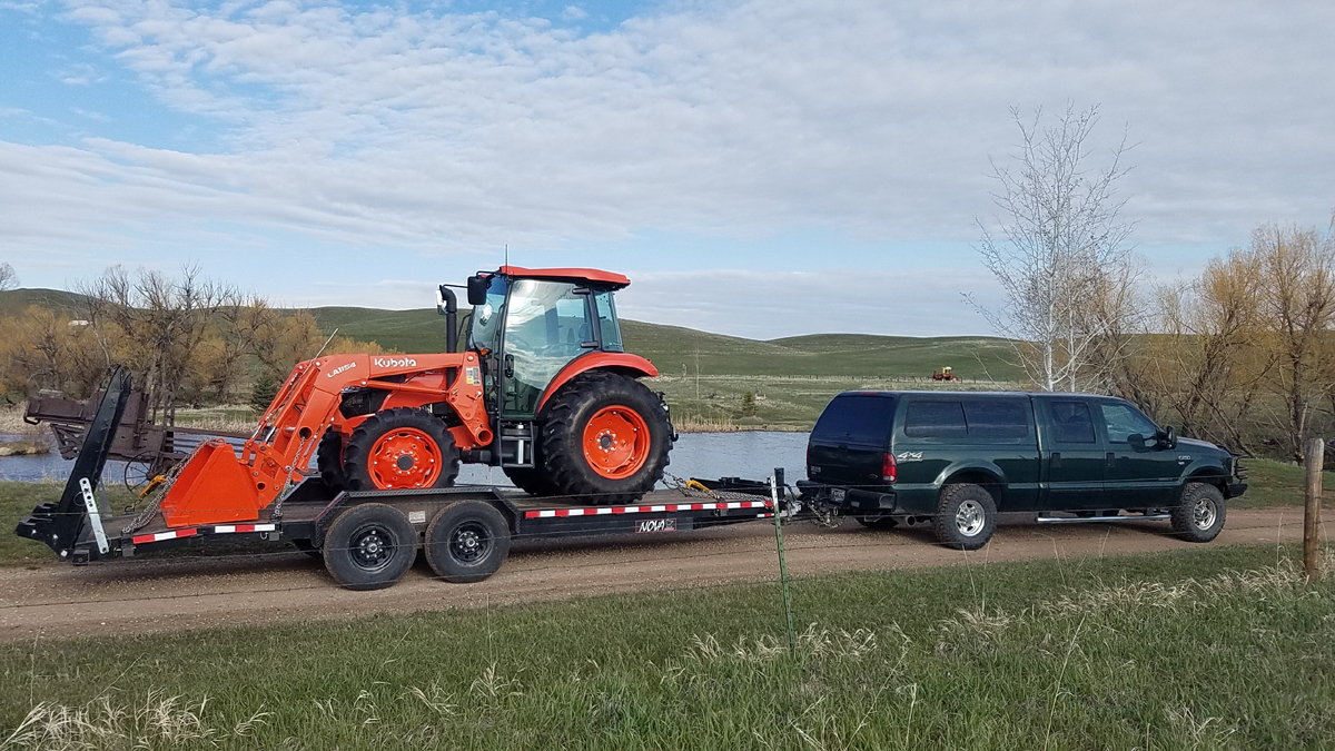

Look, if someone wants to buy me a truck capable of pulling a trailer, tractor and 12ft folding cutter coming in at close to 20,000 lb I'll happily take it regardless of who makes it, and promise not to complain about a thing. 😂
When I towed the M6060 back from Sheridan, WY I had a GCW of 19,090 lb which is around 5% under the maximum recommended GCW of 20,000 lb. The tractor as shown without liquid ballast or wheel weights was around 7,360 lb. The MidSota trailer weighed 3,360 lb which resulted in a trailer GCW of 10,720 lb. The weight of the truck on its own with me, two dogs, a SnugTop topper, a Decked draw system and a full tank of fuel was 8,370 lb which is below the GCW of 8,800lb. However, once the trailer was connected it added around 1,200lb to the weight of the truck.
The '02 F-250 is rated to tow a conventional trailer with a GCW of 12,000 lb. I pulled the trialer about 650 miles over four mountain passes including the 7% grade out of Missoula, and not to mention the 120 mile climb from Sheridan to Billings, MT. The truck did well but not great, but everything was just about maxed out, and that's with a chip and programmer. I was able to keep up with traffic, but on that 7% grade out of Missoula I was in 3rd gear, accelerator to the floor and doing 55mph which is all that the truck had. The EGT readings pre and post turbo were ok, but in that moment I wish I had more truck or a better rear end or something. This was a good test for the truck and overall it performed well.
So, now to last summer. The M6060 with the loader, wheel weights and liquid ballast weighs around 9,790 lb. With the loader off and front weights on it weighs around 9,063 lb. The folding cutter is listed at 3,730 lb in the spec sheet provided by Land Pride, but the dealer in the quote listed the approximate weight as 4,194 lb. So assuming a cutter weight of 4,000 lb, a tractor weight of 9,063 lb that's a load of 13,063 lb. A 30ft gooseneck trailer comes in around 6,930 lb so I need a truck capabale of pulling just about 20,000 lb. This falls comfortably within the rating of the 6.7L Ford trucks but certainly way outside the 12,800 lb gooseneck rating for my F-250. I would much rather have more truck than I need than less truck than I need. Rarely is running anything at the upper limit of the performance range a good experience, and running beyond that can be miserable. That folding cutter shows up as being "Kubota Matched" to the MX6000 and M6060, but I sure know which tractor I pull it with and which tractor would struggle with it.
