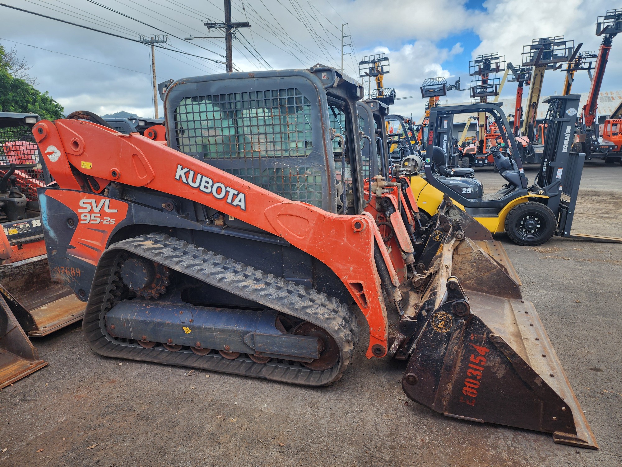

Speaking of my friend in Hawaii, he just bought a 2018 Kubota SVL-95 with 1,600 hours on it.

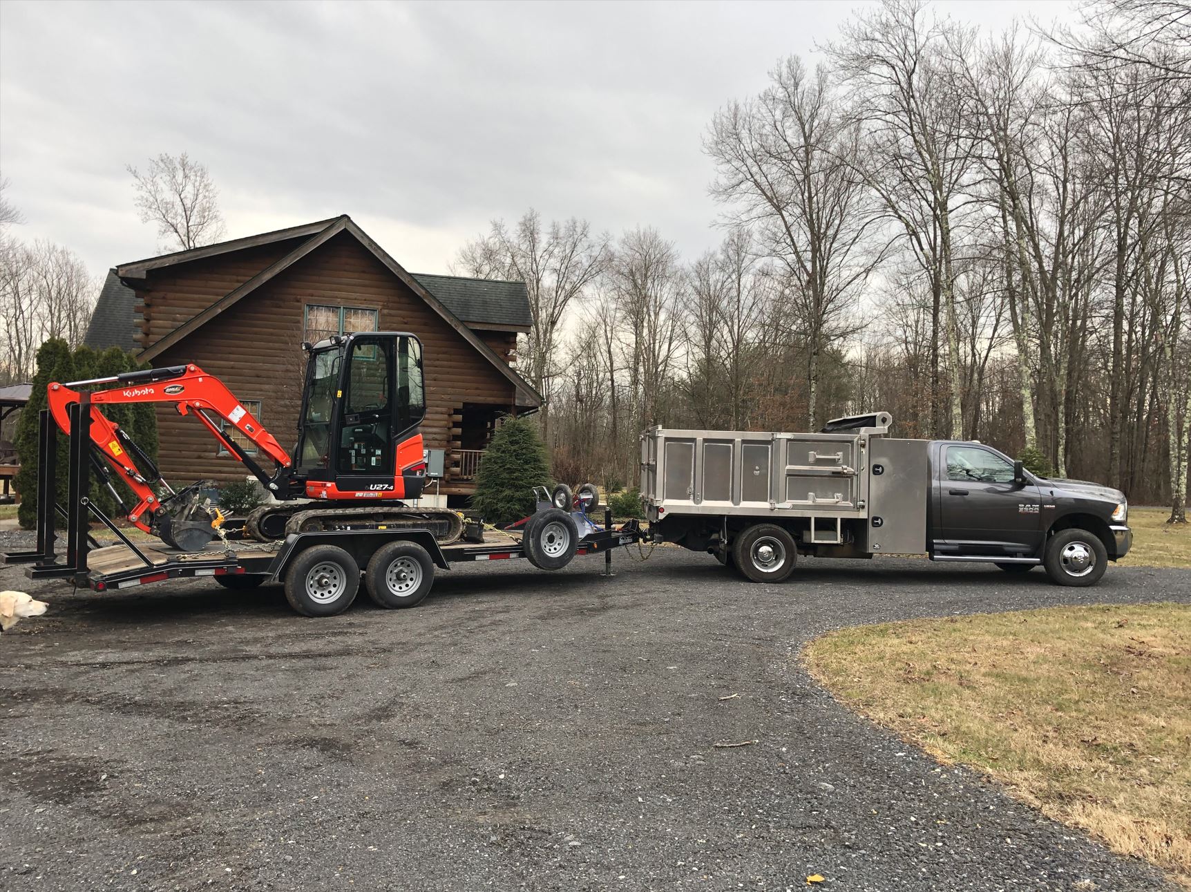

Oh, mines a dinky 2015 Ram 3500 cab/chassis 6.4 gasser aisin 6spd auto with 4.44 rear. It's just fine with anything in the dump bed (even extra heavy) but as soon as I hook a trailer to it it's pretty doggy. It does what I need it to do. Pulls like a freight train in 1st gear then promptly falls on its face in second if I'm pulling a hill from a stop.
14K GVWR, 24K GCWR
Unlaiden (but with my tools) its about 9,700 lbs. Trailer loaded with mini and extra buckets (lots of chains and binders) is just under 10K.
There's no way it would pull your stuff other than downhill and wouldn't be able to stop it either.
I did pull a bit larger machine (8.5 K) and 12K CTL with a 2020 GMC 3500 cab/chassis duramax. That pulled pretty well, but the rest of the truck sucked. Terrible driving position in GM's (IMO).
