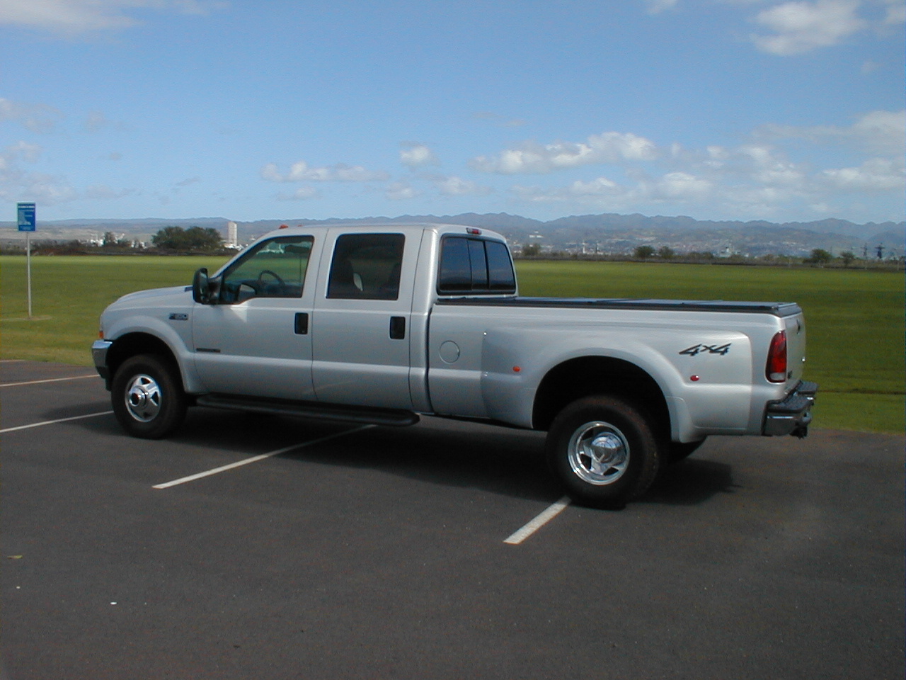

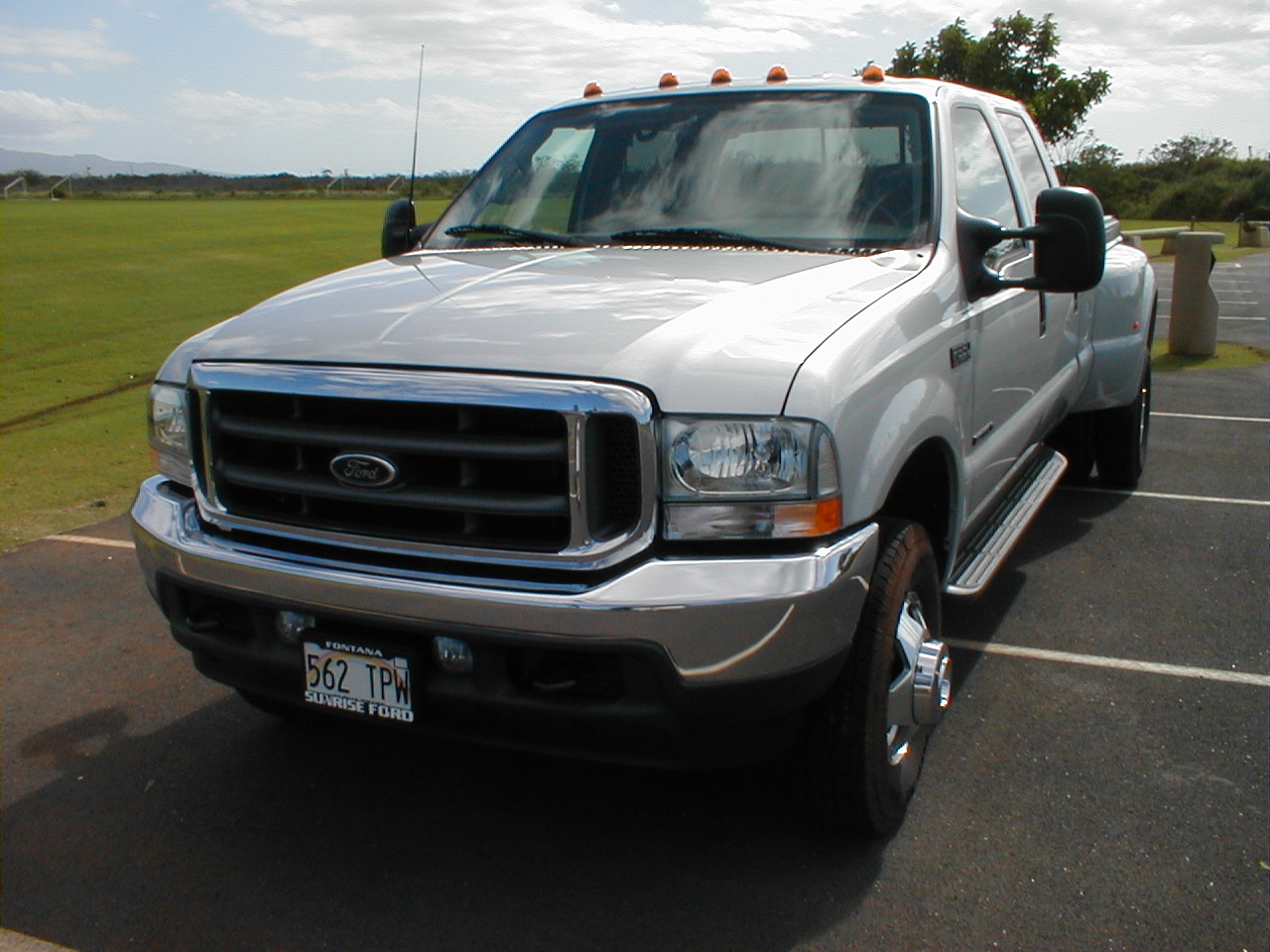

My first Super Duty had the 6-speed ZF transmission. It was an '02 F-350 XLT with an 8ft bed. I remember buying it new from a dealer in CA, and even with shipping to Hawaii it was "only" $34k. I sold it to a fisherman with a big boat two years later for the same amount. Dumb move to be honest.
