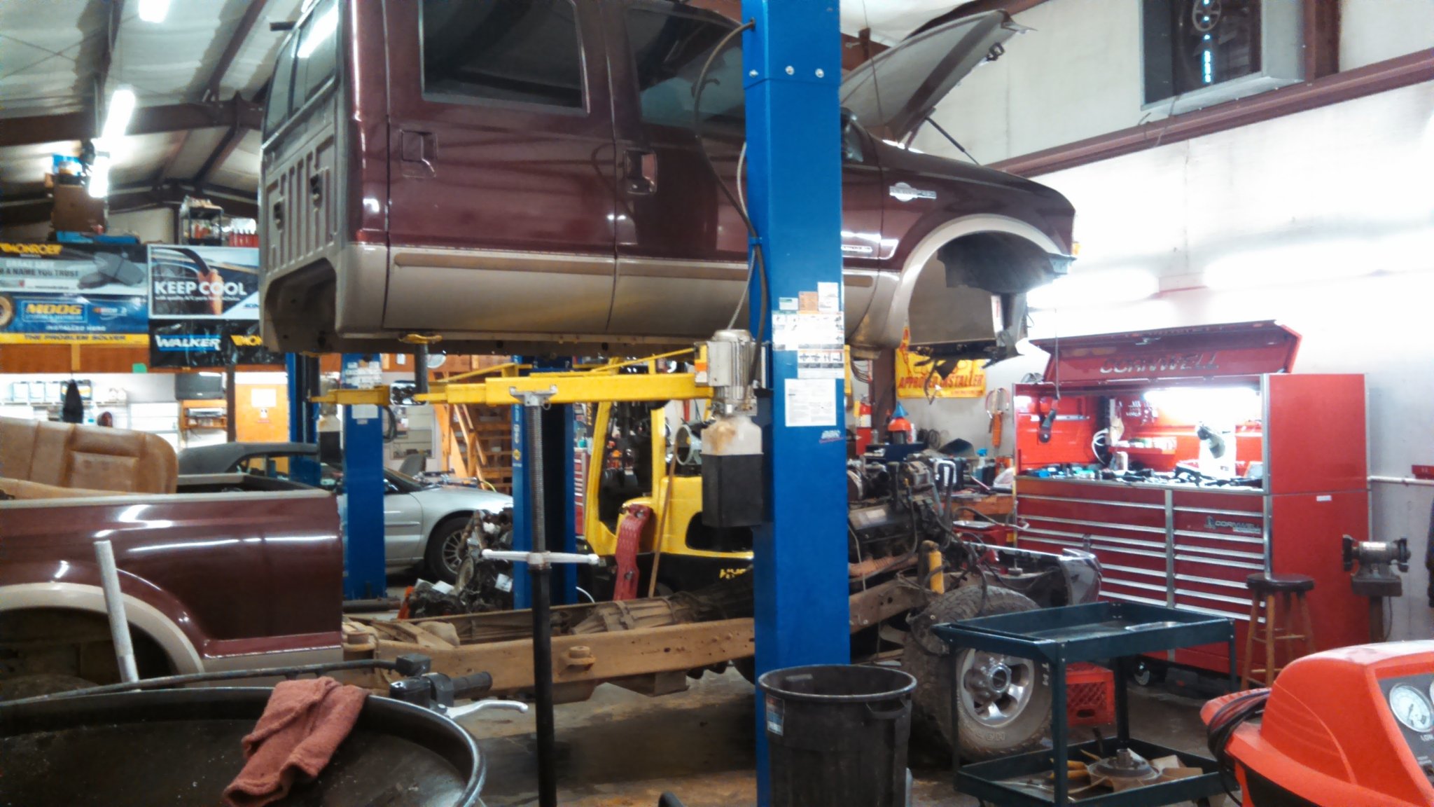

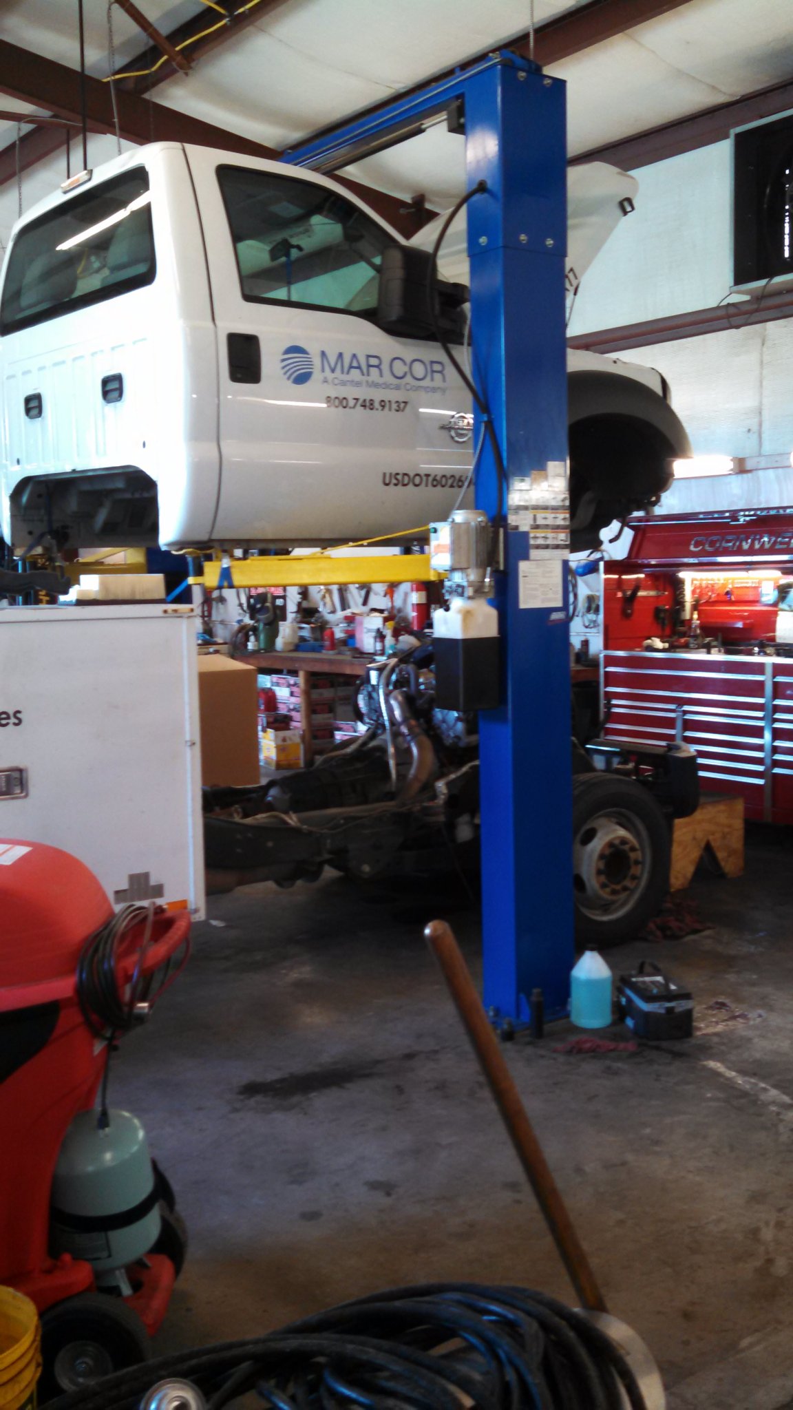

We tend to get atleast 1 fuel system a week on the 6.7 powerstrokes. Last weeks victim:
Generally, its our farm accounts that have the most problem with these. They all run aux tanks in the bed and at some point they get a spec of dirt or water or some other bs in them and shred the injection pump. When this happens, she'll put metal through everything, even alllllll the way back to the tank.

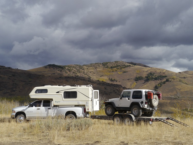

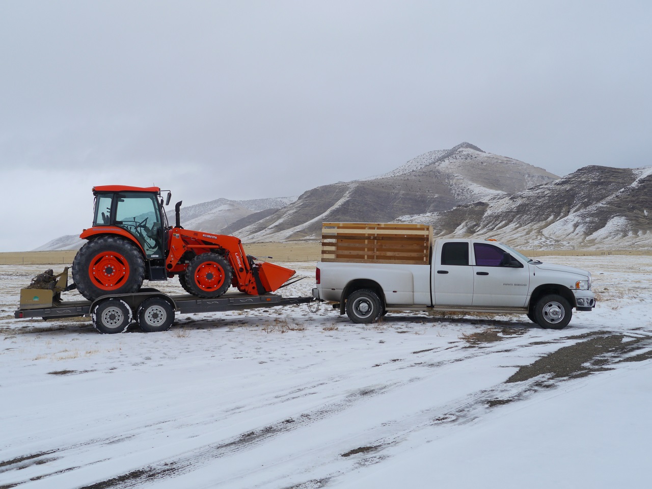

Personally, I think you'll be disappointed if you are just looking for a truck to pull a lot of weight and yet accelerate and keep up with traffic. All of the medium duty and heavy duty trucks have derated engines; they don't have the horsepower/torque of the pickup engine equivalent but will last forever. It just takes long to get all that weight up to speed. I see those heavier duty trucks holding up traffic on all our mountain passes here in Nevada. The only trucks that could pull a lot of weight and still accelerate fast enough to keep up with general traffic are purpose-built pullers like those you see at the pulling contests. 2,000+ horsepower - and the engines are good for only a few pulls!
That being said, if what you really need is a more stable towing platform then I agree with jyoutz. Find an older (preemissions) Dodge/Cummins dually with the 6 speed manual transmission, with not too many miles, that hasn't been beat up/rusted out. Pre - emissions means any of the 5.9 engines; if it has the 6.7 Cummins then it will have emissions crap on it. If you get one with the automatic transmission, you'll need to have it beefed up to handle a lot of weight and still last. Just be aware that even though these trucks are 20 years old - they are still selling for close to or as much as they sold for as new, if they have less than 200,000 miles on them. And that's because people are willing to pay those prices to not have to deal with the newer diesels with the problematic emissions.
I have a 2004 Dodge Cummins dually, 6 speed manual. ONLY repair ever done on it was to change the water pump a few years ago. It has only 78,000 miles on it but then like you, I only use it when I need to pull a load. I'll own this truck until I am too old to drive.
This load scaled at 28,000 lbs:
Hauling my M7060, or the big cabover camper with jeep, I never have to shift out of 6th gear on any of the mountain passes. That engine just PULLS...drama-free.

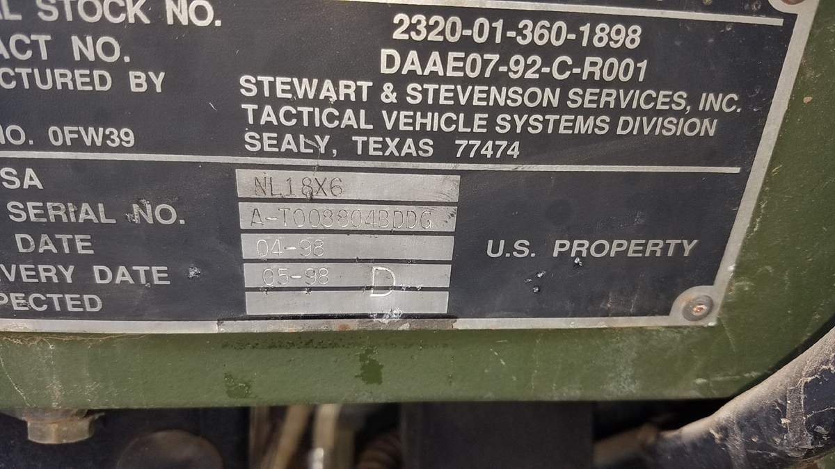

Made by Stewart & Stevenson Services, Inc. Here's the manufactures plate in the cab of my truck.

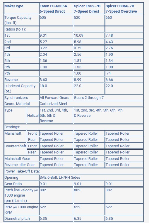

The salesman took a photo late this afternoon confirming that the F-650 has a 7-speed manual transmission. So it's a Spicer and either the ES52-7B or ES066-7B. Does this change anyone's mind either for or against?

7 speed is a nice bonus. I dont know anything about the Spicer transmission. The Eatons lost the syncros about every 60k miles on our Two 4700 International tow trucks.
