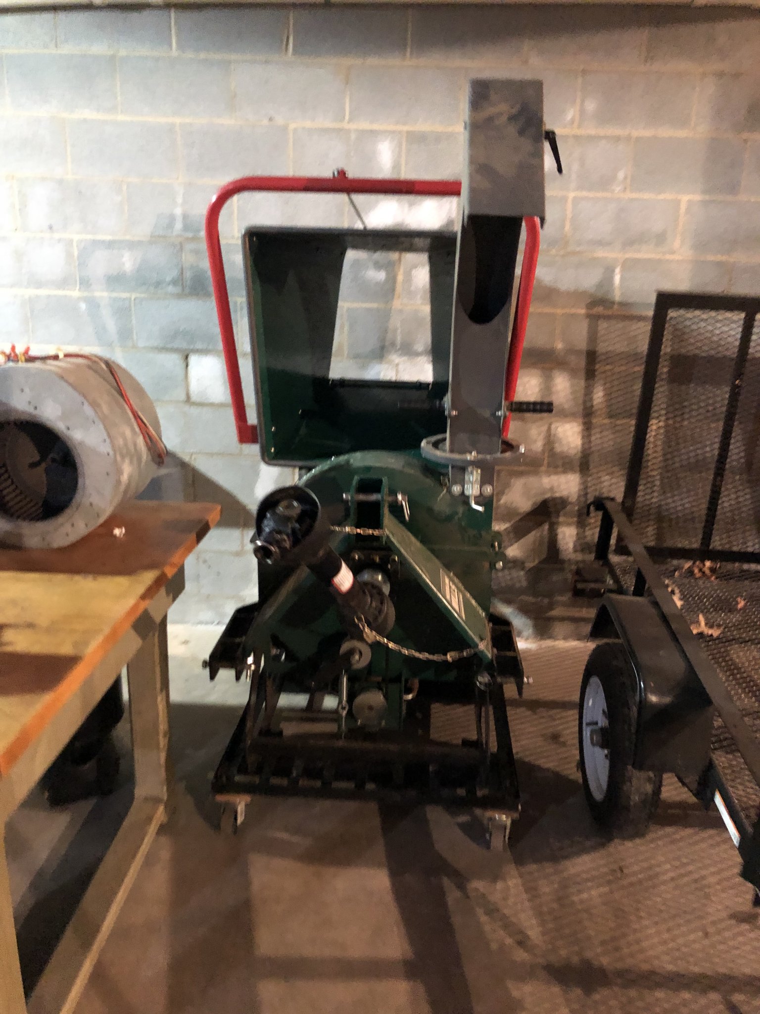

Chipper dolly was made from the metal packing crate like everybody does too. Had to reinforce it with angle iron though, that packing crate metal is chintsy.

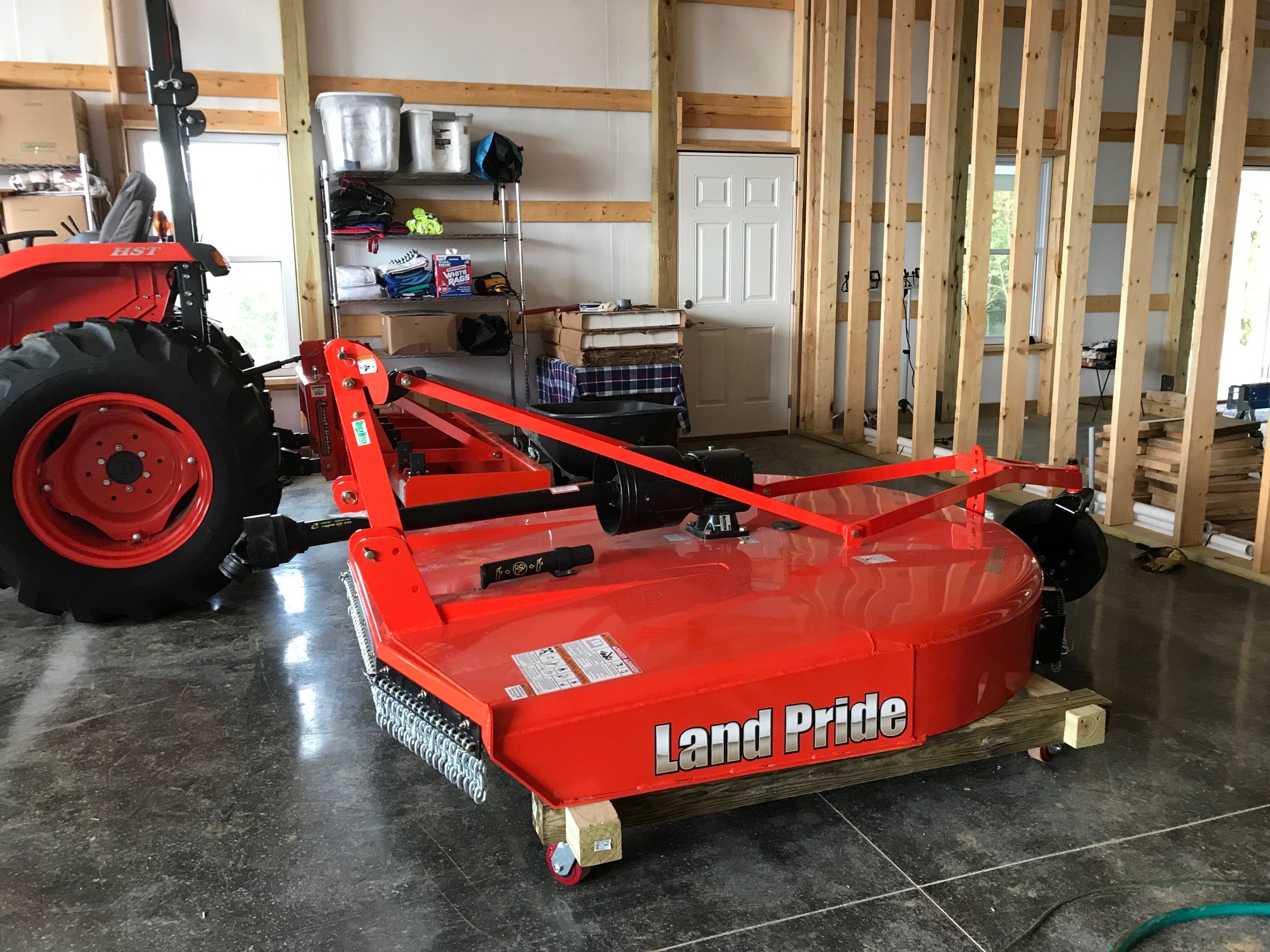

Here's the dolly I made for our brush hog. Works well. Found caster wheels at Menard's 600 lbs weight capacity each.

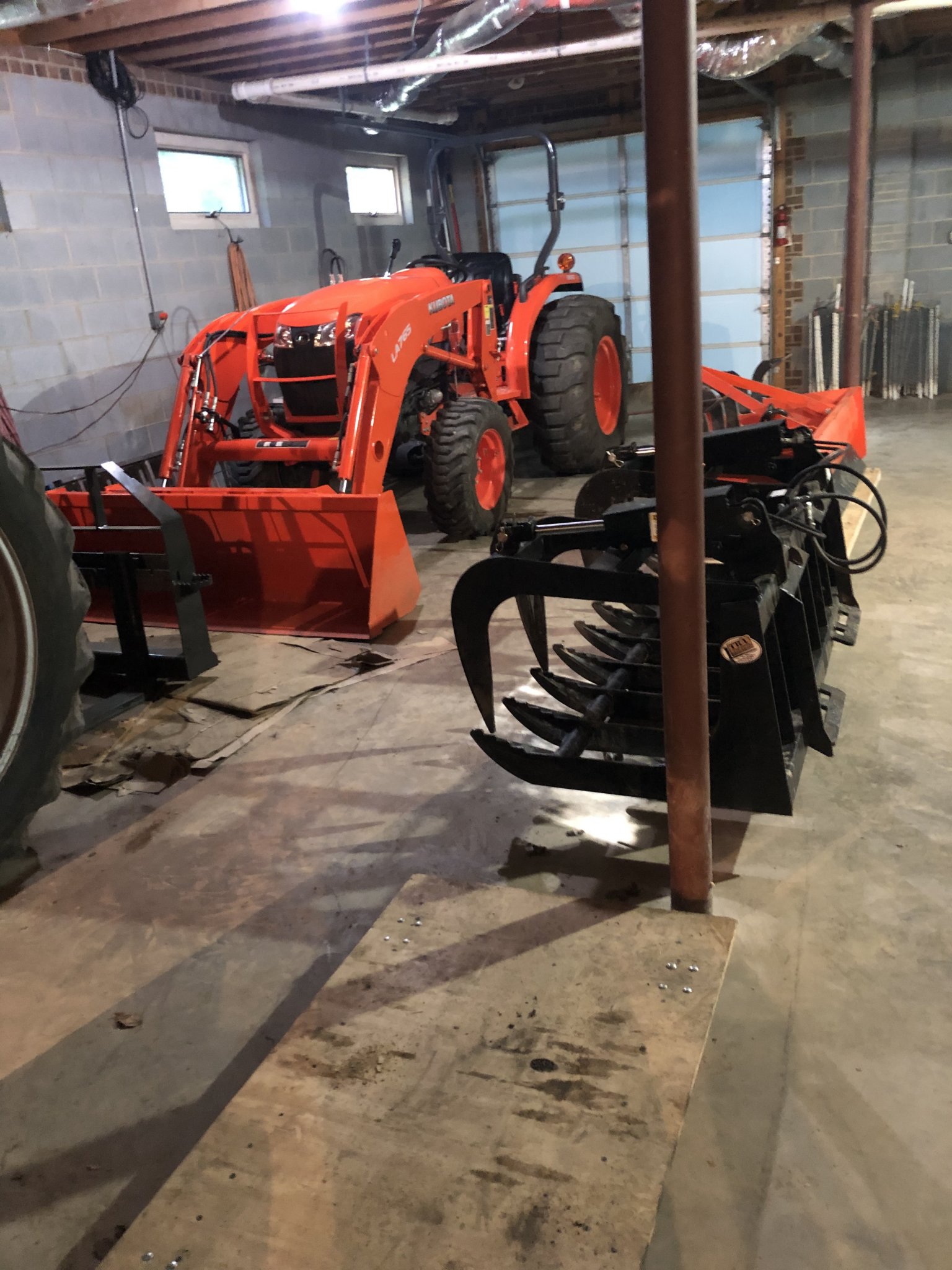

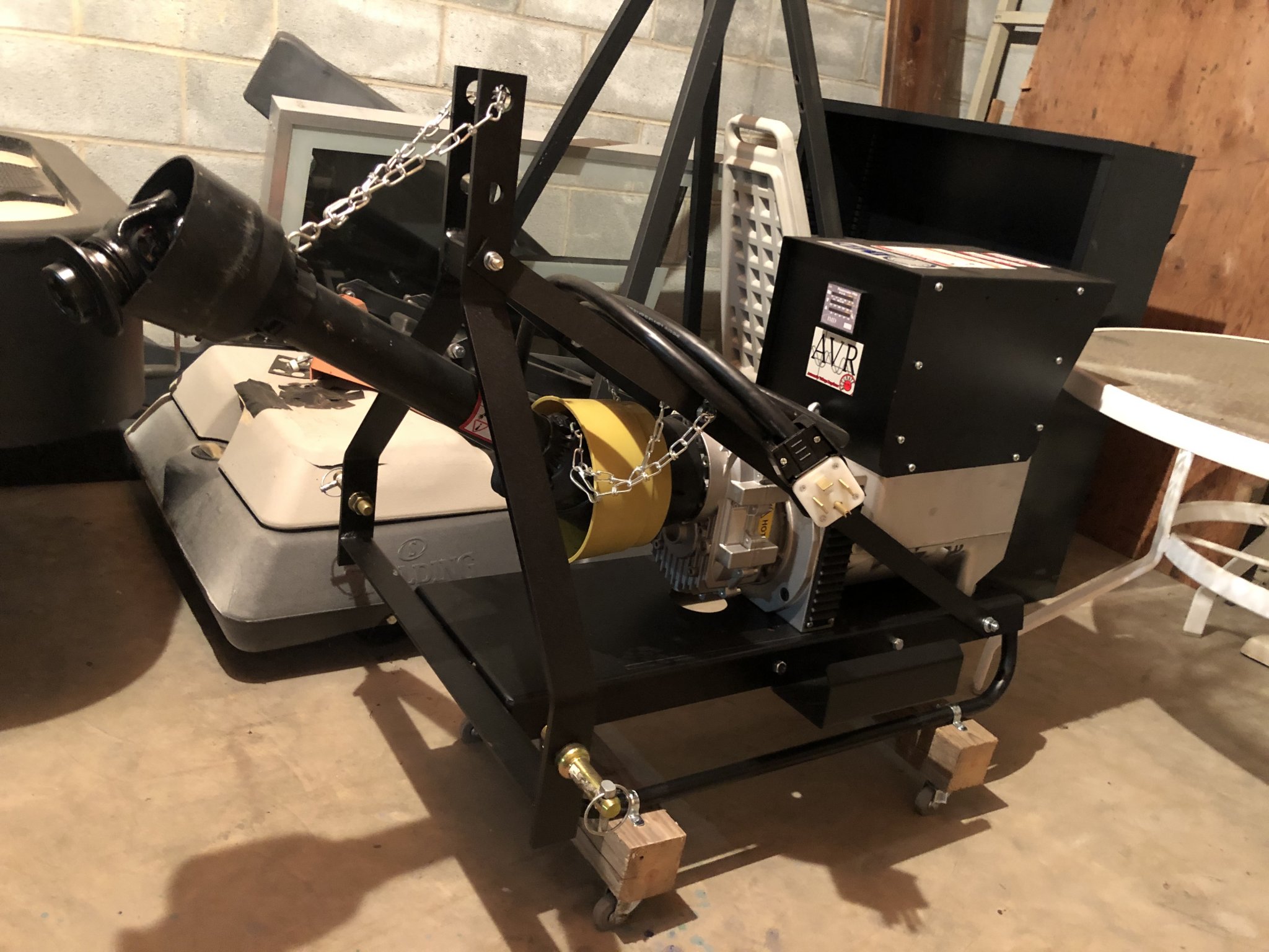

Like others, most of my frequently used implements are on true dollies with swivel casters but they’re also kept inside on a smooth concrete floor. I rarely use the forks so probably due to being miserly and a bit lazy, they sit on cardboard behind the rarely moved Farmall. They’re light enough I can slide them out of the way manually if necessary. The rotary cutter still lives in the dirt floor pole barn with a smattering of rarely if ever used agricultural implements that haven’t seen actual use in decades. If stored on a paved surface castered dollies work very well and are a great aid in attaching, particularly without a quick attach for the 3 point. Stored on dirt, castered dollies are near useless, which is why the rotary cutter is set on cribbing.
But for the dollies, I’d definitely have a quick hitch. I’ve dropped and reattached the box blade on unlevel dirt by myself once. It’s far too heavy for me to manually scoot around on dirt so it was not an experience I’d like to repeat. If I had to do it again, I’d probably fork it onto a dolly on concrete first.
