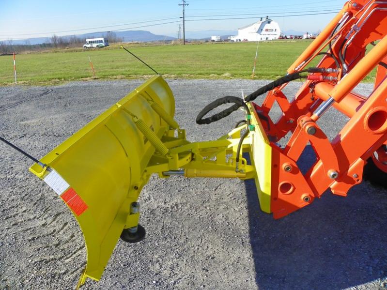

Sweet setup... I was thinking about the same kind of setup and wondered if the bucket curl cylinders could be unhooked and the bucket tilt on the joystick could be used for snowblade left or right? If the bucket curl hoses were unhooked would they essentially freeze the curl cylinders? Anyone try this?
I'm not sure how well that would work because the tilt cylinders would seep down after awhile changing the angle but if you put in a diverter valve you could make it work but I still prefer the 3rd function in my case.
