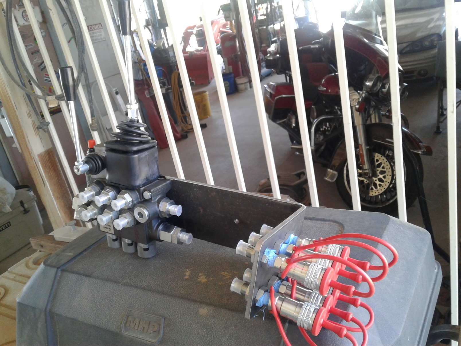

I also contacted fitrite but the wait time was to long so I fabed it myself, Top & Tilt and a 3rd valve function for a 3rd of the price.

Nice job joearizona! I was wondering why not use a joy stick for Top N Tilt, and seems you have proved that it will work. I would like to get the valve lower, behind the seat on my L2501, or between the seat and the fender. I'm still trying to decipher the hydraulics and simplify connections, if possible.
I used the Joy stick for the top and tilt plus a second joy stick for my 3rd function for a future grapple.
