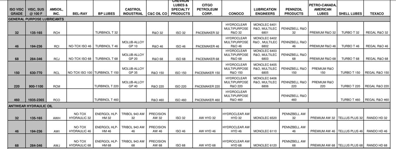

My newly acquired dump trailer recommends these oils:
Chevron Rando HDZ
Mobil DTE10 Mobil DTE20
Amsoil
Shell Tellus
I cannot find any of these in less than 5gal or 55gal sizes, and I probably only need a quart or single gallon to have on hand. (reservoir is less than a quart)
There seems to be no definitive crossover or equivalent charts for these oils.
Current fluid is clear and thin, I'd guess 10w.
Anybody have any insight?

Sheesh, something so simple turned out to be a PITA! Every place I tried had their particular brand oil, but none could tell me if it was equivalent to the recommended oils from my manual. Called all of the recommended oil companies & they could not tell me if their oils where compatible with anyone else's oils.
No one seemed to know much of ANYTHING about hydraulic oil, period.
They seemed to be equally divided between "You can mix any of them" and "Never mix oils, the world will come to an end". Called the manufacturer of the hydraulic pack & they could not help other than to tell me to call the trailer builder, they said they ship them dry to the trailer manufacturer.
Called LoadTrail and they said they use Mobil NUTO H32 (not even mentioned in the manual) and to not mix oils under any circumstances.
I found a gallon of the Mobil Nuto H32 on eby for $41.40 shipped, seemed high, but I was tiring of the hunt, so it's on the way.
