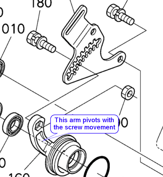

@whitetiger can you explain to him why he can’t get the slotted part to move? I cut a photo from his other thread (not sure it is the correct part shown in that since it was posted by someone else).
He has stated that he can’t move that even if the bolt is very loose. The picture in @North Idaho Wolfman post shows a similar looking part. What are the slots for? Is there some sort of locking pin involved in the slot to keep it located?
Or are they for using as a pry point?
