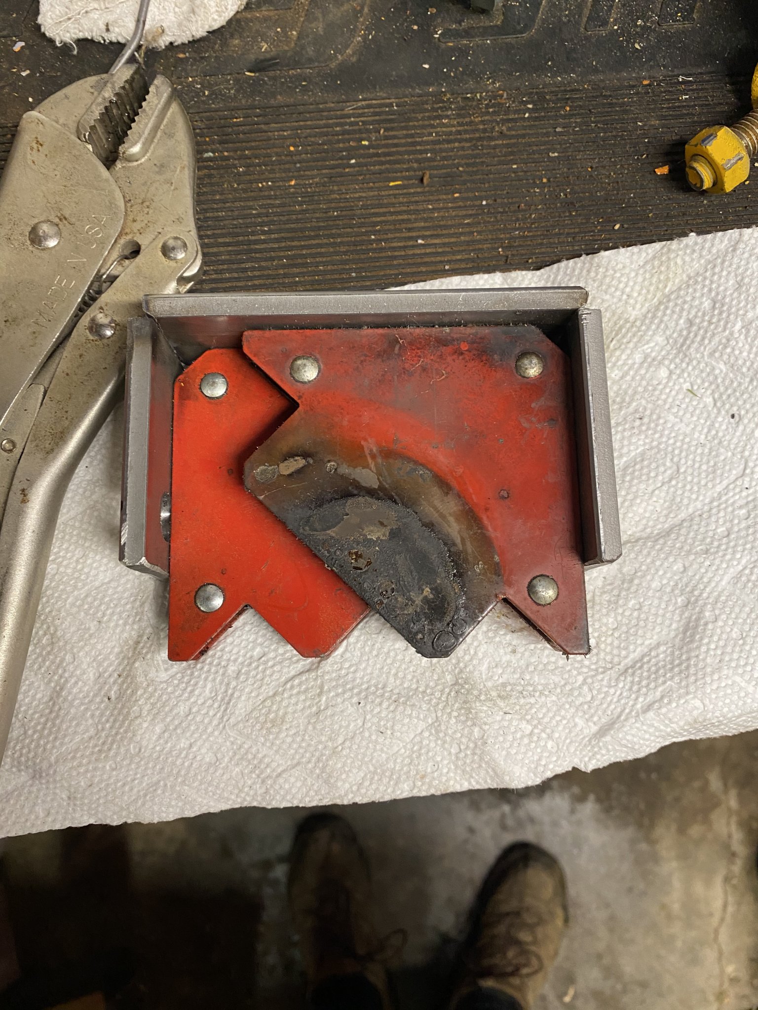

Working on a small metal yoke with a Lincoln MP210 in MIG mode at 240v.
Needs to be square and plumb. Tolerances aren't 0.001's, but can't be more than 1/16" off. (It's a part for a 1950's tractor).
For the life of me, I can't get the ground clamp on and keep everything together.
Tried clamping the magnet, but welds were cold. With some effort, I could break them by hand.
Long side is 4 3/16"x1 1/2"x 3/16" bar stock. Pretty little for me. Made in USA Vise Grips for reference.
Any suggestion on how to ground the welder without it pulling all apart? I did chamfer the top link, so it doesn't go in a clamp/vise well.
NOTE: The burn spot on the magnet was another project. Not related to grounding this project.

Put a bolt in that hole with a nut to hold it tight and put the clamp on the end of the bolt. Or you could lay a flat piece of steel across the top (above the magnets) and lay the ground clamp on that metal, exp if you're using a wire welder. Don't clamp it just lay it there.

You have any pointed nose vice grips. Short ones ? Or a small C clamp ? you clamp that on and ground to that.
Or depending on the finish of your product. You tac weld another flat bar off the side or top and ground to that. Then break it off and grind smooth.

I'm a novice.
Start out by welding on a metal table and ground that. Just my .02

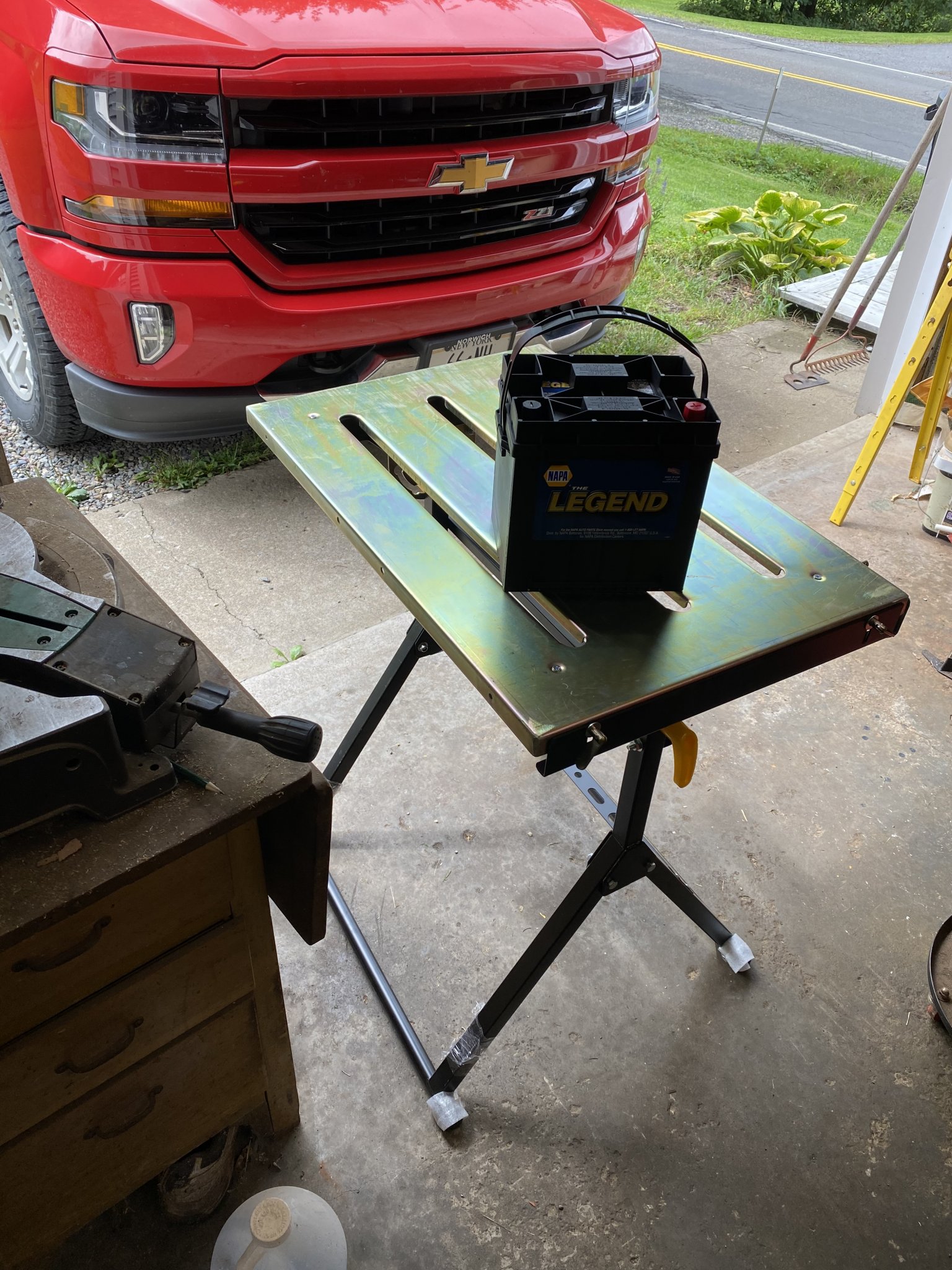

Many thanks fellas.
Greatly appreciate the advice, and highly respect the expertise you guys bring.
A steel welding table it is, and I learned several other great tips along the way.
9,743
6,378
Thanks again, guys.
No welding table yet, but some redneck improvisation worked wonders, with your help!

that looks like a welding table! just an improvised one. you could have hit it with a flappy disk and used your ground on it. however it looks like your solution worked!

I took the opportunity to make the hour trip to HF, and got their welding table.
Some HF stuff is just junk. This seems okay, and for $70 will work for my purposes.
