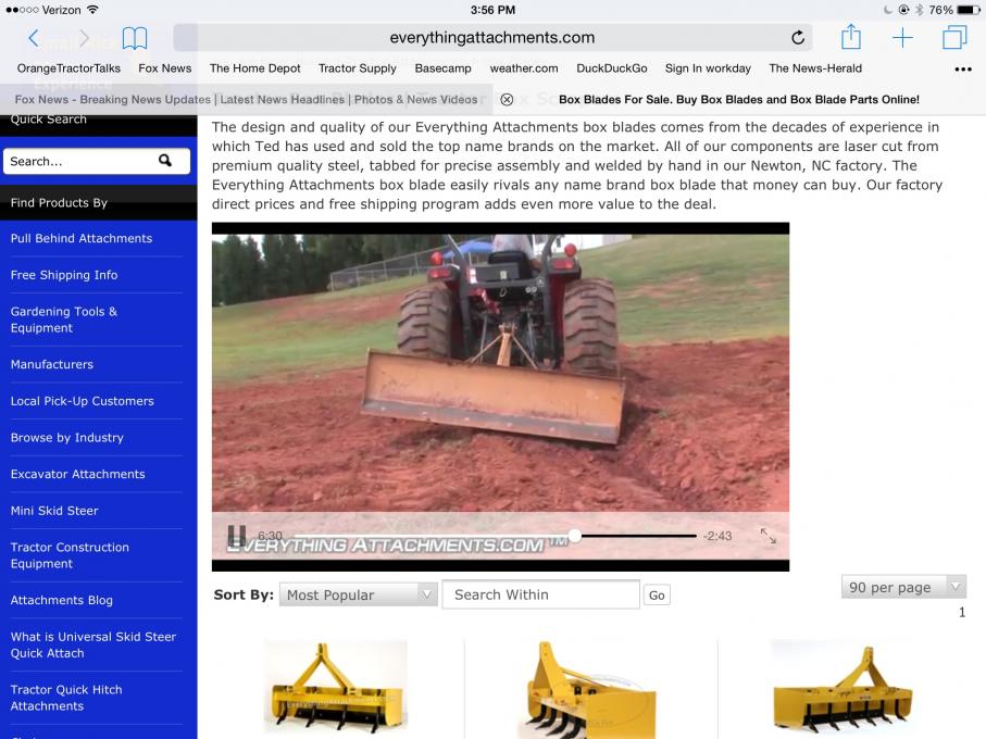

I dug two 300'x1' drainage ditches with my
Took two Sundays.
It sounds like you need a box blade to make your ditch so you can mow it.
Here is an example of how to.
http://www.everythingattachments.com/Box-Blade-Box-Scraper-s/85.htm
You may want to plow like ehennry or a middle buster and then the box blade to make your slope so you can cut the grass.

Just did about 250' of ditch with a 6' box blade with 2 ripper out of 5 attached to one side. Adjusted other side as high as I could. Made multiple passes in both direction until I was satisfied with the depth and width. Took me about three hours. :)
Very similar to the pic in bxray's post.
Good luck with your project.
