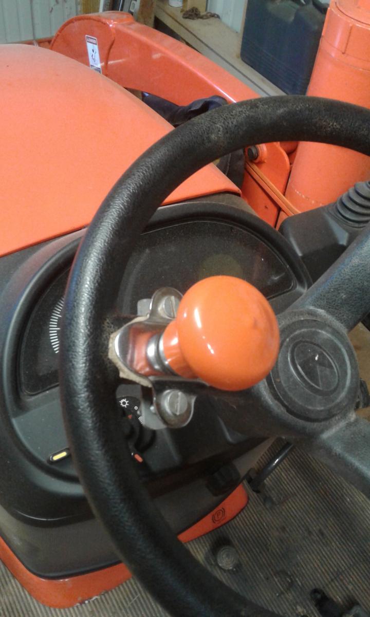

That is not my spinner in #6 - here is mine - an Amazon product :
https://www.amazon.com/WSV125OR-Sha...5022390&sr=8-6&keywords=tractor+wheel+spinner
problem #1 - the bolts are not long enough! IT will NOT fit on the spokes!
SO - you need a pair of longer bolts and a little shim material - I used a piece of hard rubber so not to damage the wide spoke on the wheel, I think I had to bang the backing plate a bit too!:)
