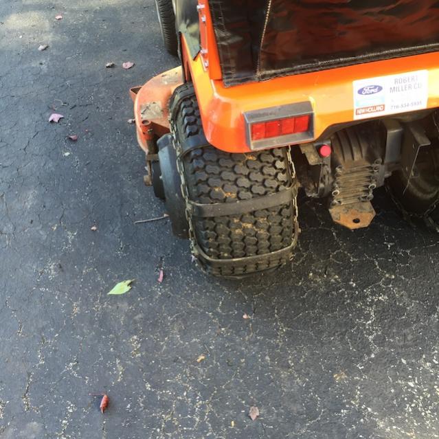

Ok, so I am not dropping 15k to get AWD. I have both rubber and chain. For blacktop that gets coated every year, I have found rubber to work the best as I always get a clean pass.
So, Can I add more weight to the rear? Chain has nothing to grip to on a sealed driveway.
Don't mean to be a party pooper but simply you got the wrong rig for the job. IMHO there is not much you can do to solve your issue besides a different rig.
Maybe fabricate some dually wheels?

Always have used steel tire chains on blacktop and concrete with no trouble. Only slight marks if tire spins. Got them recently from a place in PA, something like www.tirechainsrequired.com/ . I'd go for the two link for more chain on the ground.
That is my biggest problem. With the Diesel, I have so much torque, I spin the wheels like there is not tomorrow. Even when I am paying attention.
I have chains, maybe all are not created equal?
