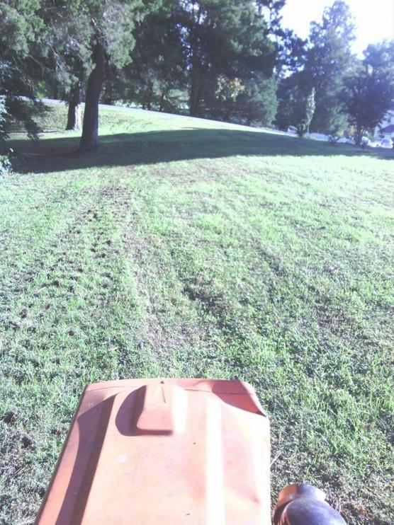

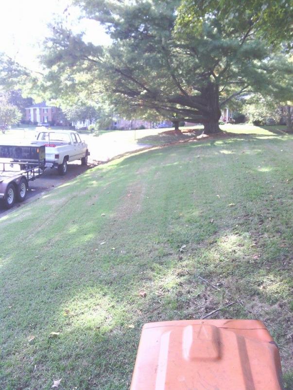

I've found that the perception of angles doesnt come across that well in photos.
I've climbed a few steep hills on the dirt bike and thought I had really done something, took a pic and showed it to others and they're like, that doesn't look that steep.
Just sayn...

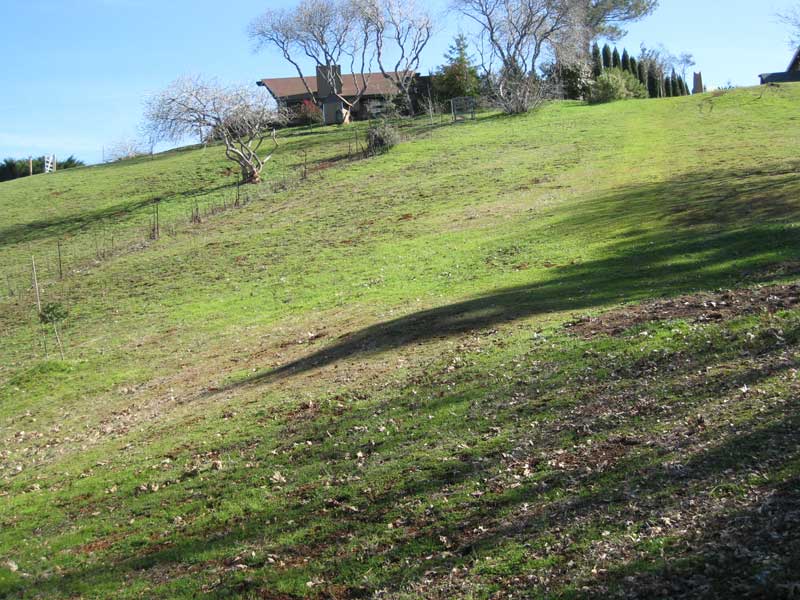

A couple more pics for reference....Yes to valve stems for water injection, I have those and will fill.
All, great comments, highly appreciated.
When on these hills doing loader work, it feels tipsy, maybe I just don't have the experience yet. When I'm out in my Gator, I don't get that feeling at all.
"I've found that the perception of angles doesnt come across that well in photos."
True, the slope rate (rise/run) in some areas is about 2.5/10, give or take some (in other areas, it's less).

I agree, and those last 2 photos look much steeper than the first 3. Do as the others have recommended and you'll be much better off. Good luck.

Judgement calls can be tough to make and almost always get you in trouble. On slopes like in the last two pictures, follow your gut instinct and go up and down for safe measure.
