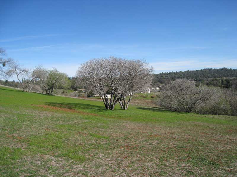

I live in the mountains and there is no such thing as flat.
Sitting here I have no idea if you are being overly cautious or if you really have something to be concerned about.
How about some pics?
It's my experience that you have to test the limits, start small and gain confidence.

going by pics, you should'nt have any issues to be honest, those inclines dont look excessive, some extra wheel weight or ballast below axle centres may be the best option having seen the pics.
14,976
4,039
squirm,, I must agree, I live in the Laurel Highlands of SW Pa and from the pics your grades do not look all that excessive. I would suggest that in mowing, go up and down the grades and get a feel for the machine and avoid across until you get more confident with your abilities. You have to be on a pretty good grade and moving side to side to flip it, not that it cant be done mind you. I would say fill the wheels, go slow, and learn your machine, and enjoy it, it will do things you never thought it would and bring you home safe as long as you do your part, just think it through how am I going to do this. And enjoy

I agree with the others about the slope shown in the photos. They look perfectly safe. Tractors are made to handle even steeper terrain.
