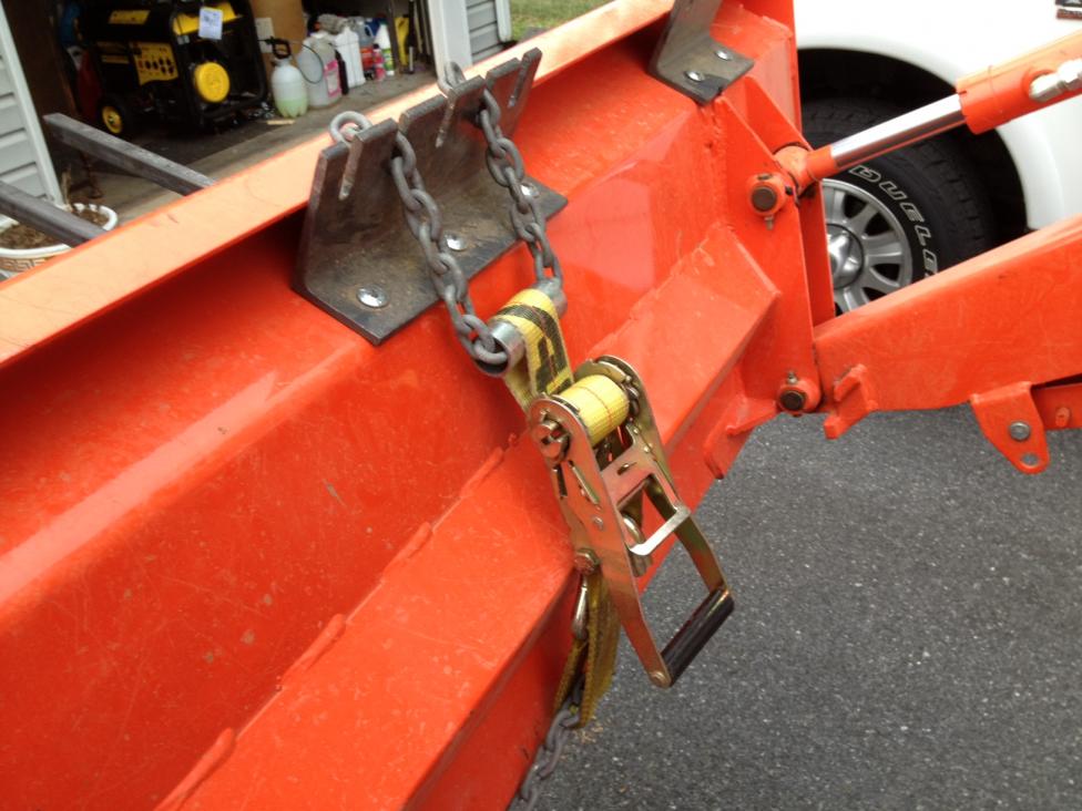

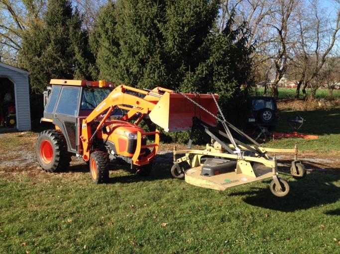

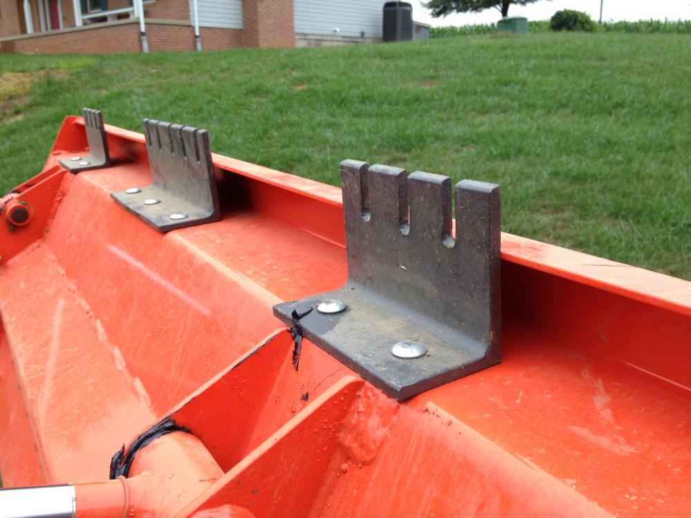

I used bolted-on heavy angle and cut slots in it for the chain to drop into on my last two tractors. Slots are easy to do by drilling a hole at the bottom of the slot and sawing into it to form a long skinny "U". The angle bucks up against the back of the top lip of the bucket and is much stronger than needed. The slots work for 3/8" and smaller chains.
They provide a wide selection of where to make a hookup. I've picked longer things by forming two loops to go down around them and the extra slots store the unused part of the chain to keep it out of the way. Another nice feature is the capability to disconnect the load by dumping the bucket, lowering it and backing away. It eliminates some hopping off and on the tractor when moving stuff around.
Loads can be connected with chains dropped over the front or the back of the bucket. The picture with the ratchet strap is the fastening means for my brush forks. The ratchet strap pulls a chain bridle that runs under the bucket to hold the forks on.
