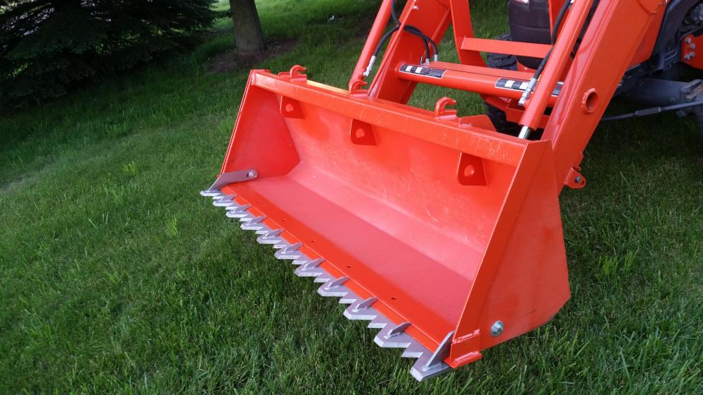

Stmar, I got the 3 hook setup I got from Kens bolt on hooks we had talked about, all welded and painted up for my neighbors L3800 yesterday. If yours isnt done yet, this will let you know what it will look like. One thing that was different on this 66" bucket from my 60" bucket is there was enough room on top to weld the anchor hook right to the top plate on the bucket without an additional 1/4 plate to make a long enough plate to support it.

Finally broke down and ordered the weld-on plates, 5/16" hooks and clevis mounts with ½" shackles from Ken's bolt-on hooks. Put them on with the grab hooks pretty much in line with the lift cylinders and the shackles just inside that - all on top of the bucket. Not the prettiest weld job in the world, but I don't think they're going anywhere.
Thanks for the idea rkidd and thanks for a great product Ken!
