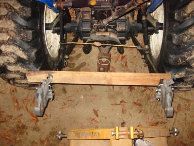

#1 get a Quick hitch!
#2 I have jack stands mounted to almost all of my implements that don't stand up on there own, Just drop the stand, open the quick hitch levers, drop the implement, and pull away.

If you have do not have a place to unhook on a level surface, this is a procedure that I use.
1) Back up as square as possible to the implement.
2) Hook up to the lowest pin on the implement first.
3) connect the top link.
4) Slowly raise the 3pt until the second pin is at the correct height. (you can use a bungee cord to hold the second link to one side if it is in the way)
5) If the second pin is to far forward or back, move the tractor slowly to align the pin. If you have a FEL on, this can easily be done by pointing the bucket straight down, slightly lift the front end up, then with the tractor in neutral and at idle you can feather it backwards or forwards.

I've got a hydraulic top link so I usually connect that first. leave the tractor in neutral and use the top link to maneuver the tractor/implement closer/farther away so that the lower pins line up. if one pin is lower than the other, connect that first, otherwise I connect the one on the other side of the tractor from the top link lever first. Some of my implements are on their own rolling stands which makes life a lot easier.
biggest thing I've found is taking it off in a good spot. I've taken an implement off, not really paying attention and it was a royal PITA to get it back on... uneven ground or tight location or whatever.

Having more that one tractor, and lots of 3 point stuff, that I have parked all over the place, it is my conclusion in the 40 years that I have been doing it, that 3 point hitch was invented by a nut. That being said, I hook one lower pin, and put the click pin on, then drag to a flat spot. Then I back up and adjust steering to square up the other lower link. Helps to have a digger bar or a steel fencepost, nearby, for prying things into alignment... Then PTO, then toplink. Helps to have a healthy full vocabulary of the invective case.
If I had my druthers all equipment would be Allis Chalmers snap coupler. Back up, snap in lower coupler, turn around click the 2 top links shut. get off tractor and slide up PTO shaft, and put the pins in the top latch safeties... takes about a minute and a half, if you have the lower snap coupler sitting on a cinder block...:D:D
