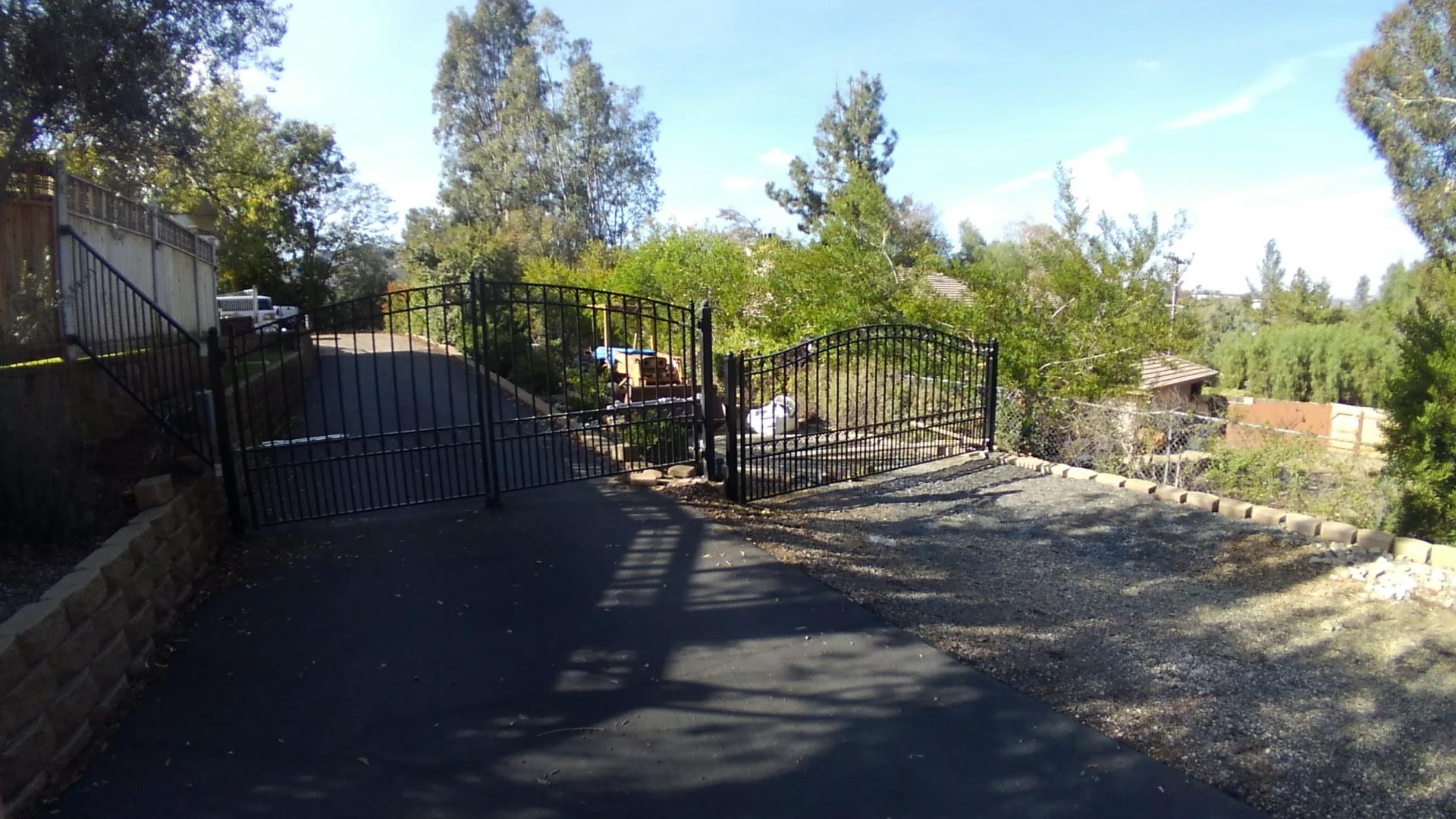

Just found this post and thought it was interesting. As others pointed out, it's a drop box/reverser rather than just a reverser. If you wanted to reverse the PTO more simply, you could attach one gear to the existing PTO and use that to direct drive another gear. Attach a PTO output shaft to the second gear and you're spinning in reverse. You're only adding a pair of gears, a bearing and another shaft the equation that way, and it could be arranged in such a way that the regular PTO could still be accessed normally. My old Massey 204 reversed the PTO when you put the shuttle shift in reverse, and that function is indeed handy when removing a stuck post-hole digger. I was putting in a driveway gate right next to another one that I had installed previously. Caught the auger on the concrete from the other post and it stuck hard in there and sheared the pin. Don't think I could have removed it from where it was wedged without being able to reverse it. Gates turned out pretty good though.
