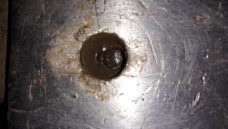

Can't really see much but this is looking from the top down. you're looking through a bar welded onto excavator tooth. there's a hole for access 20181209_121908.jpg

Only way that I know to remove it is drill it with a die reclaim drill also known as a Hi-Rock drill. They are solid tungsten carbide and can drill glass as well. Used in my industry for drilling out hardened tooling that has broken off in a hole. If you go that route, use only water as a lubricant to lubricate and cool the drill tip. They aren't cheap either.

Any more pics? Maybe farther out too to see what your dealing with. Trying to drill anything hardened isn’t much fun,and punches don’t drill easy either. My guess would be heat and another punch.
Sorry, I don't have any other pics (Excavator is at my farm). I am wondering if I can put this on press and ram it through?

Maybe? Lol. More pics of the whole thing might get more ideas. I’m no metallurgist or machinist by far. I did grow up and start working in the rust belt and dealt with a lot of broke off stuff, I’m sure many others here have too.
