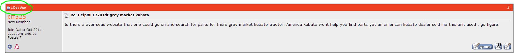

Is there a over seas website that one could go on and search for parts for there grey market kubato tractor. America kubato wont help you find parts yet an american kubato dealer sold me this unit used , go figure.
What do you want to know?
And it's Kubota, not kubato. ;)
33,311
8,657
coachgeo, and billrigsby, you got sucked in by a repost on an old thread. ;)
