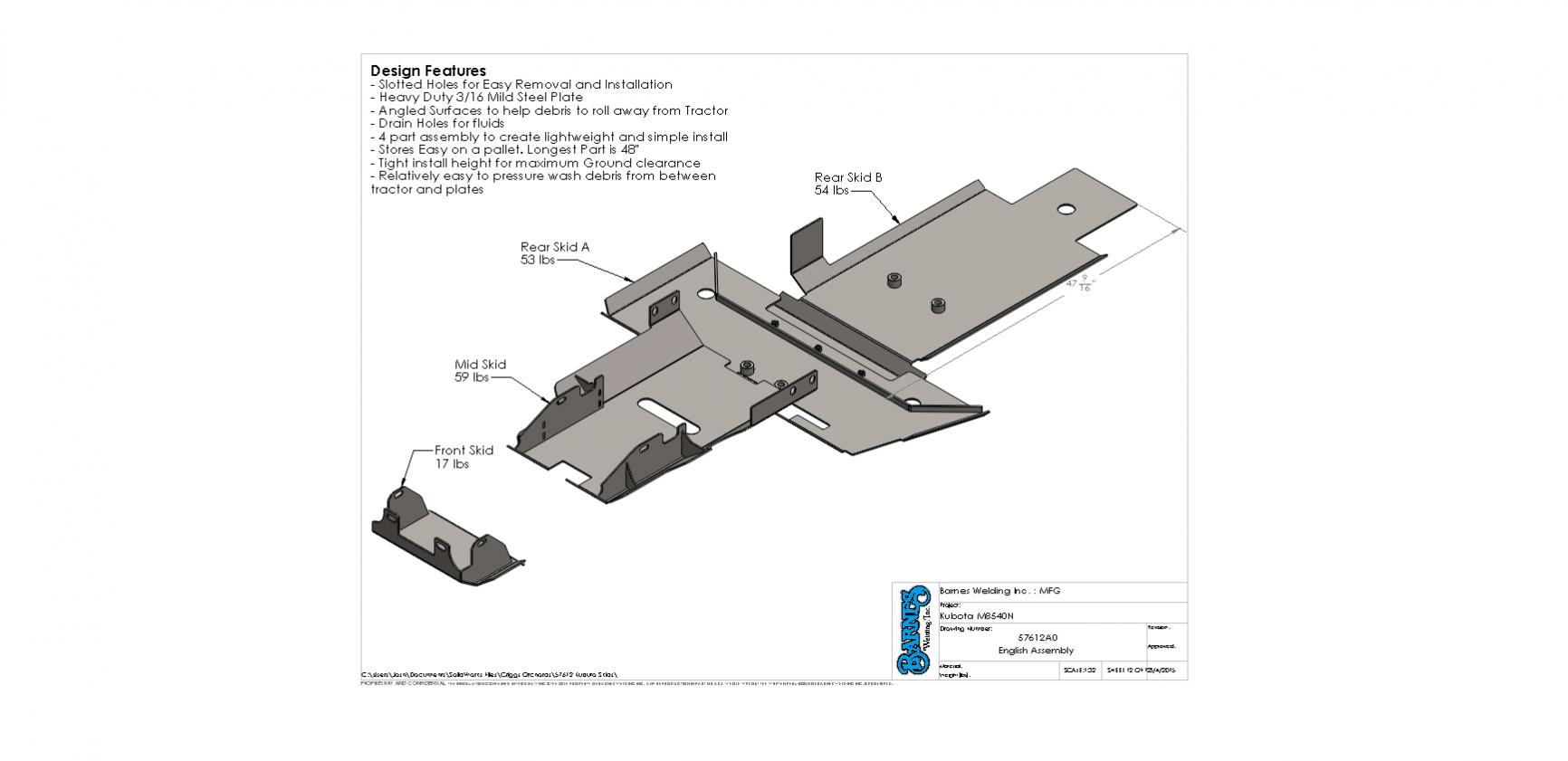

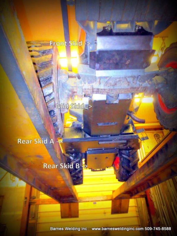

Kubota M8540N Belly Pan Skid Plate Kit
We were asked to help design and build a full skid plate belly pan system for one of our customers M8540N Tractors. They are chopping prunings in their orchards with a flail chopper and it is was not working well with their current skids. We worked together with our customer to come with the design.
Design Features
- Slotted Holes for Easy Removal and Installation
- Heavy Duty 3/16 Mild Steel Plate
- Angled Surfaces to help debris to roll away from Tractor
- Drain Holes for fluids
- 4 part assembly to create lightweight and simple install
- Stores Easy on a pallet. Longest Part is 48"
- Tight install height for maximum Ground clearance
- Relatively easy to pressure wash debris from between tractor and plates
We are working on a price point for the kit. What would be the max this product would sell for? If we manufacture 10 units at once we can keep the price lower.
What do does everyone think? Design? Pricing?
