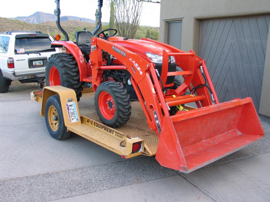

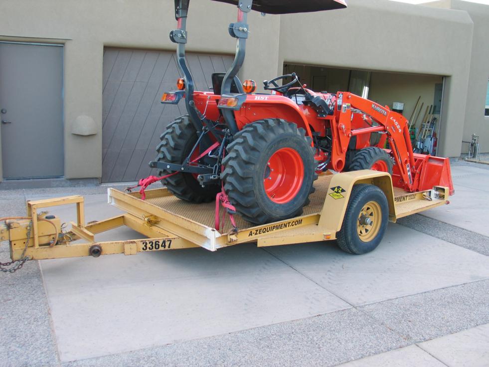

Don't do this!
Trailer is rated for 5000lb. My friend towed this trailer with his 350 Ford Diesel 85 miles to my house... with L3800, FEL, and a 800lb rototiller on the 3pt. He has a green tractor and kept telling me his was the same size. Not quite.
I borrowed the trailer to take it in for service on this day. Found out my Toyota only has a 3500lb towing capacity -including trailer. I kept it around 40 mph and started stopping about 1/4 away. The trailer brakes were very good, thankfully.
Awesome trailer in every way, except capacity.
