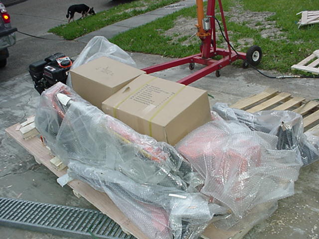

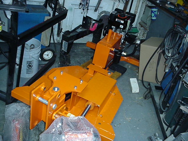

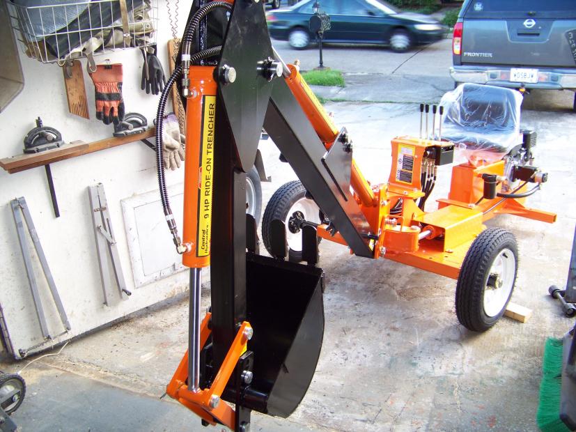

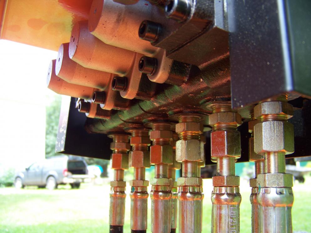

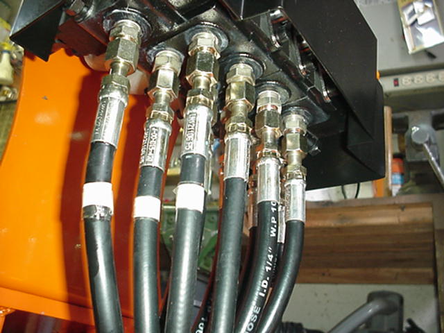

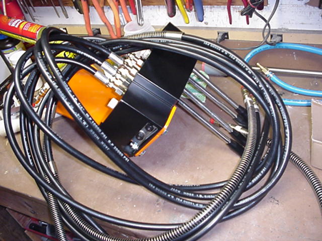

Picked it up yesterday. The shipping bill said 1200#, I'm glad I didn't read that before I moved it. It was wrapped in bubble wrap, with loose parts and boxes inside a wooden pallet frame, amazing it didn't have any damage, the only thing is the grease caps on the wheel hubs were dented, no problem. I unpacked it in the garage and started assembling it. The instructions are not the best, one thing I could add is, thread the hydraulic lines through the frame one at a time and put the longest one on the bottom.
It will be another week before I can get it outside and finish assembly.

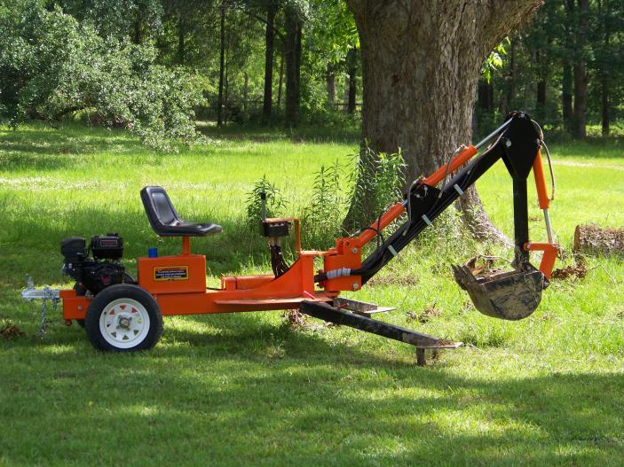

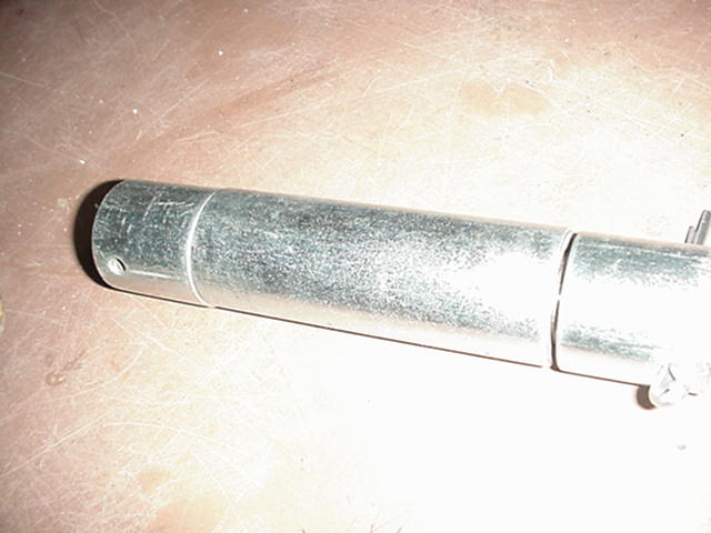

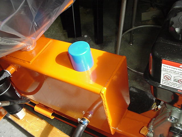

It's almost ready for the dirt. I add some protection where the lines run through the retaining ring, I noticed on my friends it was chaffing there. I added the blue cap over the hydraulic fill/vent plug to previent water from getting in, poor design. The joints all have grease fittings, but one thing I wondered about, was the pins at the end of the main boom, there is no way for the grease to get to the inner surface. So far I am impressed.

Probably will just use the hitch, it's light in the back end, so I need something secure. I was thinking about mounting a hitch ball on the bucket so it would be more maneuverable. One nice thing about it is, when the wheels are on the front like in the picture and the boom is at the correct angle, it balances out and you can push it around very easily. Thats how I get it in and out of a very tight garage.

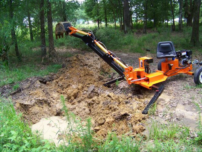

Finally got it in the dirt. It is a very strong machine for it's size. The biggest drawback is it's mobility. It does crawl around pretty good, but it has to be coupled to something with mass to dig. The rearranging of the wheels, stabilizers and coupling is very time consuming when preparing to tow it. I would welcome suggestions. Some ideas I had to correct these issues were to add a hydraulic spike to the back end, also add weight, add hydraulic lift to the stabilizer arms. This would let it work independent or the tractor. If time is not an issue, this is a good working machine for the price.

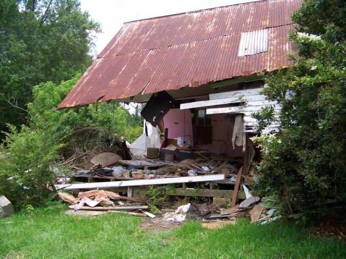

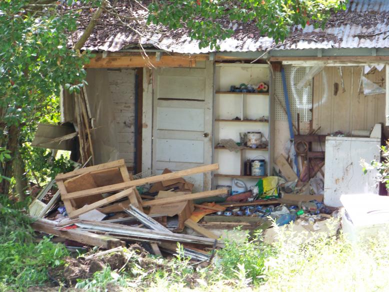

I was able to tear down a wall of an old house on the property. It punched through the wall easily and the lateral force just snapped the 2x4's like tooth picks. As for the picture - I weakened the walls and pulled the corner supports out from a distance with the tractor.
