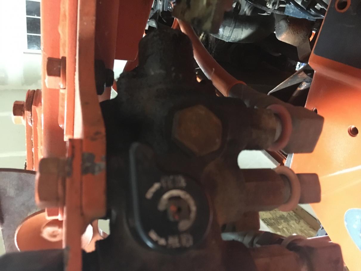

There's no venting that I can see, and I would think that that's where oil would be coming out if it had one, unless it's located higher up than the reservoir cap, which is in the transmission below, not under the seat.
33,916
9,137
You're going to have to follow the 2 lines that either come from or go to the loader valve that are not connected to the cylinders and find out there exact landing location.
The vent for the system is under the seat. ;)

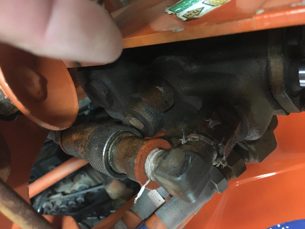

That's what the two pictures I put up are, that's where the lines terminate into the tractor. 1 is under the seat, next to the speed control valve for the 3 point, the other is on the rear end next to the 3 point lifting arms.
33,916
9,137
On the one picture of the pump output, you said there is a tee in the line?
Picture of the tee?
And if it does have a tee in that line that goes to the loader, then there is your problem, you cannot tee into the hydraulic line it has to be a loop circuit.

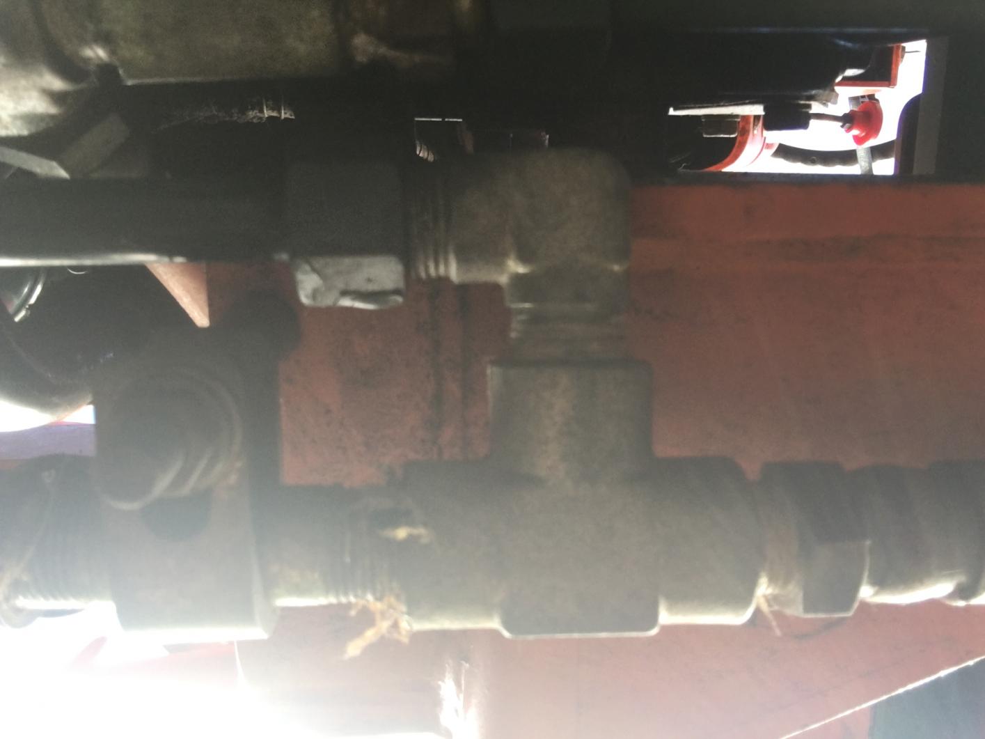

Ok, here's a picture so the t is in the line that runs from the control valve to the rear end of the tractor, and the tee goes to the hydraulic pump, into the fitting on the top of the pump, seen in one of the pictures above.

Yea I Pm'ed you with the only WSM that I know of that you're going to find that is close to your tractor, and that would just be on the tractor portion of things, nothing will be available on the loader.
In order for things to work right you will need to replumb the loader in the system in the proper way.
In order to do that you will need to find out if the loader control has another port for either tank or power beyond.
If not then it is a pass thru valve with just in and out and you will need to just remove the tee, connect IN on the FEL valve from the pump and OUT from the FEL valve back into the same line that originally came from the pump that goes back and feed the three point, and remove and cap the line and valve that goes into the side of the case of the rear end.

I'm surprised anything lifts at all, if the system is an open centre type -- which it should be if it's the same general type as that manual.
What I would suggest is to disconnect both of the lines from the loader and plug the tees. Then see if the 3ph operates at normal speed and power rather than slowly. If it does, then that pretty much confirms what Wolfman said: it must be re-plumbed, deleting the tees and utilizing power beyond feature. If you cannot ascertain that your control set has open centre spool valves and power beyond, then it might be easiest to buy a new valve with those features and documentation. But that's just my 2¢
If temporarily d/c the loader and plugging those tees fails to restore the 3ph operation, then that may be a sign something else is wrong.

The line between the pump and the FEL goes through a T fitting that feeds something else, right? Then yes, cap it. Or disconnect it at the T and plug the T. If it goes direct from the pump to the FEL, then don't.

The line goes from the pump to a tee, one leg goes to the fel, the other leg goes to the rear end, you'll find a picture above. Should I cap both legs or which one?
