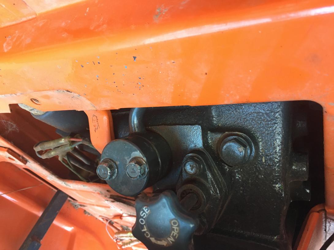

Can you get me more picture's of the connection under the seat?

I will post a couple shots of the valve guys, I have no idea if it's a 2 or 3 hose type. It has 5 hoses on the inside (left) side, and 1 on the front or bucket side. The hose on the front has a quick attach coupler on it

4 hoses required for the cylinders. That leaves 1 hose to supply the spool valves and 1 hose to return fluid to the tank. P.B. would require a 7th hose.
Is he missing a hose here? Is it possible that a P.O. did something silly like replacing the original control with the wrong type?

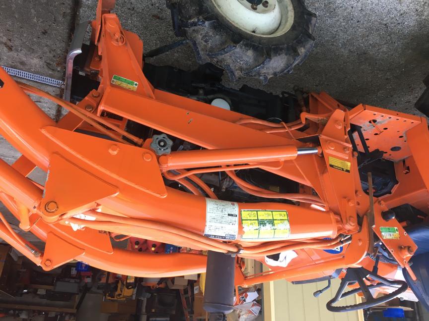

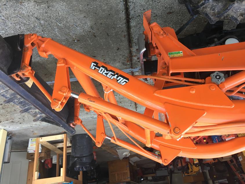

I assume this means it goes up at a normal speed and dumps at a normal speed. Which way are the cylinders pointed? One photo shows the ram ends of the boom cylinders attached to the post. I don't see a photo of the bucket cylinders. Are the ram ends of the bucket cylinders attached to the bucket? In which case, both slow movements occur when the fat end of the respective cylinders are returning.
The fat ends hold more fluid than the ram ends, therefore the return line must handle a greater flow rate when lowering the boom or curling the bucket. Could this simply be a matter of a pinched or otherwise restricted low-pressure return line?

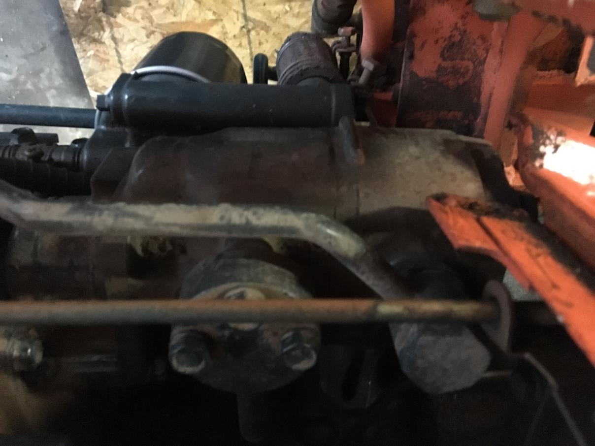

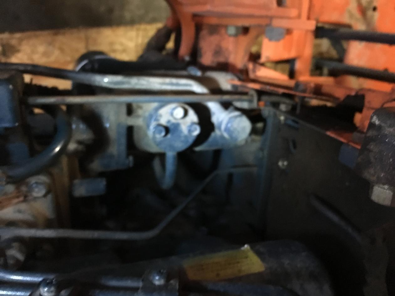

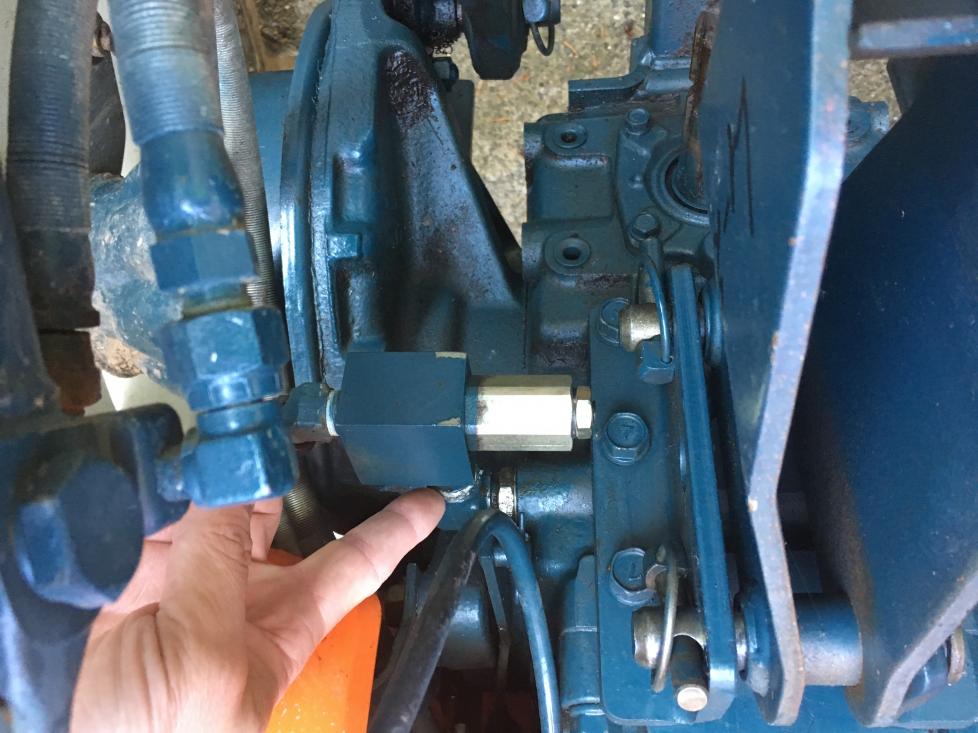

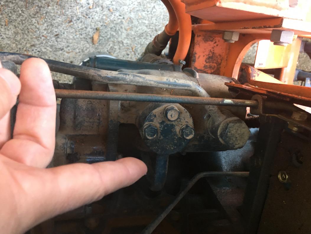

Here's some pictures of where the lines coming off of the control vale go into the rear end, and also of the cylinders the first one is from under the seat, the line goes into the fitting next to the 3 point hitch speed valve
