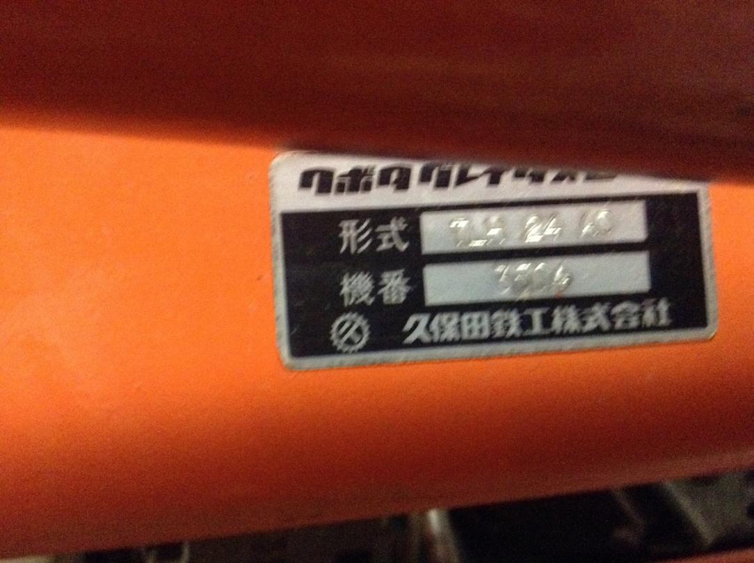

Hi guys, I recently purchased an l2550 tractor with a front end loader on it, I'm looking for info about the loader, as everything on it is in Japanese. The local dealership won't help me, as they informed me it's a gray market machine.
Any ideas about how to find out who made it, if it's factory or not, or info about parts, specifically a control valve for it?

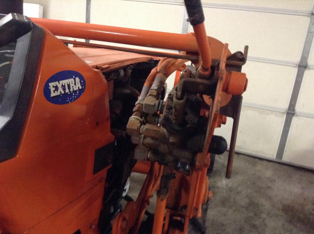

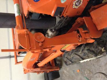

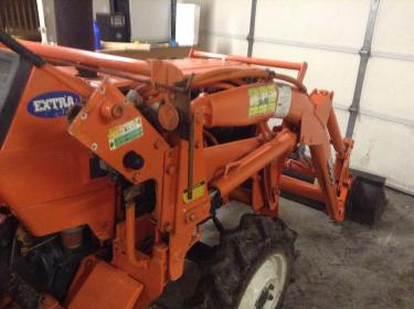

Ok, here's a few pictures. The issue I'm having is that it will go up but is very slow letting it down, and also it will dump but not pick the bucket back up very fast. I already changed the hydraulic filter at the suggestion of a friend, whom also suggested changing the control valve, thanks.
33,392
8,705
Re: Front end loaders
Ok the good news, it's a Kubota loader.
Now the bad news, it isn't a Kubota loader normally seen or used in North America, and getting parts or any information is going to be near impossible.
Now what is the problem with it?
You mentioned control valve, is the valve bad and you need to replace it?
If so then any open center 8 GPM or close valve will work.

Thanks Wolfman, another thing I noticed and did is I took the cap located in front of the seat off and hydraulic fluid came gushing out. I drained off about 8 gallons and it's still over the full indicator window. Is the window relevant if the loader was added to the tractor after manufacture? The fluid looks fine, should I completely drain it and add only the prescribed level, which is 7 gallons?

Yes I would drain all of it out and replace it with new, and do the filters at the same time.
There is no logical reason it should be over full even with the loader on it. ;)
