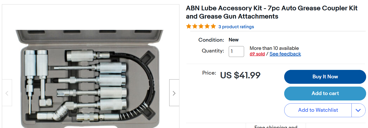

Other ideas are

X3 for lock n lube. Like others, I also keep a gun with conventional coupler.

I have lock and lube and the chinese take off both work equally well for me. Accept there are time times that neither will fit the situation. Must have 30 other attachment.
