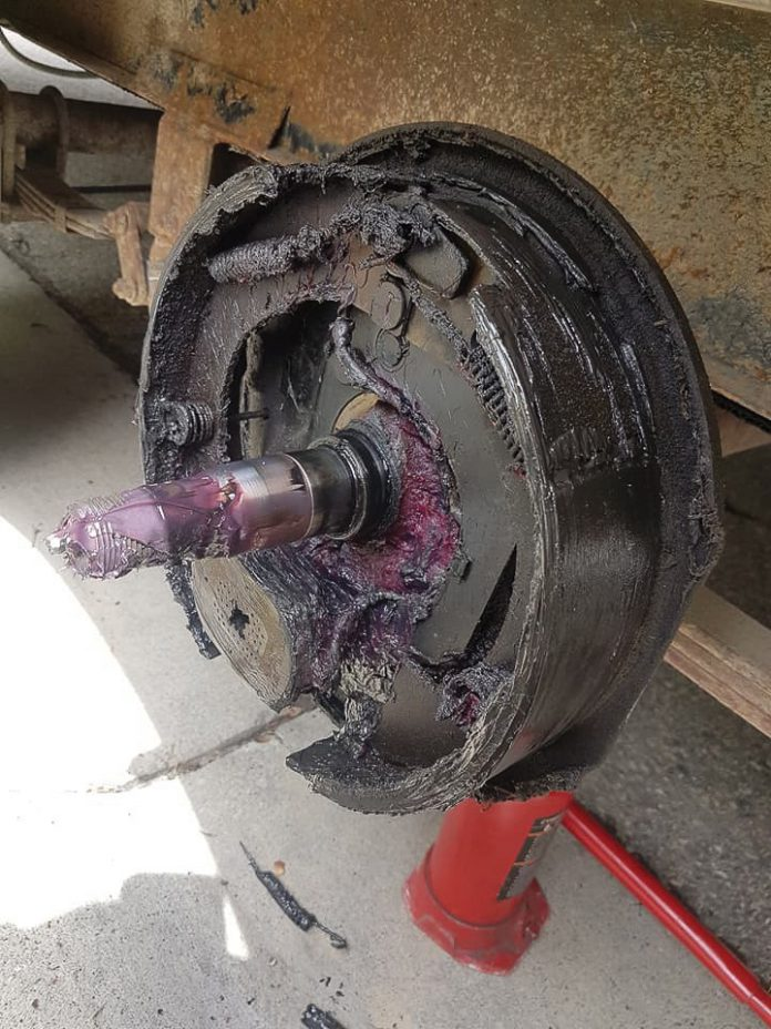

So, my Manual Pistol type grip Lube -Shuttle grease gun kit came today with 10 tubes of moly bearing grease.
I am very impressed. I lubed my tandem axle'd 14K trailer via the EZ Lube axles. I actually got no grease on my clothes. And that was after changing two grease canisters.
I never use the stupid EZ Lube grease fitting, grease may pass thru the seal and onto the brakes, there is a big waste of grease filling the cavity between bearings. Bearing and brake condition needs to be inspected regularly and all that extra grease makes a big mess.

I understand your concerns. I was just like you. Thought that it would blow out past the rear seal. Saw pictures of it too. I've had ez lube Dexter axles on a few trailers. I ignored the ez lube and repacked the bearings by removing them. Which takes more time. And more money because you have to replace the rear seal to get to the rear bearing.
Finally one day I tried the ez lube despite what some say online, just to see if I'd fill the brakes with grease. I pulled the hubs off a month later and there was no grease past the seal or in the brakes. They worked!
So, I know there's wasted grease in the bore inside the axle hub, but I'm now an EZ lube axle believer.
I still think that every few years you should pull the hubs and check on them, manual repack.
But as long as you lift and spin the tire when putting grease into the ez lube, I think that it's a pretty good system.
Edit:. I would not recommend using an automatic high volume grease gun. Too much grease too fast will blow out any seal. Do it slow and use a manual grease gun.

Currently own 3 trailers that have ez lube axles. Haven't had that issue with any of them. Although for inspection a wheel gets pulled from each side every year and new seals go in, so they get changed every other year.
