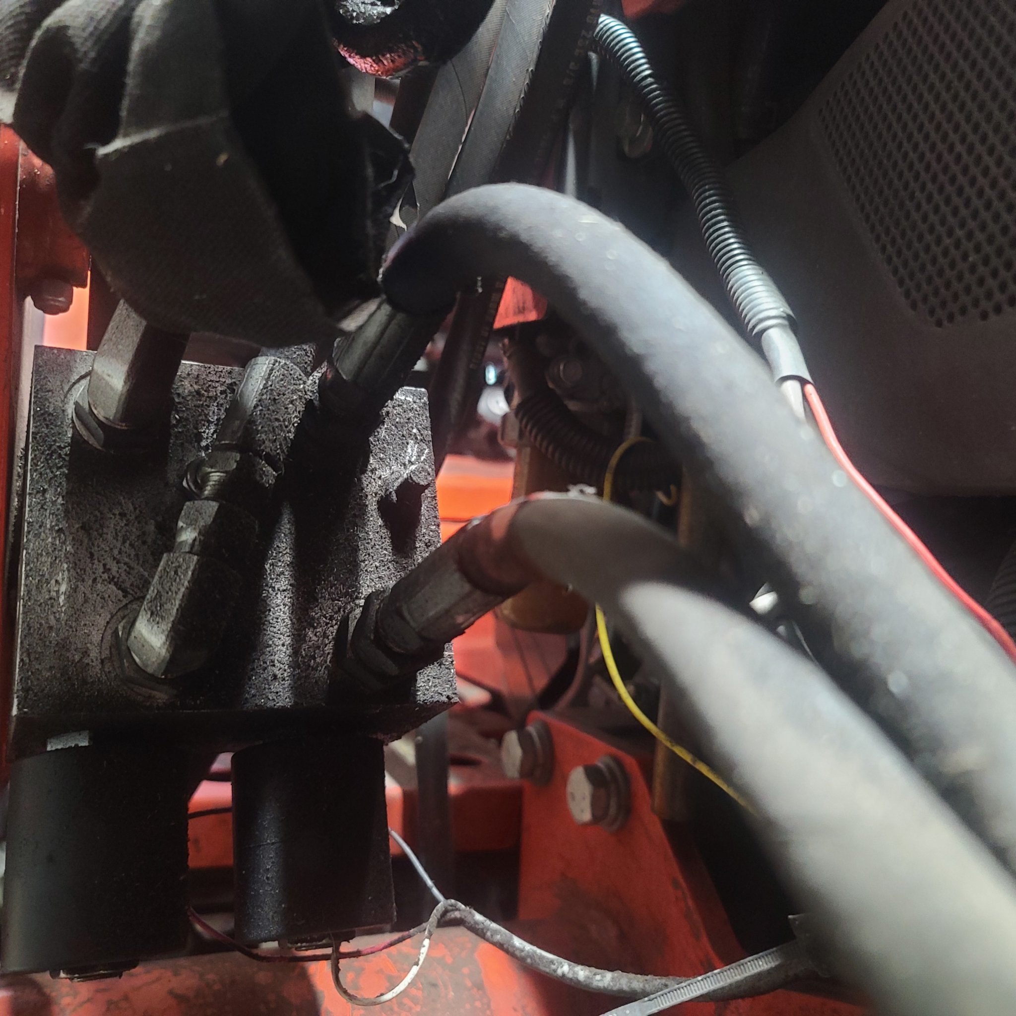

4 on the bottom 2 on top of the 3rd function valve
It is a diverter. If the tilt works but the grapple does not there is a distinct possibilty one of the spools in the diverter is stuck or the solenoid is not working. When you press the button BOTH solenoids should click. If only one clicks the solenoid is not functioning for some reason. If they both click try giving the diverter a solid rap. If the spool is stuck that might be enough to free it. If none of that works my next step would be to disconnect the female couplers on both grapple hoses and see if you get flow out of both of them. If not the diverter is not working.
I'm nearly deaf but when I put my hand on the solenoids it seems/feels/sounds both are engaging
