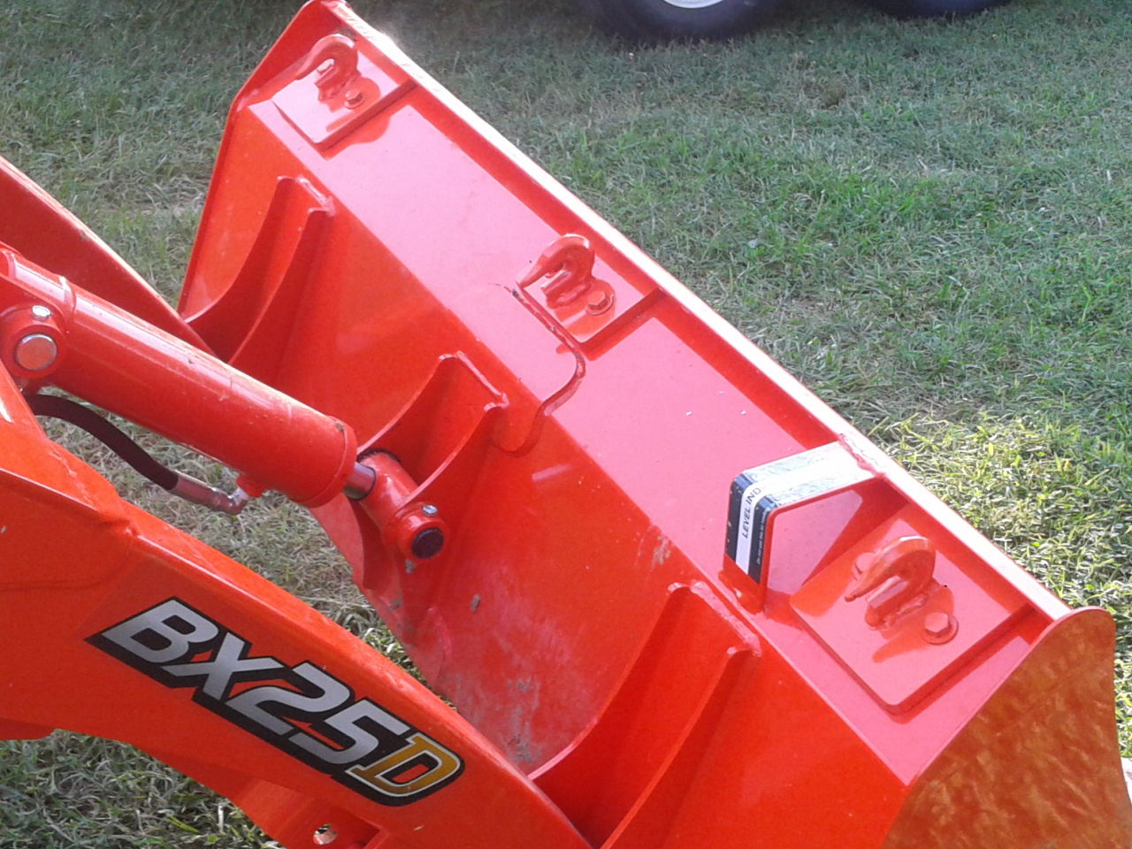

I made my own:

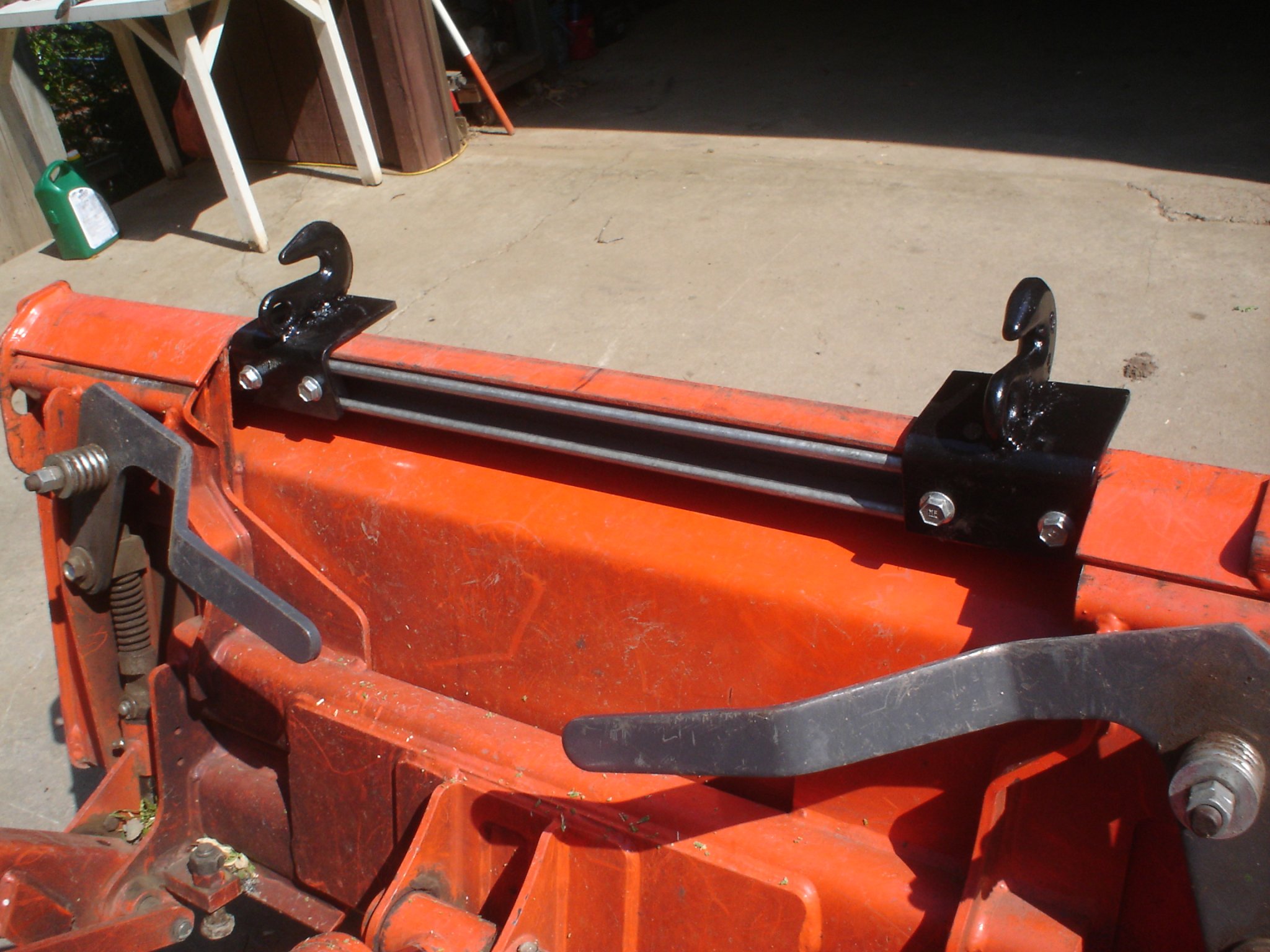

I chose option #3, the no-drill, no-weld option. Electrical 'strut' slid into the pockets of the bucket,hooks welded to plates that bolt onto the strut. It's crazy how USEFUL they've been over the past 4 years !
one day I may add a 3rd hook,dead center....one day..

I chose option #3, the no-drill, no-weld option. Electrical 'strut' slid into the pockets of the bucket,hooks welded to plates that bolt onto the strut. It's crazy how USEFUL they've been over the past 4 years ! View attachment 114315
My hooks come welded to the outer most plates.
How strong is that Uni-Strut, in an application like what you've used it for? Share some examples, weights lifted, etc.
I like outside the box thinking.
