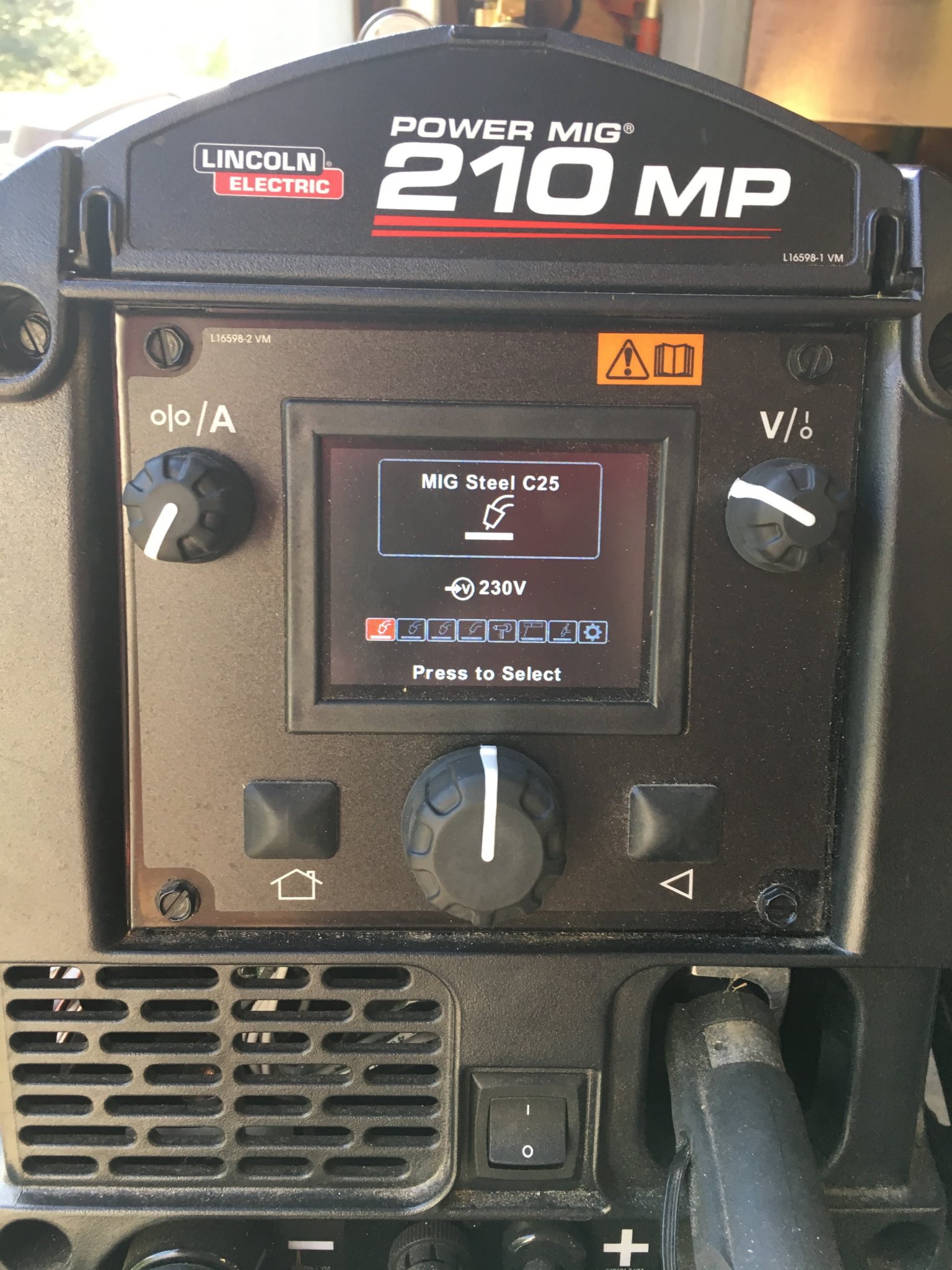

I got a Lincoln 210MP several years ago. Dual voltage and also MIG, TIG, and stick. Only used mig w/gas so far, but has the other capabilities if I ever need them. It has some good presets, but allows a lot of adjustments.
I started at 120v, then put a sub panel in the garage for 240. Big difference.

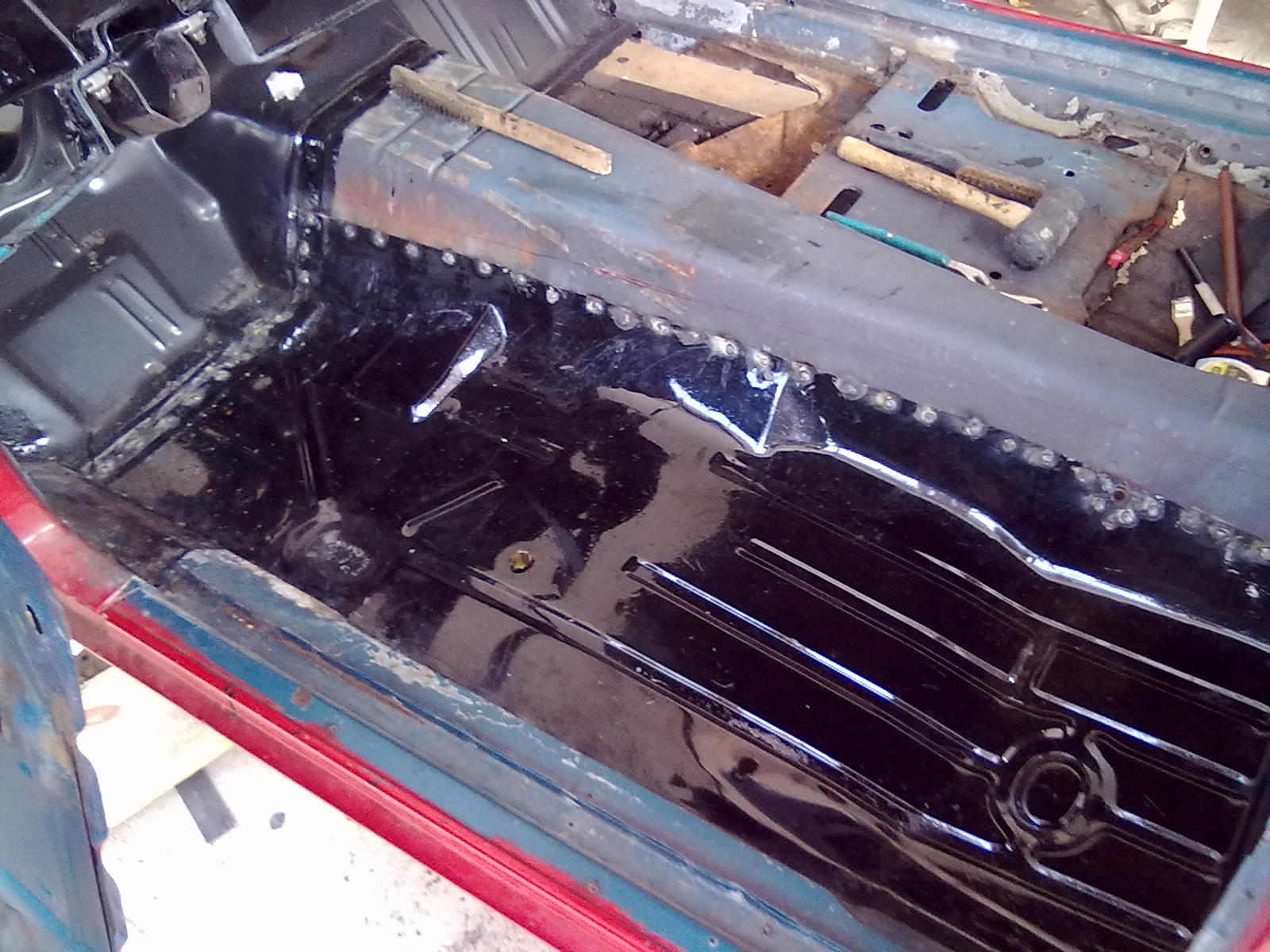

Here is my learning approach. Buy the cheapest Harbor Freight flux welder. Start helping your buddy with his rusty 69 Camaro. We used my welder and his, in flux mode for the thicker metal (firewall, floorboards etc.) Then switched to MIG on his low end Lincoln welder for the thinner body panels. I never thought I would do so much cutting and welding and grinding. So far it has no fallen apart yet.
