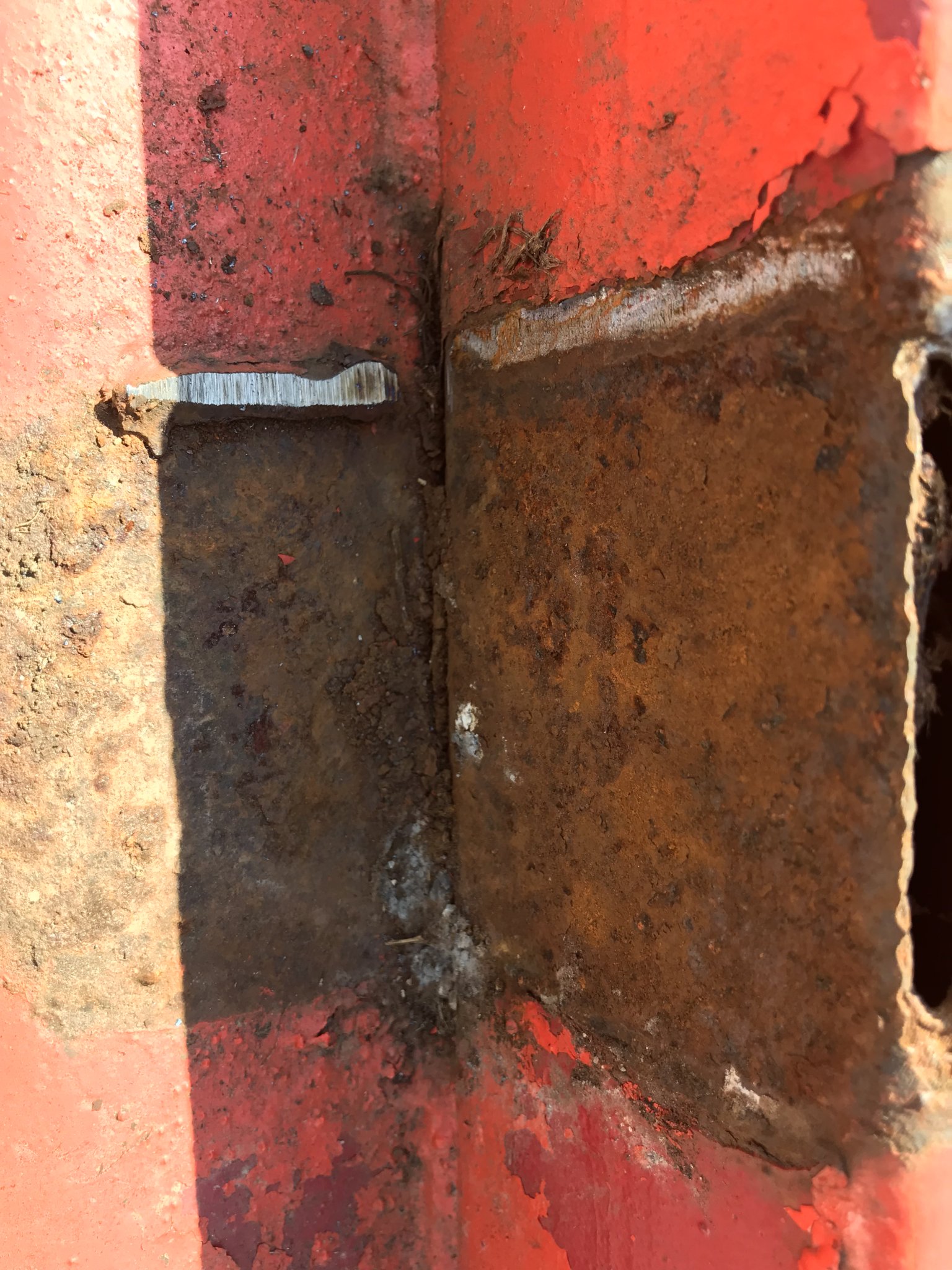

I glued odds and ends together at the inlaw's farm till buying a Millermatic 175 about 15 years ago. It's a nice 240V machine, will do both fluxcore and solid. A couple years ago I added a Hypertherm Powermax30AIR plasma cutter. I'm near retirement and wanted to round out the equipment. Just this past year I thought a stick machine would be fun, and bought an Everlast PowerArc 200STi. That's a slick lightweight inverter DC unit that runs on 120 and 240 volts. I haven't had much of a chance to use it so far. I did a couple small projects and am impressed with how nice it runs 7014 rod.
Some things to note:
* A MIG weld can look perfect (and be anything but) See the failed factory weld on one of my rear blades below
* Most if not all MIG machines use different drive rollers for solid / flux core wire
* Duty cycle usually doesn't matter to the hobbyist (but I did need to wait on the MM175 a few times when doing larger projects)
* It's impossible to have too many clamps
* Magswitch devices are great
* A decent heavy table and vise are VERY useful
