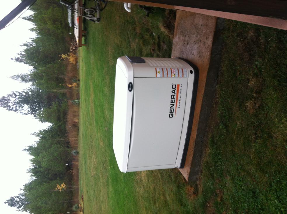

One of the first thing I put in after moving to N Idaho. Hooked into a 250 gallon propane tank. It comes with a weatherproof, vented shell. I also wired in a manual bypass switch, and a plug on the back porch for using a portable generator. A back up for the back up.
