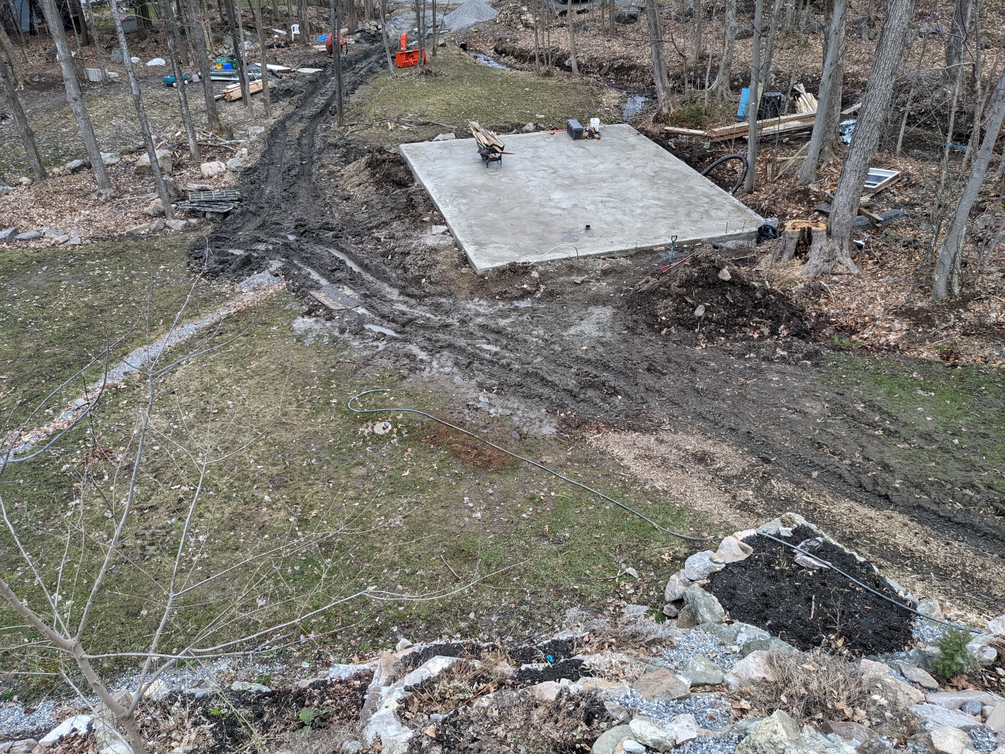

Slab is done.
The ready-mix was at the end of the driveway near the snowblower. So I was using the tractor from there to the slab.
About 20 loads away from being done, my front tire poped off. No time fix this. So I continued with a poped off tire for the rest. It was difficult, but still easier than a wheelbarrow. In the end, it seems like I haven't damaged the tire. But the wheel is full of mud. So I took it to a local car repair shop so that they can clean it. So now I don't have a tractor until monday...
At least I'm glad this part is done.

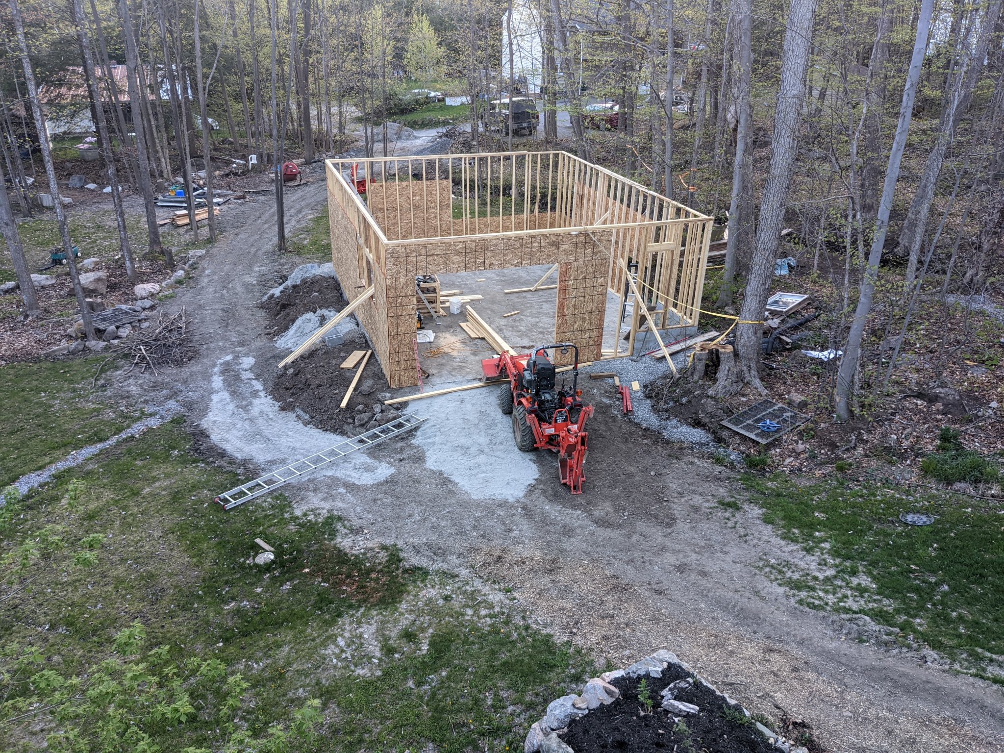

Walls are up. The challenge now will be to square a level everything. I'm planning on putting the trusses up on the weekend of the 22nd.
The design has changed a bit from my original plan as posted in #1. The garage door is now oriented on the east side. The floor is also 2ft longer, so I had to build another truss. It was way cheaper to copy one of the ones I got than to get the manufacturer to build another one. It was easy to build since I just had to nail a few 2x4s on a factory-made truss and build from there.
One thing I'm disapointed: I emailed the truss manufacturer to see if I can suspend shelves from the trusses (as opposed to sitting them on legs to the floor, eating up room space) and they said I would need to double up the trusses if I want to suspend weight. I'm still not sure if I'd rather do that than to make legs.
Look at the size of the opening. Plenty of room for tractor and the riding-mower. I'm.glad I listened to you guys and made a 10ft door.
It hasn't rained for about 2w now and nothing forecasted until next sunday so the soil is all dry. Way easier for the tractor. We're getting temperatures in the 30s these days so very hot to work outside. I'm gonna need to put the garage on hold and work on the garden now. I wanted to build some kind of 3ph attachment for making rows but I didnct have time for time. Project for next year. The tractor is being utilized a lot these days. At 2.50$/L for diesel, my hobby is getting expensive.

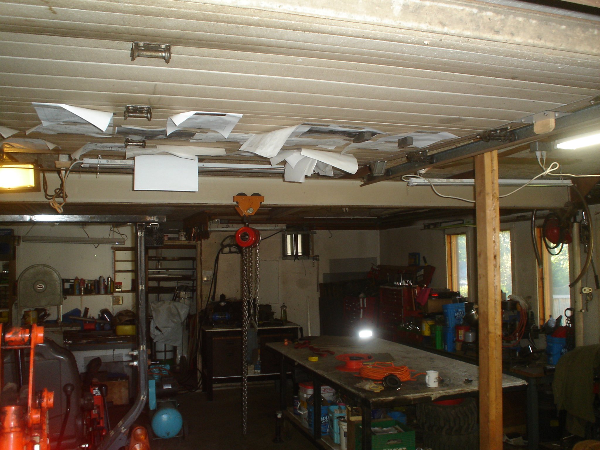

side note: If possible, consider installing an 8" tall I-beam on the N-S walls,with solid studs underneath. You've got a GREAT opprotunity to do it now... and it's really 'helpful' ! I have TWO trolleys and chain hoists on mine,makes it easy to lift front end of riders to service decks, lift heavy things onto workbench, split full size tractors for clutches.......
I know, money's tight but........ now it's EASY to install......think of it as a lifetime investment.
with a 24' span, I believe I would need a post in the middle, wich would be a bit cumbersome. Also, I would probably need a pad under that slab at that place.
BX23-S,57 A-C D-14,
13,907
6,333

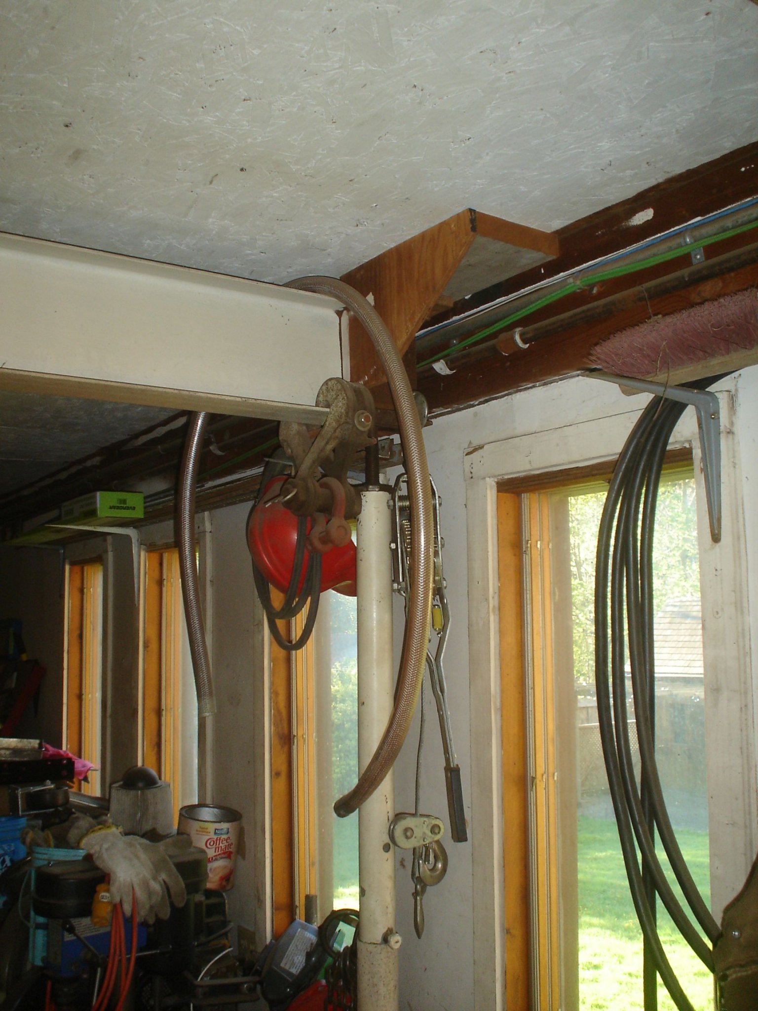

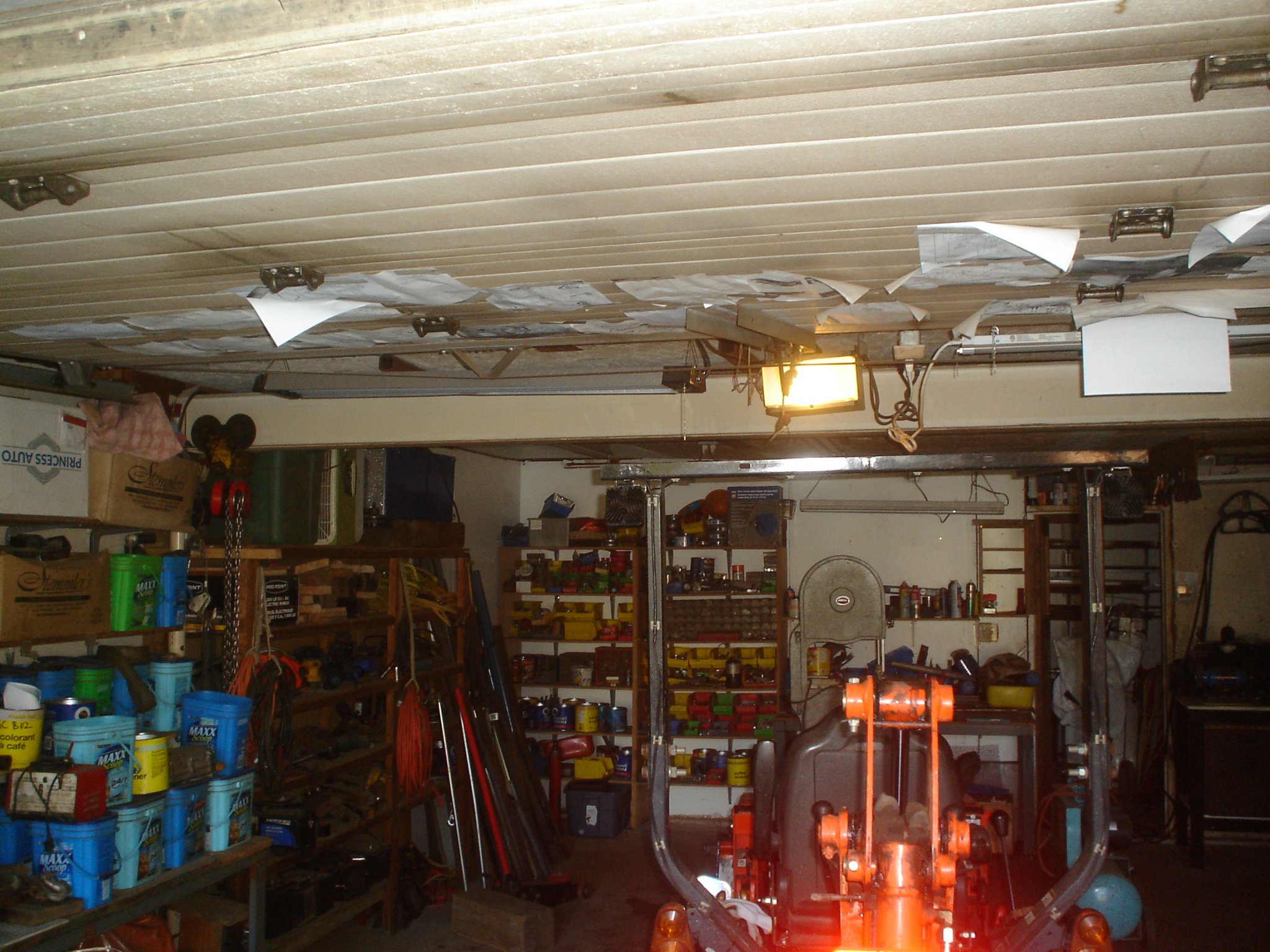

I KNOW for a FACT you do NOT need a post ! I'll post pictures once I figure out WHERE I left the camera , this time.... I know it's a 4by8 Ibeam, 23 1/2' long, sits on 2 of those 'basement jack posts', on the floor slab( 4" thick). Never had any issues, even splitting the D-14 (full size 40HP tractor).
In your case ,you just add 2by4 studs where the I beam will go. 4 studs is 6" 'wide', more than enough to support it.
By installing on top of the top plate, YOU gain the 8" I lost ,adding it after the fact( I didn't have a choice...). If you go to install a ceiling , you simply go 'up and over' the beam.Primer white painted partical board is what I used(cheap back then) , today, I'd use white 'tin' sheets. cleaner and brighter. I'm also replacing all the old Fl lights with LEDs ,when on sale at Princess Auto.
attached some pix. it is a 4by8 I beam, 25#/foot (?)
