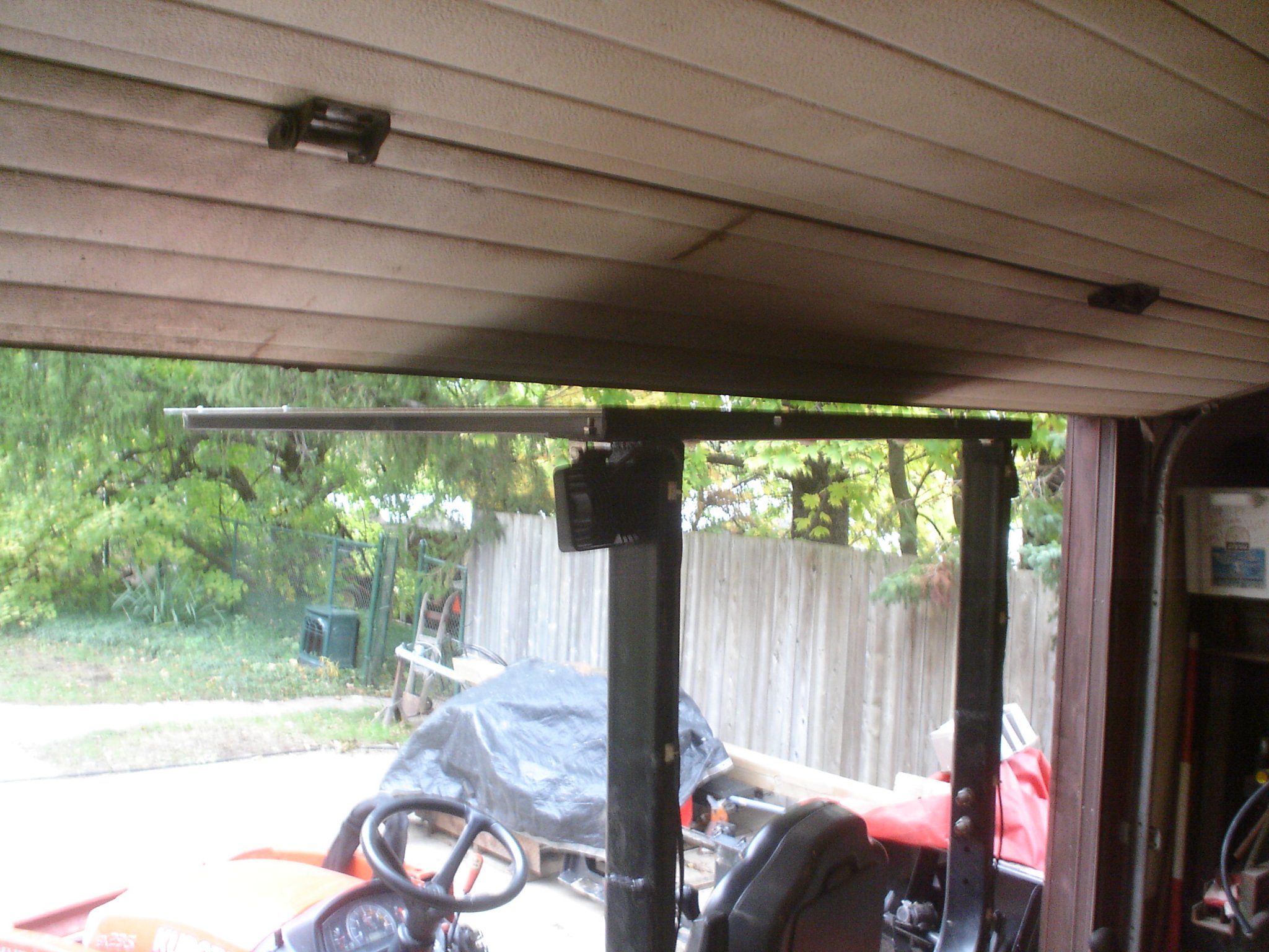

here's my custom sunroof on the BX23S.. standard 7' garage door.
A 10' wall, should allow for a 9' high door as header will be less than 1' tall( 3x 2by10s or 2by12).
Drawing things out on 1/4" square paper can help, easy to make changes and have cutouts of 'things' to move around.

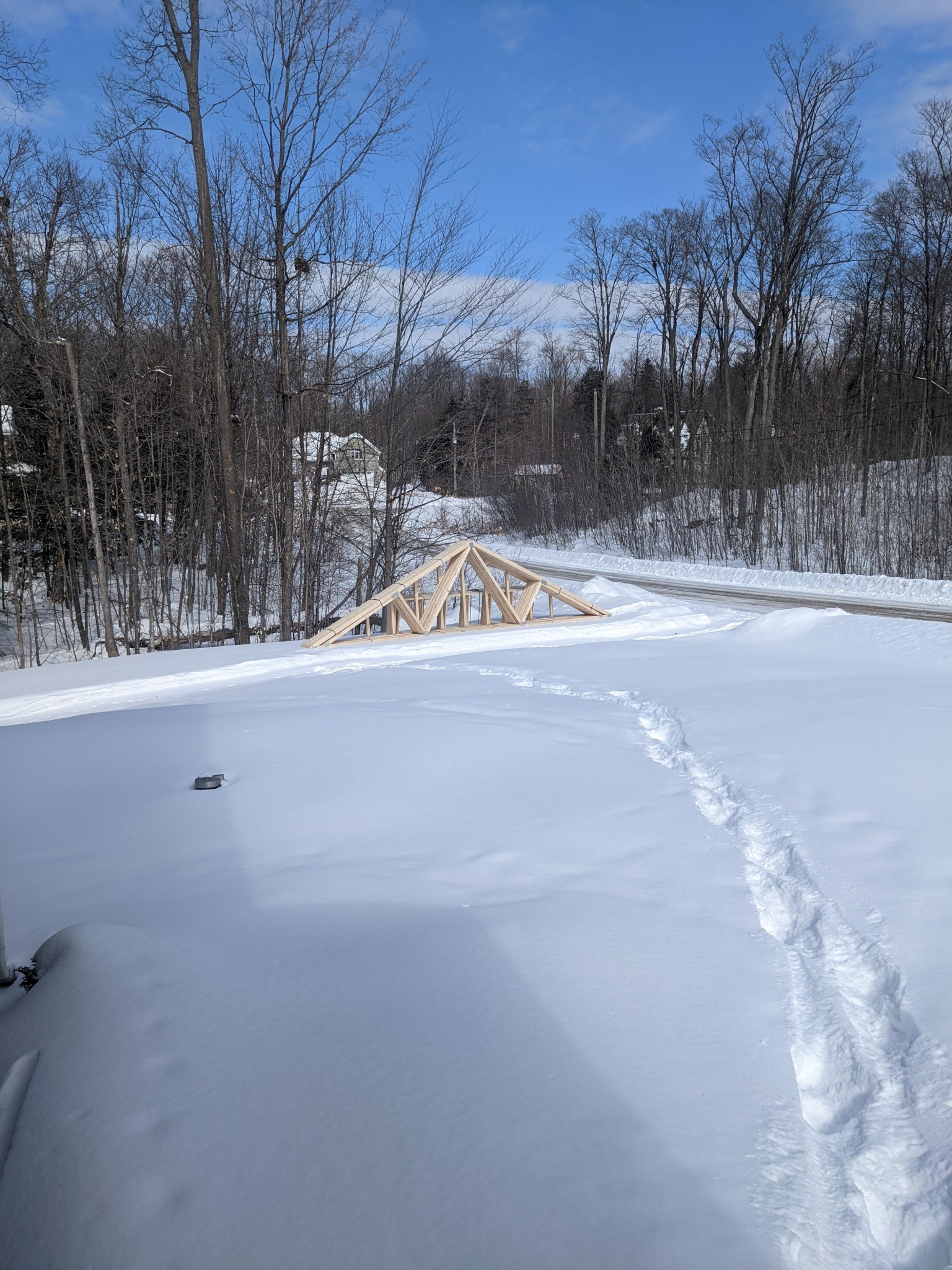

Trusses are in. We just need the warm weather now

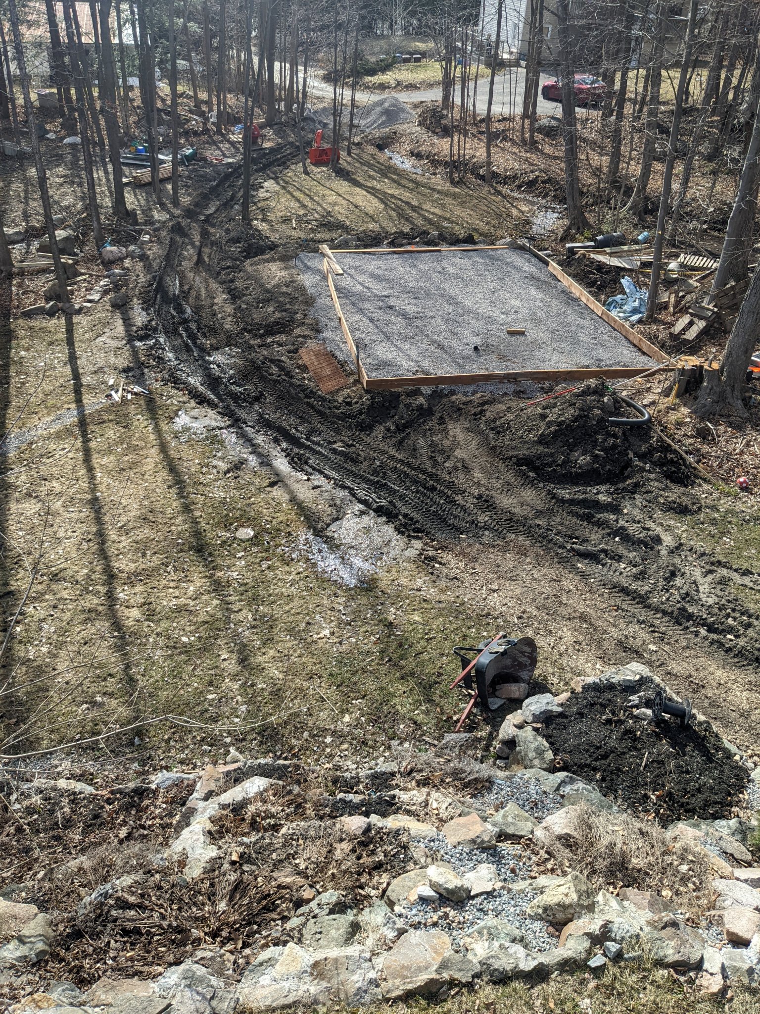

I'm slowly getting there. I hope I can pour next week. I juat went to buy the 2x10x12 for the forms. The local hardware store didn't have any but they had PTW. The PTW were 41$ vs 52 for regular. ?!?! Ok, so I got the PTW. Might be useful for another project some day.
I failed to get a picture that includes the tractor, but the snowblower is in, so that counts :)
As you can see from, I couldn't wait for the ground to dry before I start working on this. There's just no way I would spend another month inside doing nothing. I have to get out. Mud or no mud.
