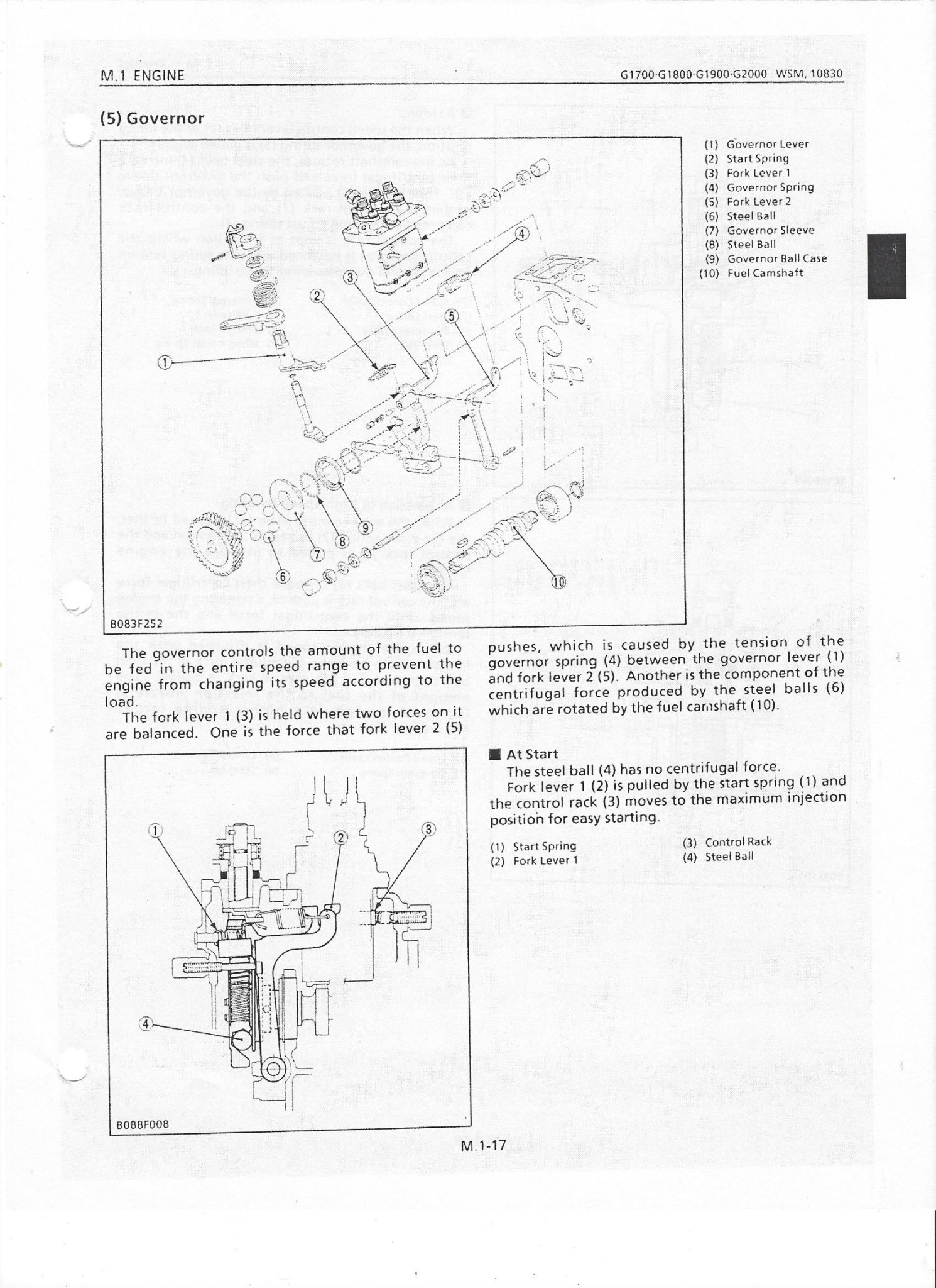

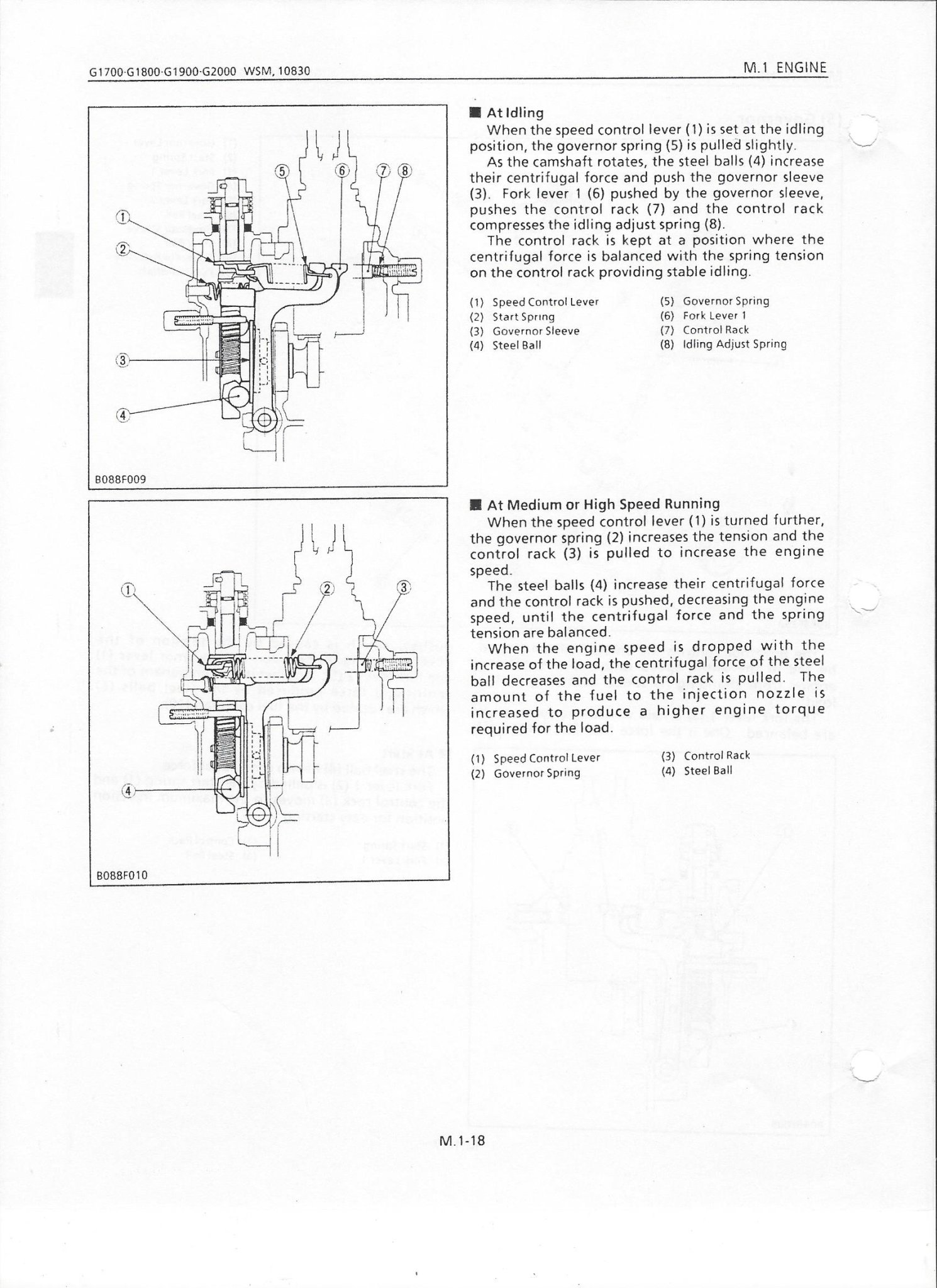

I splurged and bought the WSM on eBay. It was $46, shipped. Do not despair. Diesels are simple: air, fuel, no spark to worry about. There are electrical issues that can go bad - these allow you to actually shut the engine down. I hope you have a good battery. The cranking may run it down. Hope you have a booster pack handy...or a LONG extension cord and a charger...
Hang on, I'm scanning a couple of pages from the WSM that may be useful...

If you can find Fork Lever 1, I'd try pulling that to the Start position with your finger, crank the engine, and see what happens... Is the Start Spring intact?
-Paul

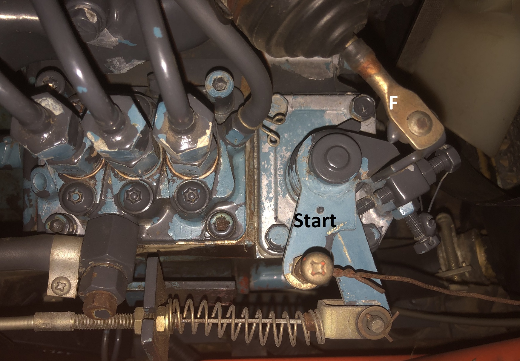

I went out and looked at my early-build G1800, and it doesn't have anything like the WSM depicts.
Here's a picture of the injector pump on my engine:
The "F" is the fuel solenoid pull-off. "Start" is the start lever. It needs to be in the position shown for the engine to start. When you turn the key to shut the engine off, the fuel solenoid pulls the Start lever back against its stop. It stays there for 4 or 5 seconds after you shut the engine off, then returns to the start position as shown in the image.
You'll notice a piece of wire attached to the start lever. This was done by the PO, and I just left it. It serves as a manual shut off if the solenoid goes bad...I guess. My solenoid looks iffy with its torn boot, but it still works...

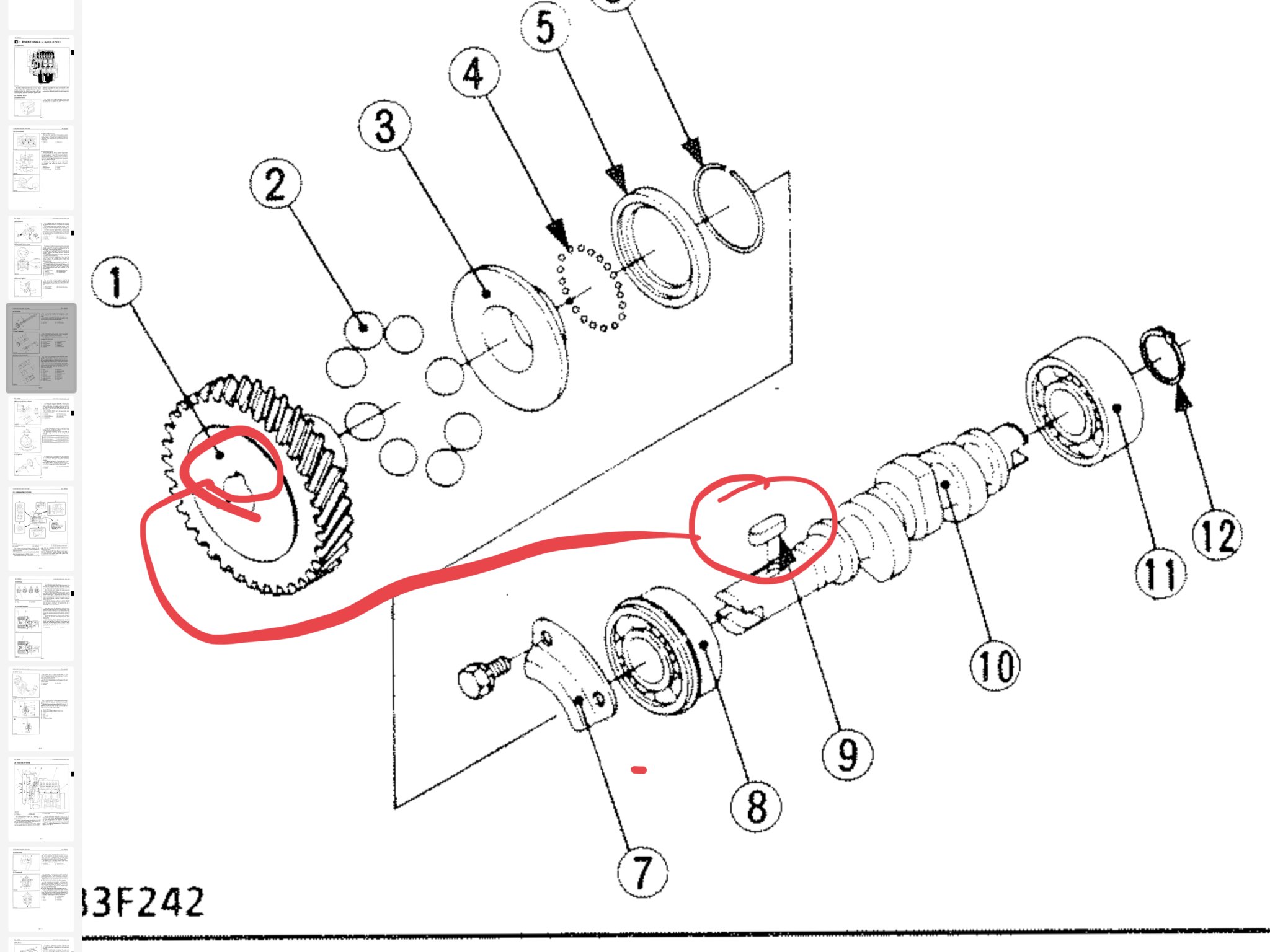

Well it’s clear the pump isnt pumping. Being cam driven, it is possible the lobes on the cam are worn beyond spec which I don’t buy or , the drive gear isn’t turning. Likely a sheared key i guess. How it sheared who knows. May be all wet but that’s the most logical path in my mind anyway. I have attached the schematic of the fuel camshaft. I welcome all feedback.
