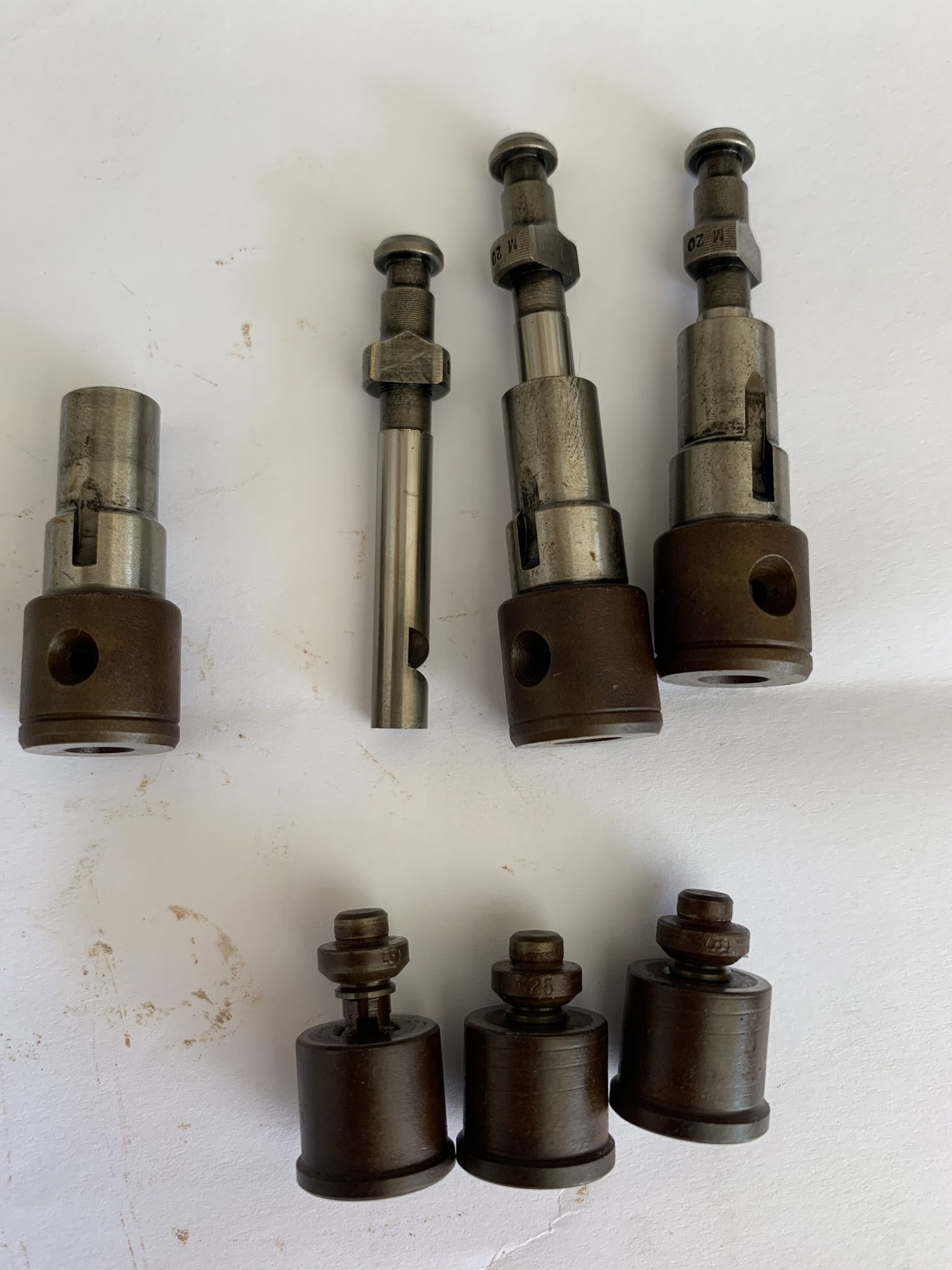

Pump will be back tomorrow. Shop is sending back the old parts to show the condition and the effects of scour. Bench tested for pressure and all good. I will post pics of the bad plungers.

Pump back this morning. Below are the old parts that have been replaced. The delivery valve on bottom right is literally stuck. As you can see it was pretty much in need of a redo. Gonna bolt her back on this evening I hope. 2178B1E4-D628-43FD-84FC-0D213D3D70BF.jpeg

I ended up at the pump because everything else I chased led back to the pump. Fuel pump worked. Fuel to the bleed screw. Fuel solenoid works . pulled high pressure lines off of pump and got a very weak flow of fuel when cranking. Literally no fuel to the injectors. Considering all of the above the only thing left was the pump. As you can see on the photo I posted the amount of scour on the plungers and the frozen up delivery valve show how bad the pump was . All from dirty fuel and setting for 2-3 years before I got it.

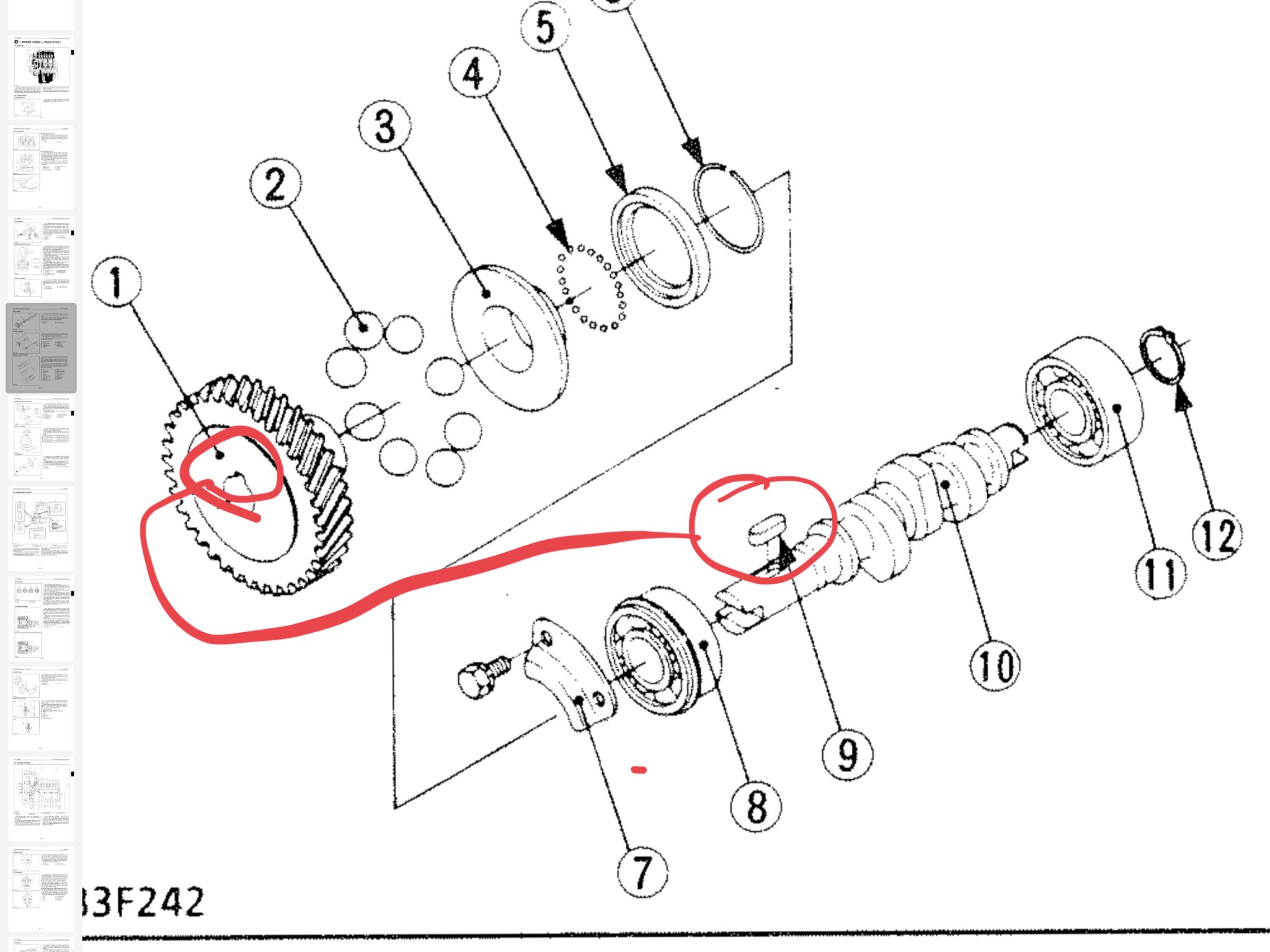

Well it’s clear the pump isnt pumping. Being cam driven, it is possible the lobes on the cam are worn beyond spec which I don’t buy or , the drive gear isn’t turning. Likely a sheared key i guess. How it sheared who knows. May be all wet but that’s the most logical path in my mind anyway. I have attached the schematic of the fuel camshaft. I welcome all feedback. View attachment 88796
