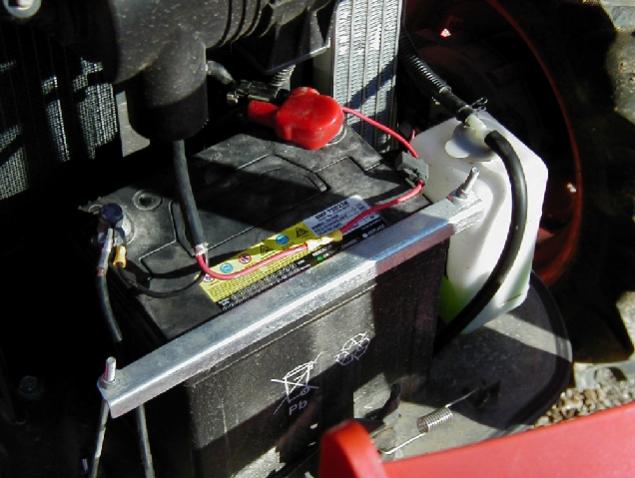

Power it with the tractor battery as you fill up. I already had a 12v pump so instead of buying a 110v pump I just put alligator clips on the 12v and do it that way. The tractor will be there so why not.

Way simpler, small lawn mower battery and either a maintainer charger or a solar charger, that way it works if the power goes out too! ;)
That's what I do. I just use a spare car battery and leave it sitting on my transfer tank. When empty load it up on the back of the truck with the forks.

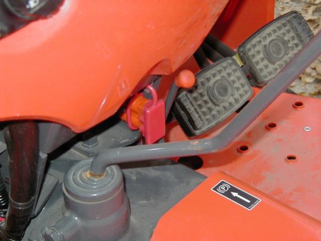

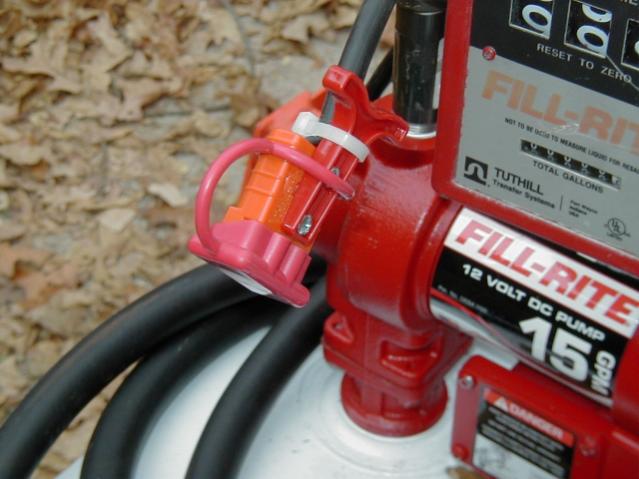

I also use Anderson connectors on the truck and tractor. My fuel platform is a transfer tank in my truck, so 120v or a dedicated battery doesn't make sense. I keep the elec cable locked up in the tool box, then plug it in to the under hood connector or the tractor depending on how i am positioned.
