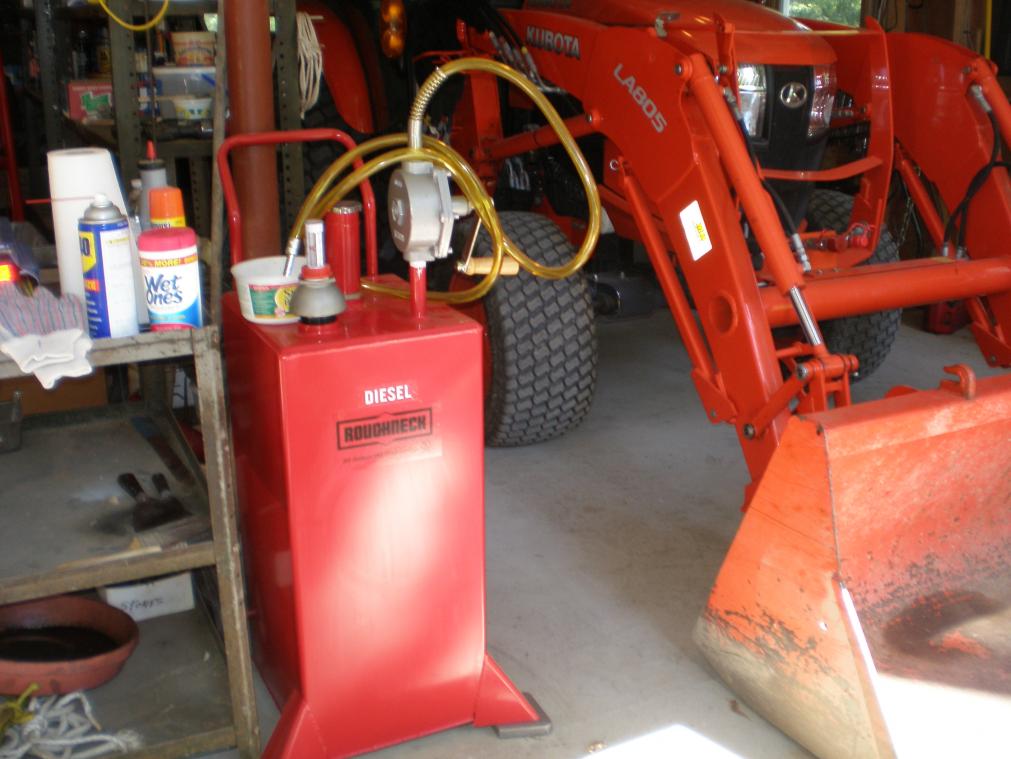

We have 2 of those roughneck cans at work. The pump they come with doesn't last forever. We replaced the pumps with some push-pull style pumps from TSC, which pump about 20x faster and don't wear you out NEARLY as fast as the rotary style. And they're almost 6 years old-used daily, sometimes 15 times a day with the gasoline can this time of year (youth quads and bikes). The bigger tractors, we just drive them to the station-a couple blocks away to fill 'em up but they have 20+ gallon tanks and the cans at the shop only hold 30, and we don't fill them all the way up (usually stop at 25 gal +/-) to allow for expansion and avoid spillage when going to/from the station.
No spill? You mean always spill? I hate them.

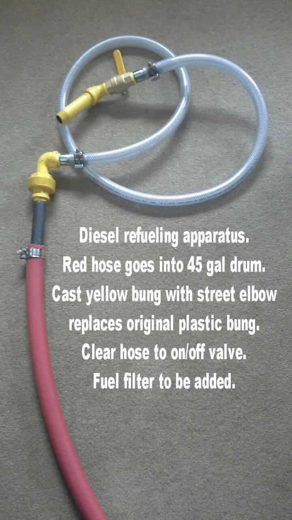

Here are pics of what I use. I found a white 30 gallon drum (so I can monitor the fuel level and fabricated the rest from things just around the shop. The bungs are the same as the 45 gallon drum. I load this on the Carry-all behind the B7100 and drive to the local gas stop about 1/4 mile away. Had to add a strobe light to the ROB as local gendarmes could not see the orange flashers, and gave me a warning.
I just pressurise the tank to 5 or 6 lbs , place the fitting into the tank, open the valve and voila! Have to give it a shot of air now and then to keep up the flow, no spill or mess to clean up. As an added bonus, I also use this setup to fill my home furnace oil tank in winter, 30 gallons at a time, and save 35 cents per litre from the fuel delivery price. Makes a difference when you are on a fixed income!

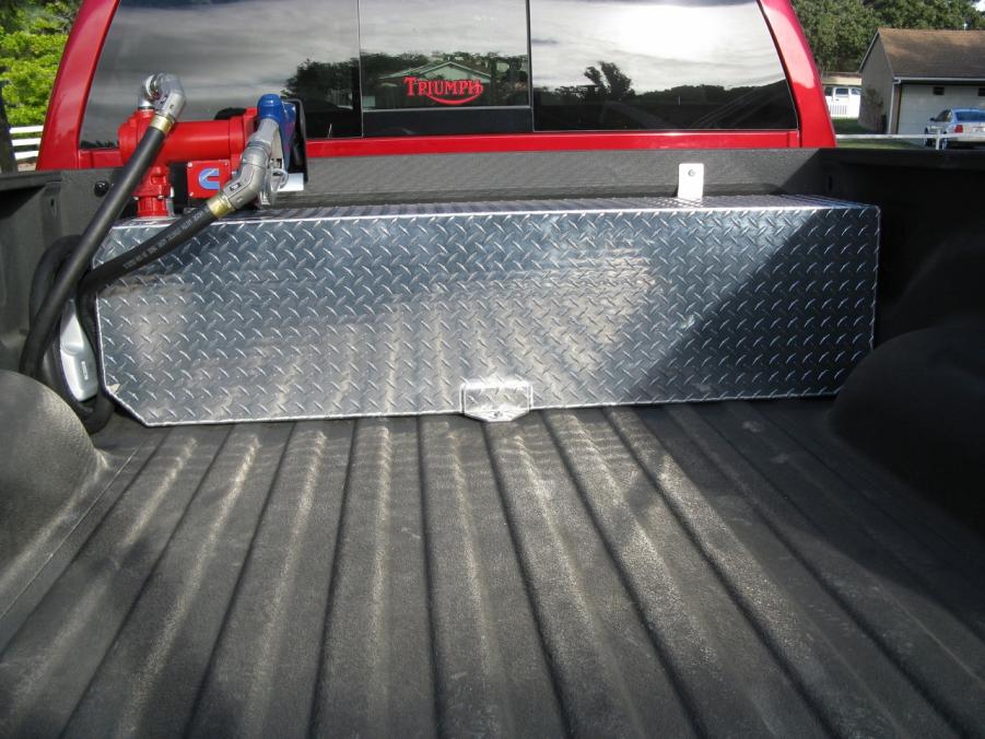

I have a 2007, 5.9 Cummins diesel powered Dodge truck. I had a guy in Texas make a custom 40 gallon tank for me for traveling with my 5th wheel. I have a 15 GPM Fill Rite pump wired in to the trucks 12 volt system. I don't have the tank tied into my trucks fuel system as it can cause transfer problems. Sure is nice to pull my B3200 up next to the truck and fuel it in a matter of minutes. The tank is also easily removed, empty or close to empty. I put a quick electrical disconnect on the power cord to the pump and if you look at the tabs on the tank, I have only three allen screws to remove the tank. I put nut plates on the other side so no crawling under the truck to hold a nut. It gives me about 75 gallons total which gives me the advantage of avoiding high price towns.

Very cool set up.
