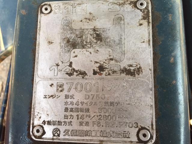

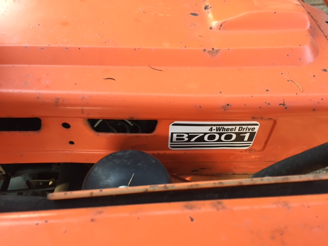

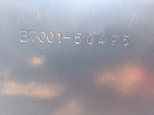

I'm pretty sure it is a B7001 based on the serial number and sticker on engine cowl. I have attached pictures so that you can see what I am talking about. Thanks for your help and yes I was in the Marines and it was an honor and pleasure serving this great country of ours.

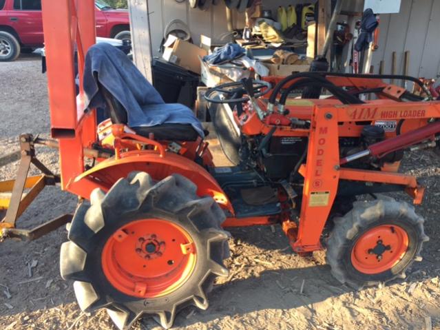

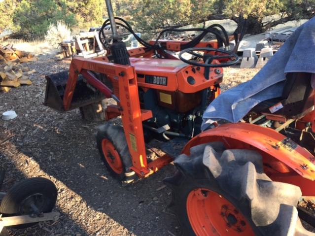

From the pictures I took, I still think it might be a grey B7001, but will defer to your expertise. Attached are five pictures of my little project.
