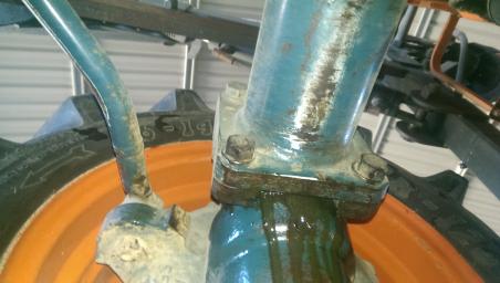

Yesterday I parked my Kubota Sunshine L1-22DT tractor in the shed after a day's work and noticed a lot of gear oil leaking from the front offside axle, where it meets the wheel hub (see pic). So much so that it was pooling on the floor. I placed a rag and bucket under it.
My tractor has the dip stick on the nearside of the axle for checking the oil level. What I do not understand is that when I checked it today there was no more leaking. So I figured all of the oil had drained from the axle. So why when I check the dipstick on the axle does it read ok, with the level between the lines? I see there are draining nuts at the bottom on both sides but I thought the fill point for the entire front axle was through the dipstick?
So what am I missing here? I figure that maybe the oil is still in the lower area below the leaking seal, but why then does the dipstick still read ok?

From what I can tell by your picture it's leaking between the bolted together housing's. There's a o-ring between those two mating surfaces,check the tightness of those 4 bolts.If there tight then you'll have to replace the o-ring.

Sounds more like it' lost as little fluid, and it was overfull beforehand, possibly why it blew out that seal.
Drain it, split it, replace the seal or O-Ring, and fill to proper level, and check vent. ;)

Thanks Dusty. You explained it well mate and I think I have a good idea now of what to do. Where the two housings meet there are 5 bolts, rather than the 4 you would expect. With 3 being at the top. So I'm assuming the top middle will be the filler. I will let you know how I go. For me parts can be an issue down under as mine is an old grey and genuine Kubota dealers treat us like the plague.

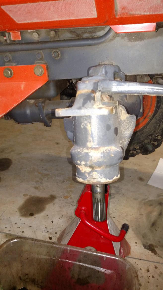

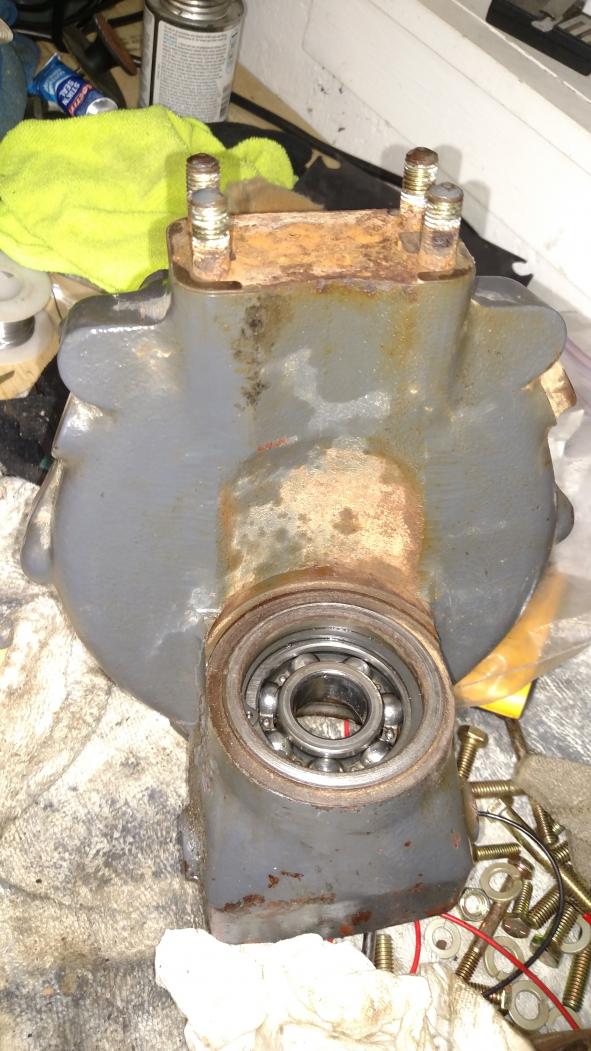

You were spot on mate. I've taken the housings apart and the o-ring has perished. Crickey it's not easy getting those housings to separate, even after I removed all 5 bolts.

It's all good Wolfman. I had a go at it today and took the o ring to a hydraulic/seal place and they matched it up with no probs. Dusty was right. It was a pretty simple job once you think it through. The only problem I had was separating the two housings. After I removed the 5 bolts I could not split them. It took me an hr or so just to get them apart.
