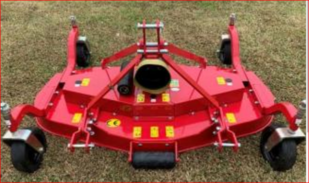

Your rotary cutter - it have only ONE wheel on the rear of the cutter? Or is it supported with wheels around the perimeter of the mower?
