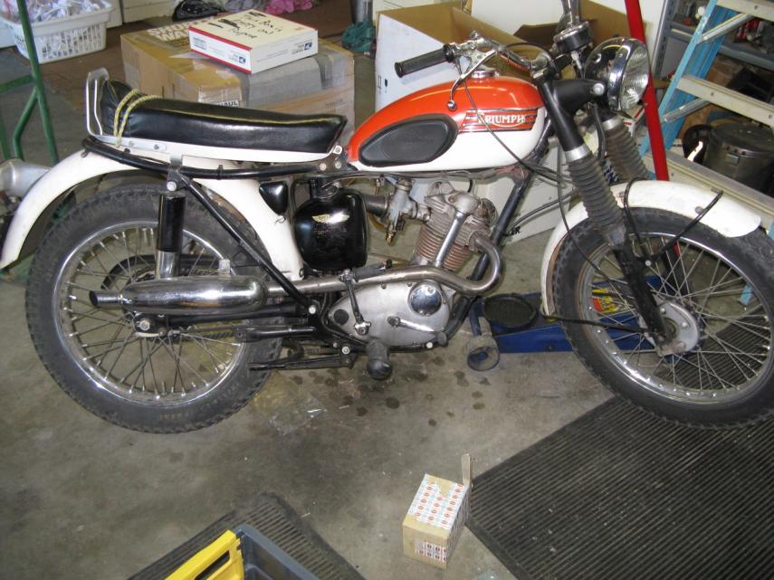

As said before, you are doing a very nice refurbish on that tractor. it is the kind of refurb that you go through everything, make sure it is all in good order, rebuild as necessary, re-paint and then USE IT. I am currently refurbishing my 1967 Triumph 200cc Tiger Cub motorcycle. Doing what you are doing job wise, repaint, rebuild the engine, powder coating the frame and doing some non stock modifications to make it more reliable. As long as you saw OIL leaking on the driveway, you knew it still has oil in it!

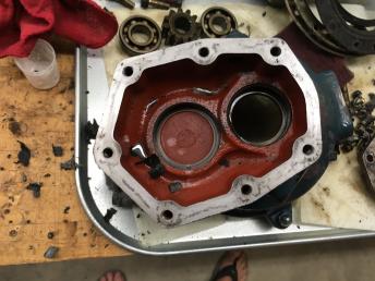

The bottom pin does a spiral groove for lubricants to get in around the pin. I just dont see how grease would get into the groove and work its way down. That area is sealed with oil seals from the differential and the reduction gear box. So only grease goes in there I assume.

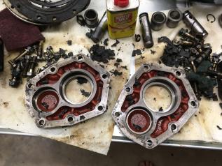

I think the hardest part of this project has been scraping 40 year old gaskets. I tried a couple different products. I ran out of that permatex foaming stuff which worked ok but have to wait forever for it to soak in. Tonight I found a can of Goof Off in the cabinet and thought I would give it a try. So far this is working the best along with having a therapist on speaker phone.

I have found that most of my gaskets have peeled right off. The only exception was the bell housing but I just dropped that off to be acid dipped and powder coated. Also the media blaster has taking care of any remaining residue on the smaller parts.

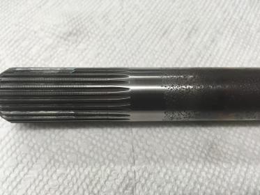

After taking the front axle apart I found that the axel shafts had wear and corrosion at the seal mating surface causing them to leak. Easy repair but time consuming. After taking some measurements and cleaning the surface I tig welded a bead around the shaft to fill the wear and corrosion. After letting it cool competely I then put the shaft in that lathe and turned down the weld to and polish to final dimension.

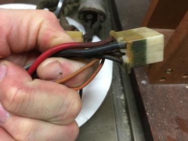

Going to tackle my wiring now. I was going to just replace the whole harness but it really is not needed. The main problem is the plastic plug is brittle and cracking. If I can find just the plastic plug I can pull the pins from the old one and push them into a new one. Anyone know if just the plastic part is available?

Yes, the plastic shell is available. Check the above vendors and look for a visual match.

I looked back at some of my old post and saw you gave me that info. I forgot about it. Thanks for the kind reply. Getting close to wrapping it up, I hope.

I looked through the sources mentioned and didnt find a plug that matched. I spent some time looking on the web and came across a company called Aoton in China that has a plug that looks to be identical. I sent an email to them the other night and have not heard back. There has to be some place in the states that has this plug.

Did you try Allied electronics?

How many pins in the plug being used?
I'd just get a servo plug set with enough pins and screw connectors and do it that way.
